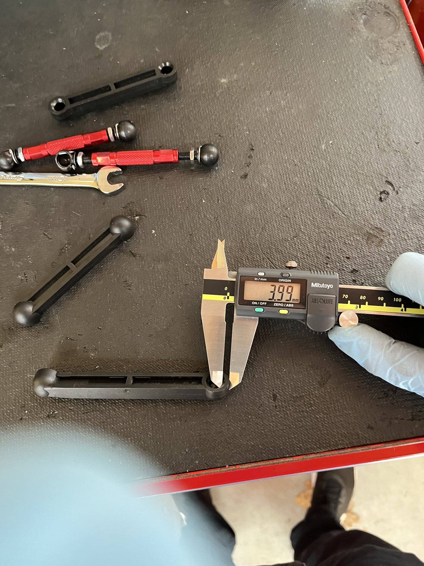

I recently picked up a Cross Turismo and I’m curious to learn if it would be difficult to use sedan suspension parts to get the ride height and geometry of the sedan but in the CT body.
So far I’ve measured the lowering links and they are different between the two cars, which accounts for the height increase of the car. This leads me to a hypothesis that normal/lowered/low software in both cars is the same. If software is the same, a simple hardware swap might bring the CT to sedan spec. Again, a hypothesis, please humor me here.
So, I’ve discovered the sedan front strut part numbers and the CT front (via my car), but I can’t find rear info for the sedan, and it’s hard to see where labels are on my car.
The question: if anyone has part catalog access, can you pull up a few part numbers for me please?
- rear shocks, L&R, sedan & CT
- rear air springs, L&R, sedan & CT
- lowering links, front & rear, L&R, sedan
For what it’s worth..
Front R shock PN, CT: 9J0.616.038.A
Front L shock PN, CT: 9J0.616.037.A
Front L shock PN, sedan: 9J1.616.037.C
Link length:
Sedan links: 88F / 95R (mm)
CT links: 82F / 102R (mm)
Thanks in advance!

You’ll get the ride height using sedan links instead of aftermarket, yep!
The problem is that you’ll be running into the bump stops constantly. I’m running into mine all the time around the Bay Area roads. Having more suspension travel when in the low modes by using sedan parts would solve this :)
sedan links would put you 5-10mm lower than this:

Interesting! I measured mine myself, and Dee measured his sedan parts, and the change in length between CT and sedan correlates with the expected ride height change.
Based on a YouTube video, the sedan and CT molds appear different as well. Perhaps the parts catalog can’t be relied on :(
