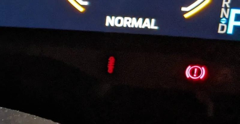

Hi guys
So I'm wondering if I'm the only one that might see this or if it's normal.
I have been driving my Taycan 4S for a few weeks now and during the day I kind of see the red suspension light on the cluster looked like it was kind of lit up, now it's not close to the brightness of the parking brake light etc.
Finally drove it over night and it for sure looked lit up but I'm not sure if it's light bleeding or not...I have no errors on my car so I'm rather confused...do you guys have this too?

I have now talked to the dealership and they said their car isn't lit up normally...and there are no faults...so am I the only one.

Well, ask them to create a fault and reset it.
If all is working ok, all faults should've been reset.

Update
Dealer says, indeed, the light is on, but no errors.
Suspected defective unit....waiting to hear on if its a fixable thing, or i need a new gauge cluster...

Update: Full cluster replacement had to be done...random faulty unit we guess.
