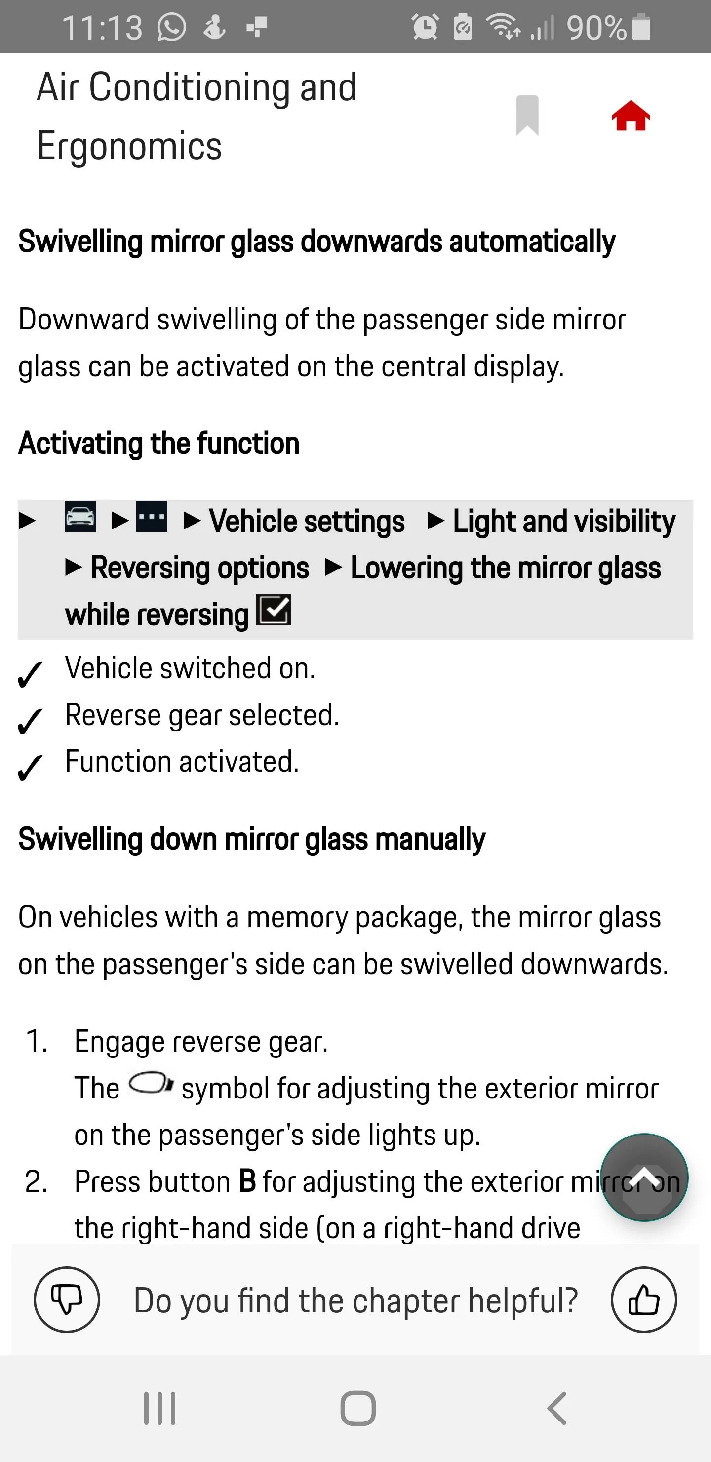

Can you set the passenger side mirror to show the curb when reversing?
Yes - first check you have the option enabled (requires memory pack option) in the PCM.
With the car powered on and in R, adjust the mirror so that you can see the kerb, select P, after a few seconds the mirror should return to its normal position, engage R and the mirror should swivel to the kerb view. Select P, power off, done.
Porsche Taycan Passenger side mirror when reversing Screenshot_20220702-111351_Porsche Good to know
