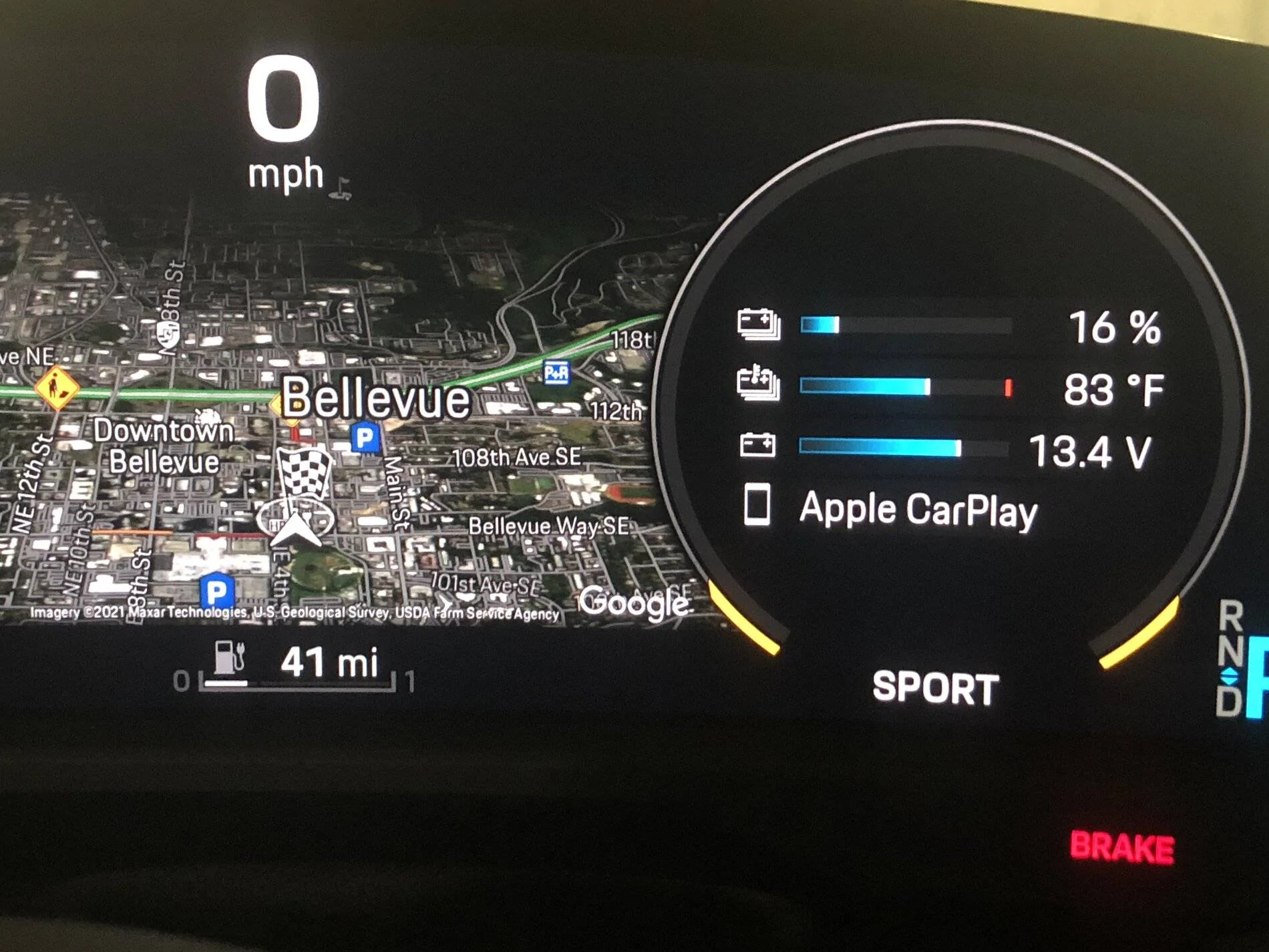

As one of the OP's neighbor, I went to his EA station today (Bellevue Safeway, EA 150kW) to try and figure out if the problem is EA, the Porsche-EA coordination, or his car. It was also my first time really doing a big DC charge since getting my car 4 weeks ago, so just thought I'd share my experience. Destination was set via Nav for battery pre-warming. Here was the car status just prior to charging.

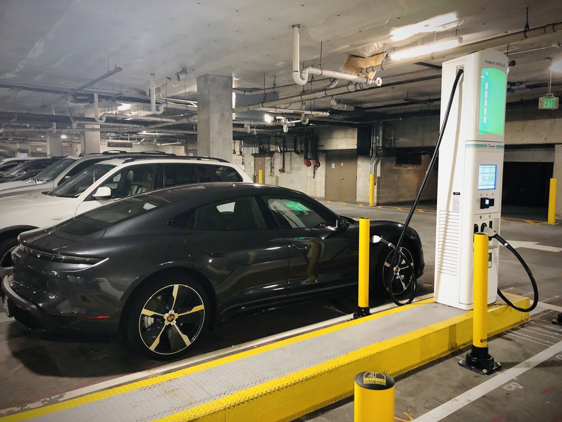

The biggest hurdle was finding the right parking spot. There were 5 spots (2+2+1) but the first two fattest ones were taken by an Audi ETron and Bolt. The remaining spots were a bit tight and my proximity sensors were barking like crazy. Finally found this one spot which technically is not one of the EV parking spots that worked for charger #5.
Porsche Taycan Payment declined error at Electrify America IMG_6546

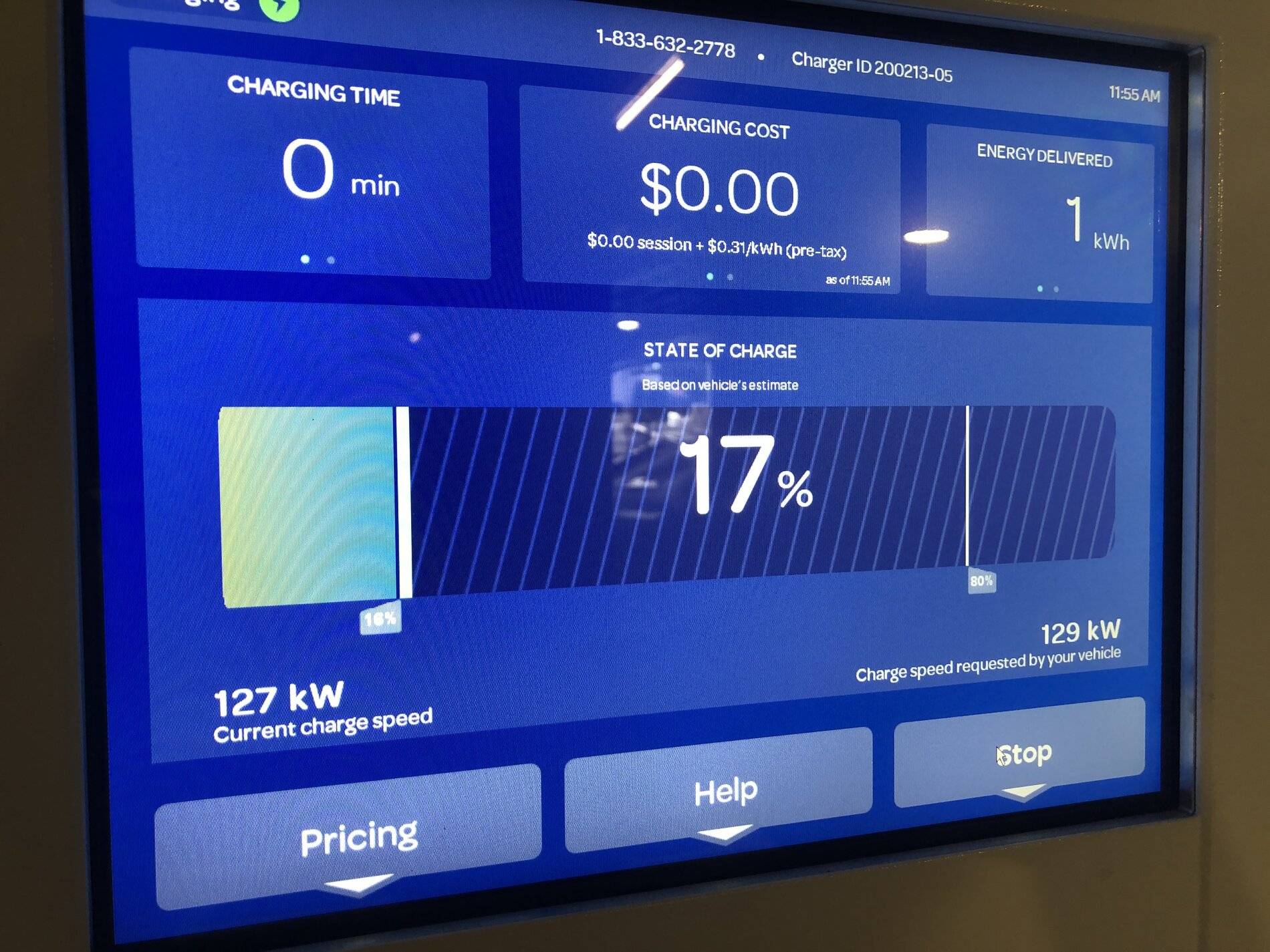

First try and it connected fine. Activated via Porsche Connect app. Probably took a total of 1 minute from physical connection to get to obvious electron flowing. Also took a picture inside the car to confirm we're getting a pretty decent rate for the 150kW charger.

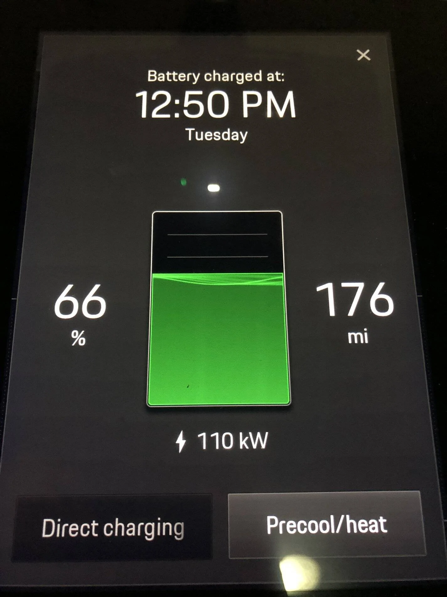

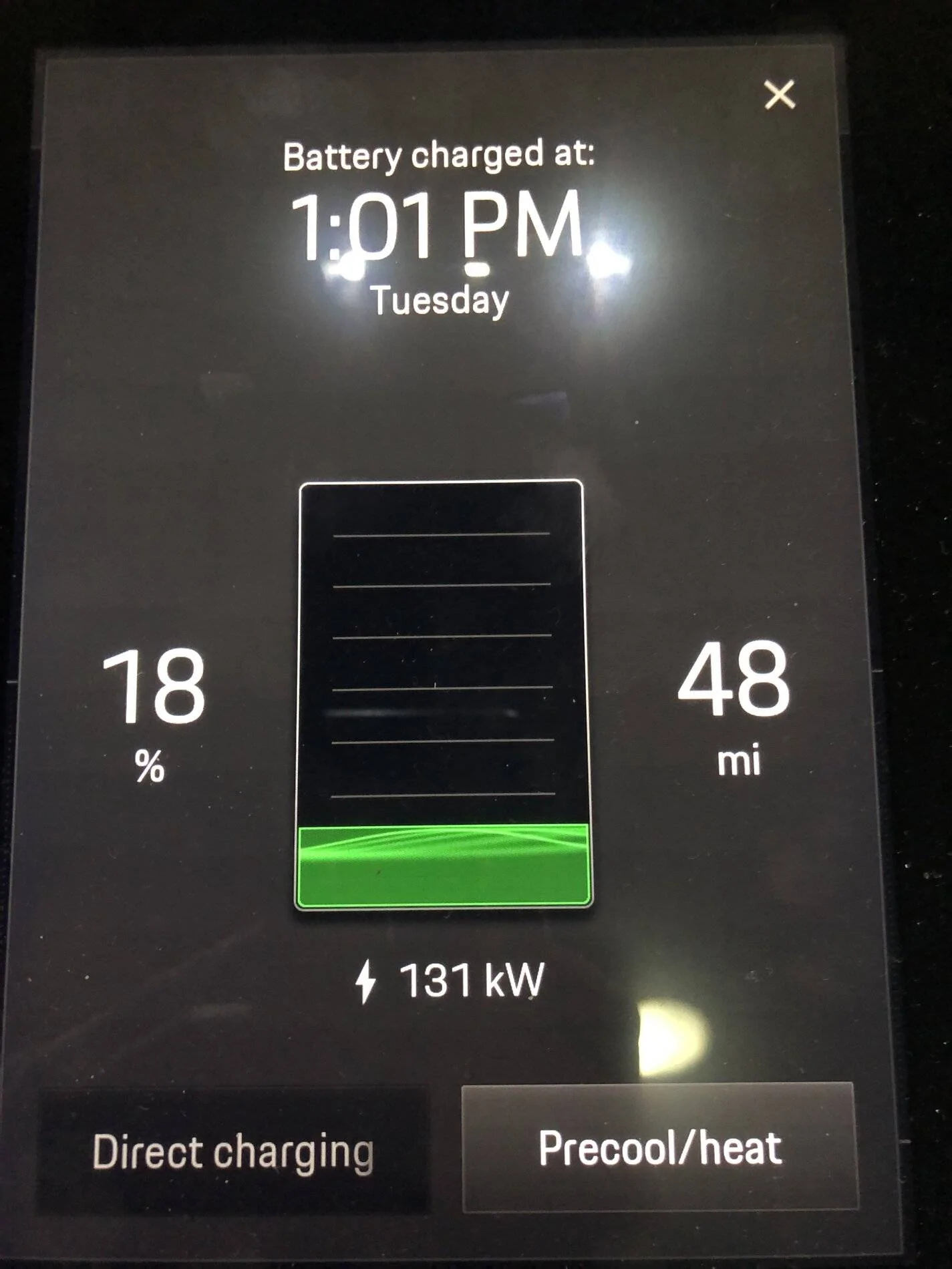

At this point I went inside the Safeway to get a few things. Approximately 8 minutes after I started charging I checked the Porsche Connect app, and instead of it showing charging it said the charging is complete at only 30'ish%. I tried to use the app to restart the charging but it wouldn't work. After I bought the groceries and went back to the car, however, it actually was still charging and didn't seem to be interrupted; the Connect app showed the correct charge % (it was up to 60%) but did not indicate it was still charging. Whatever. If I were smart I would have checked the EV America app but I forgot.
The good news is that even at 60-66% it was still drawing over 110kW. Pretty good.

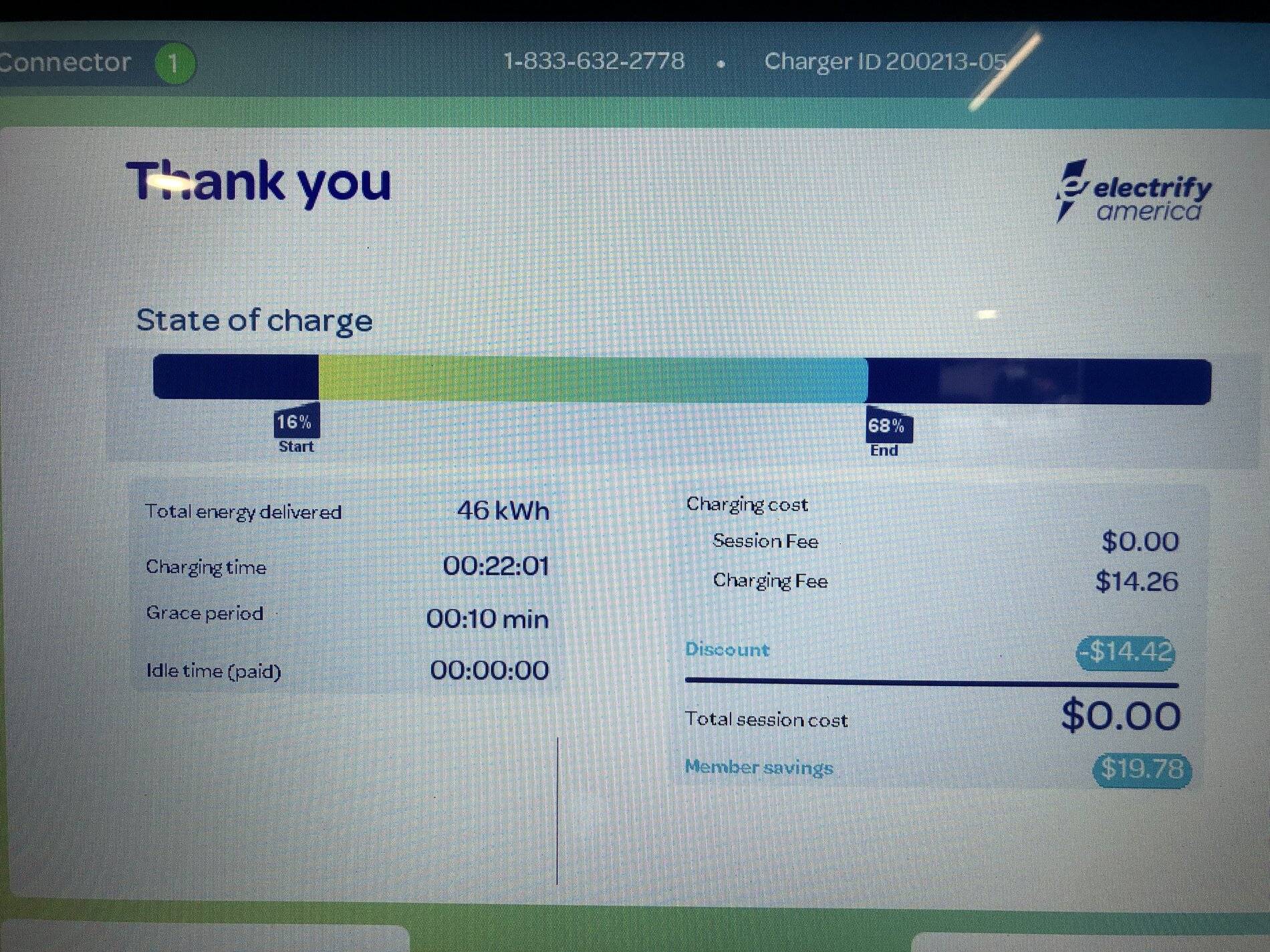

Finally stopped it at 20 minutes on my watch. I guess EV shows 22 minutes but not sure if that included the part during initial connection and the end part of wrapping up. But my first DC fast charge experience was pretty good, and shows I could take this car on a road trip if (fingers crossed) other chargers work as well.
