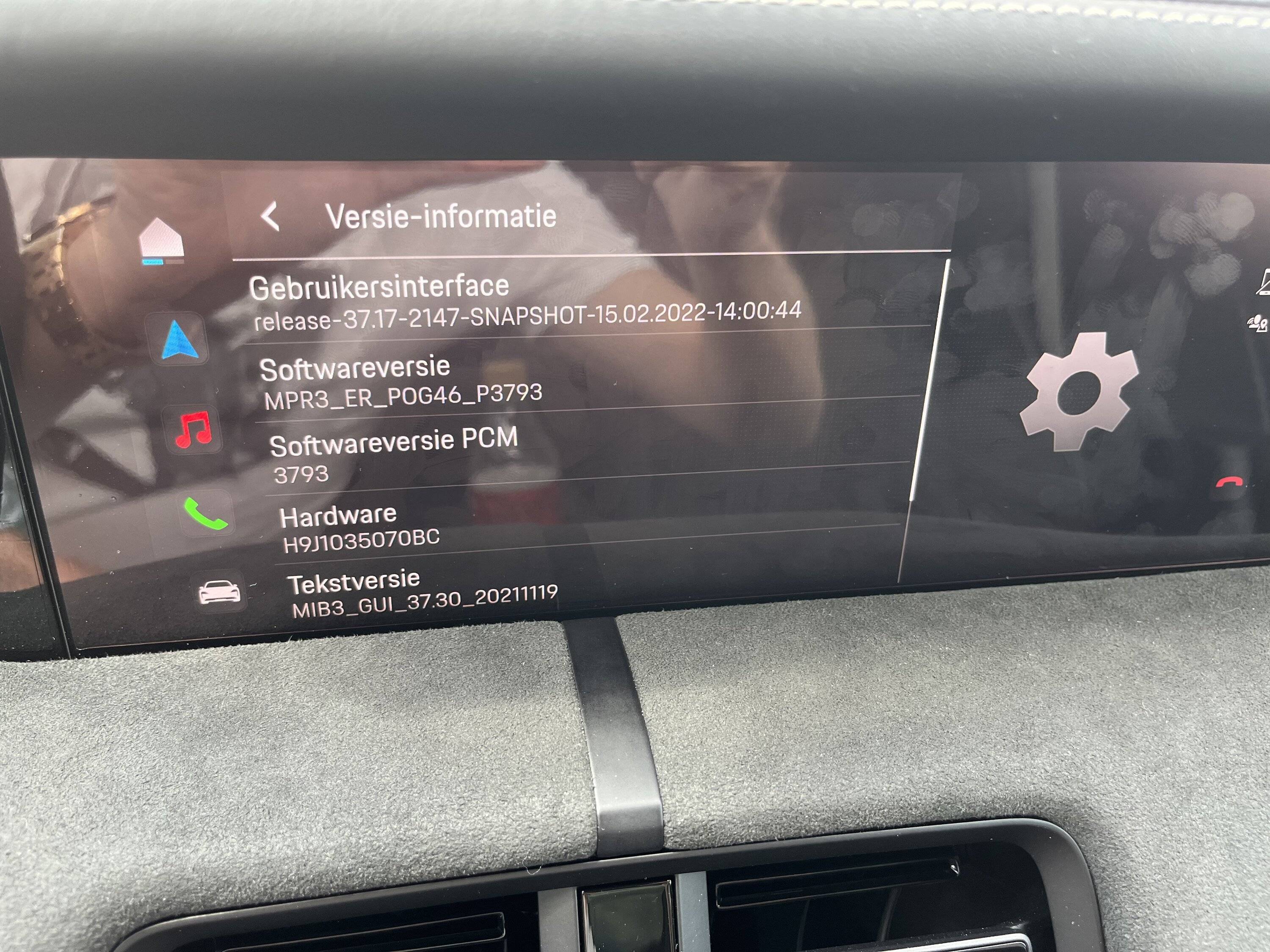

My dealer told me that the recall actions for coloured PCM (they call that internally "cluster 37") will be started from week 30.
