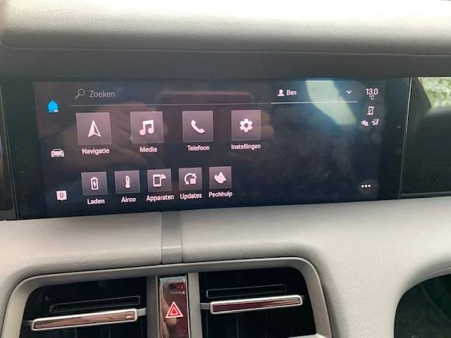

Wait until all icons (more than 9 in my case) have appeared after switching on the car, for example handleiding(manual) appears after a while.
Right after startup:
Porsche Taycan PCM Engineering mode, contains PCM reboot IMG_8604
(Sorry for the lousy pics, but didn't want to wait till tonight).

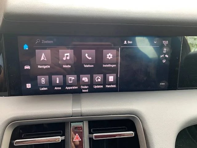

Menu is now complete:
Porsche Taycan PCM Engineering mode, contains PCM reboot IMG_8605
Go to the first home screen on the center console by clicking on the home icon until you see the house picture and the first of the two lines below it in blue.(Like in the pic above).
Look in (almost) the top right of the screen, you should see your name there and an image that looks like the letter v. The letter v is position 1.
In the top right of the screen I see the temperature, but it is possible to have the date and/or time(?) there. Below it is a phone with a line through it from lower left to upper right. This is position 2.

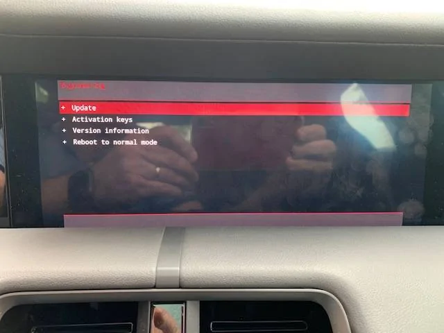

Press and hold position 1 with your pointing finger and position 2 with your middle finger. The screens should go black. Stop pressing and wait about 10 seconds for the Engineering menu to appear. If nothing happens, lift your fingers and try again close to position 1 and 2. Eventually the screen will go black and you have managed to reboot into Engineering mode.
Porsche Taycan PCM Engineering mode, contains PCM reboot IMG_8573
If your only intention was to reboot the PCM, reboot again to normal mode by pressing the last menu option.
Warning: Everything I describe next is to be used at your own risk...
Curious as I am, I clicked on the other three options too.

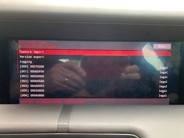

Activation keys:
Porsche Taycan PCM Engineering mode, contains PCM reboot IMG_8598
I didn't go any further with this one.

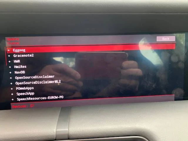

Next is version information:
Porsche Taycan PCM Engineering mode, contains PCM reboot IMG_8574

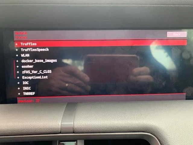

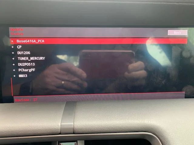

Clicking info showed a list of 27 devices:
Porsche Taycan PCM Engineering mode, contains PCM reboot IMG_8575
Porsche Taycan PCM Engineering mode, contains PCM reboot IMG_8576
Porsche Taycan PCM Engineering mode, contains PCM reboot IMG_8577
Some interesting device names for sure!

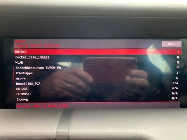

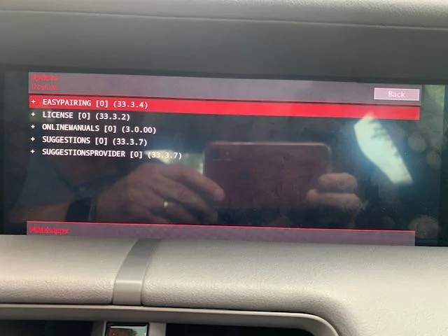

I clicked on POWebApps and got:
Porsche Taycan PCM Engineering mode, contains PCM reboot IMG_8578
I didn't explore this menu option any further.

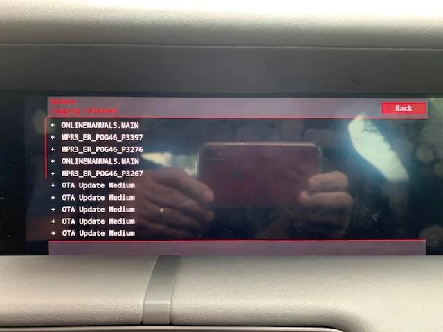

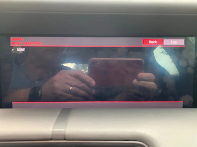

update on the main menu showed NONE. Ok, but how about that Log button in the upper right :D
Porsche Taycan PCM Engineering mode, contains PCM reboot IMG_8579
After clicking it I got a list of updates that have been applied to the Taycan :like:
Porsche Taycan PCM Engineering mode, contains PCM reboot IMG_8580
So my car got 3 MPR3_ER_POG46 updates, P3267, P3276 and P3397. Probably the WMA stuff. These are PCM updates, thanks ChrisK.
And two online manual updates and a few OTA(Nav?) updates.

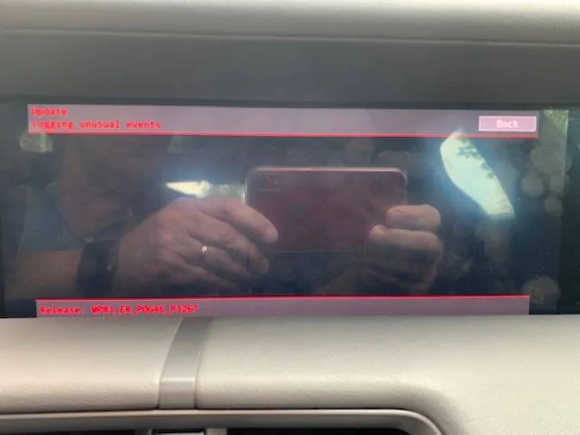

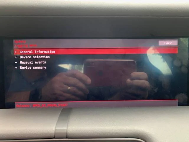

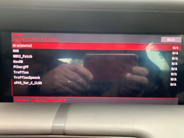

Clicking on the P3267 showed another menu:
Porsche Taycan PCM Engineering mode, contains PCM reboot IMG_8581

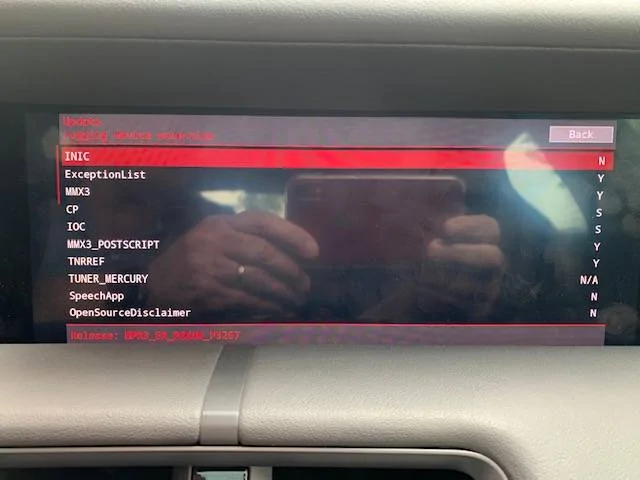

And clicking each option showed:
Porsche Taycan PCM Engineering mode, contains PCM reboot IMG_8582
Porsche Taycan PCM Engineering mode, contains PCM reboot IMG_8583
Porsche Taycan PCM Engineering mode, contains PCM reboot IMG_8584
Porsche Taycan PCM Engineering mode, contains PCM reboot IMG_8585
Porsche Taycan PCM Engineering mode, contains PCM reboot IMG_8586
Porsche Taycan PCM Engineering mode, contains PCM reboot IMG_8587

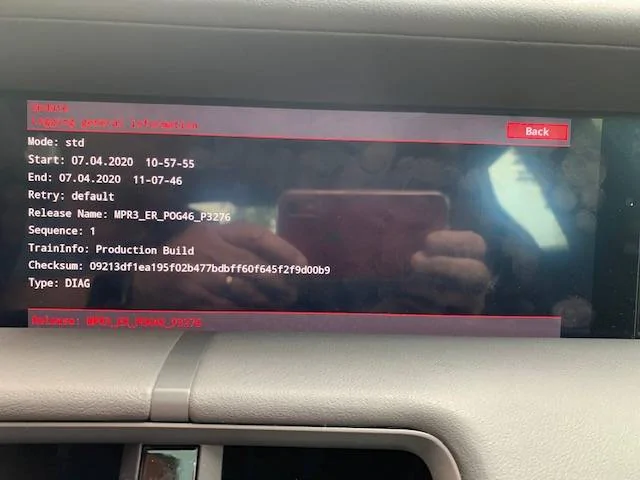

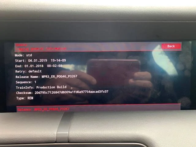

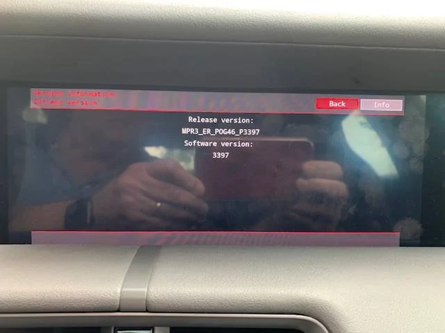

The general information for the P3276 update:
Porsche Taycan PCM Engineering mode, contains PCM reboot IMG_8588

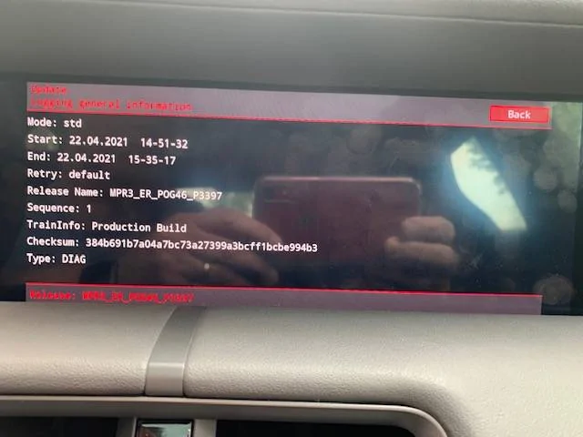

and the P3397 update:
Porsche Taycan PCM Engineering mode, contains PCM reboot IMG_8591

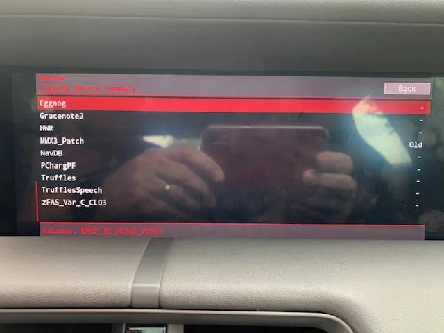

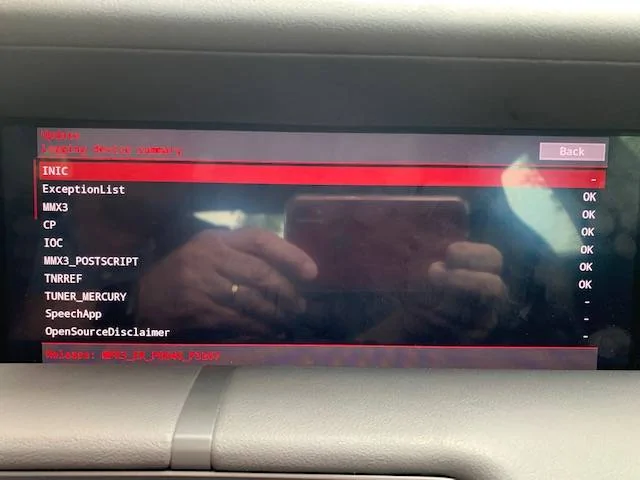

The P3397 had "Old" for the MMX3_Patch on device summary:
Porsche Taycan PCM Engineering mode, contains PCM reboot IMG_8597
There are some interesting module names in there, which might reveal which operating system and software is used in our car. I will dive deeper into this in another post.

It's Linux with the apps running in containers. Not sure if it's Docker or some other container orchestration.
It is Docker, I am waiting for an opportunity to see were the hard disk is located. Hopefully I will then be able to pull it out of my Taycan and make a bit image copy and mount the copy to my linux laptop :cool:

I'm certain by "hard disk" you meant embedded SSD, but given all the other shortcomings we have seen from Porsche here, I really wouldn't be that surprised to find a spinner in there. I think the PCM control board sits below the center console control screen but I don't know this for certain. If indeed it's an embedded eMMC, copying it would be tough. If it's a 2.5" SFF SSD then it's a piece of cake (if you can actually get to it).
