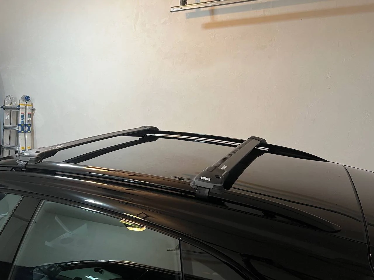

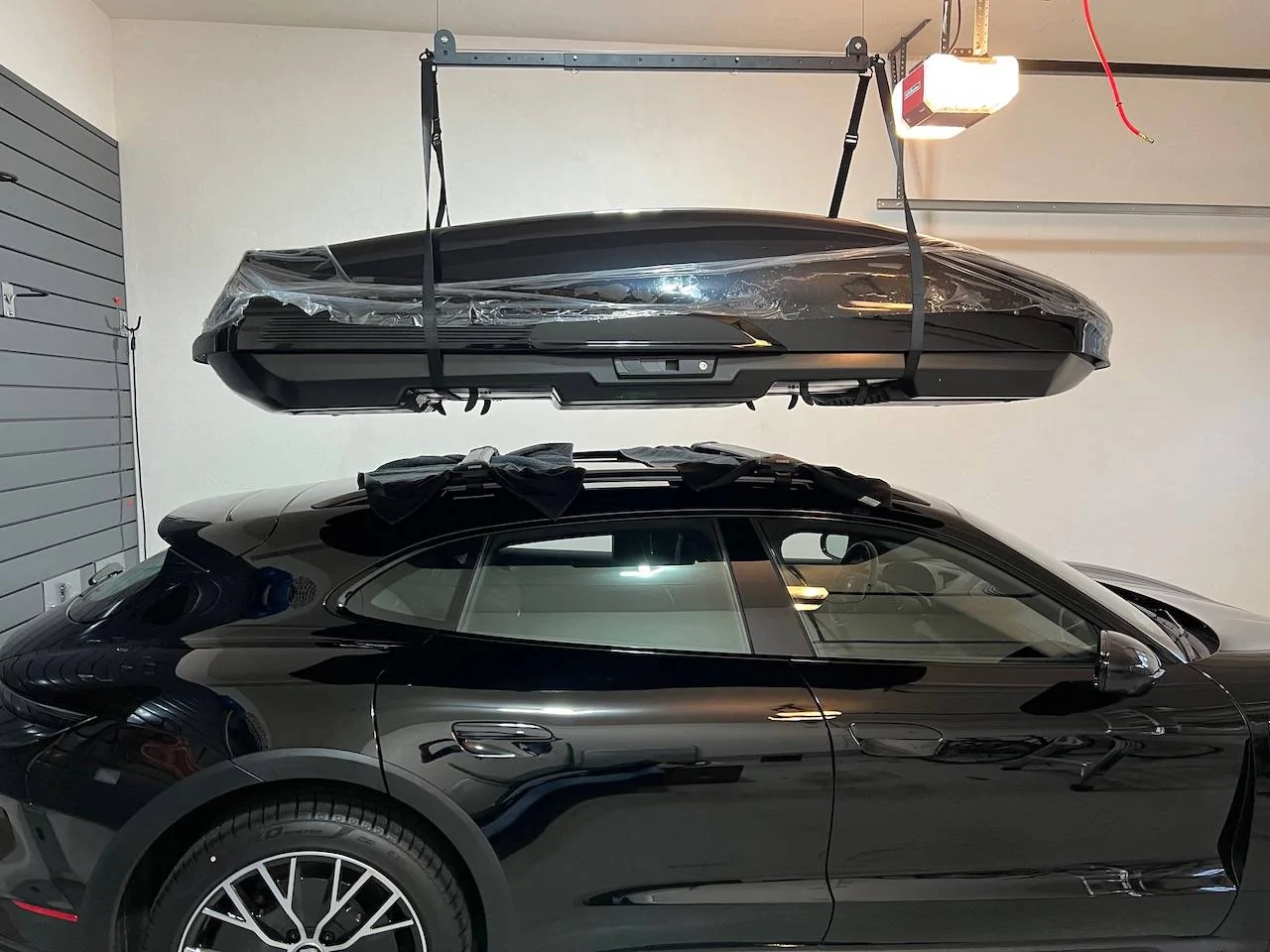

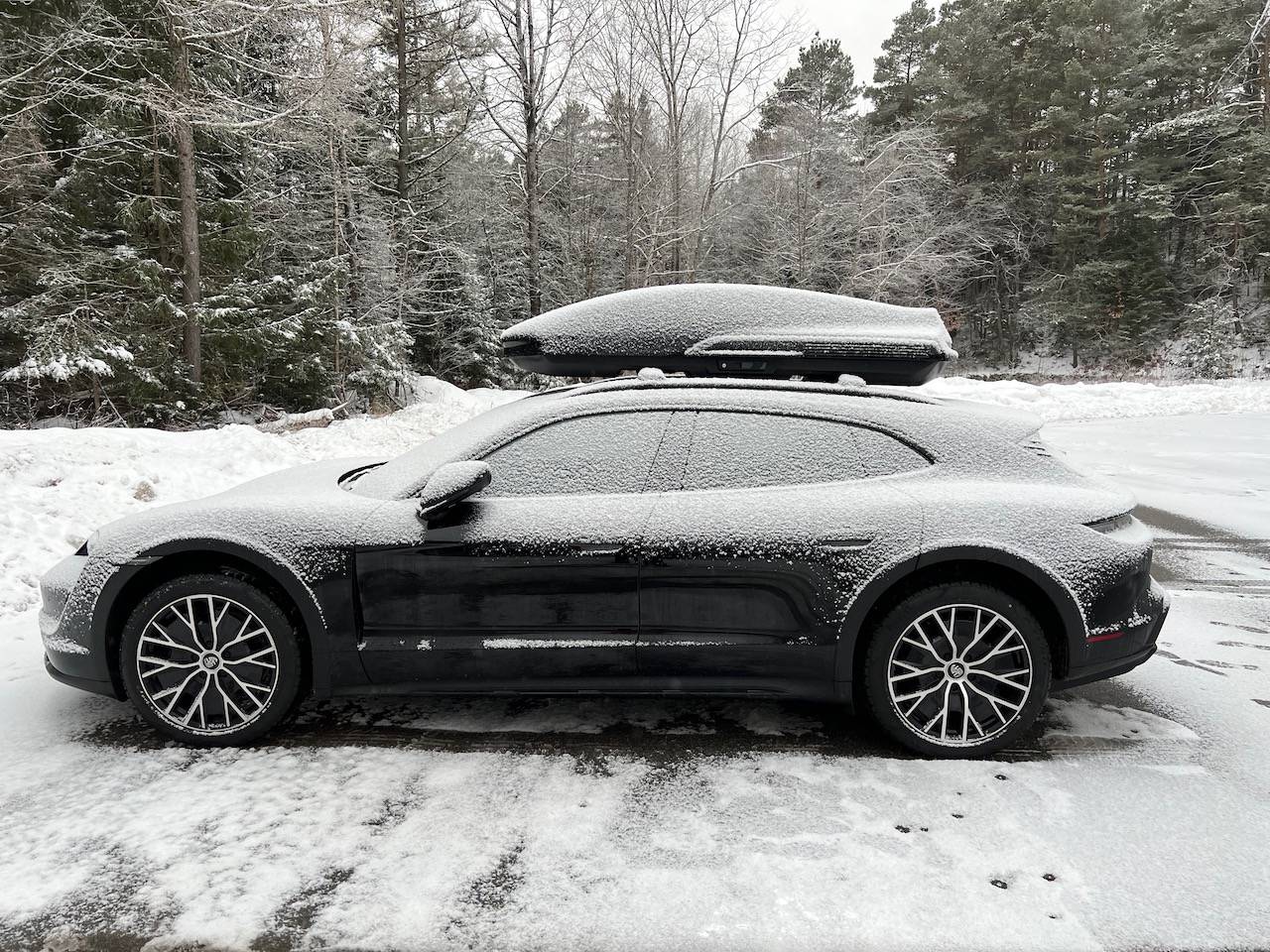

I purchased the Porsche Performance Roof Box before I received my CT4 (unboxing thread here). After seeing the issues @Swissbob experienced with his OEM roof bars, I decided to get the Thule WingBar Edge 9585B roof bars.
After two winter road trips, I've been experiencing a frustrating noise issue. Its not the wind rush / whistling you would expect from roofbars/boxen, rather its an intense buzzing noise that starts above 65 mph (~105 kph) and gets more intense with increasing speed. It was quite unbearable.

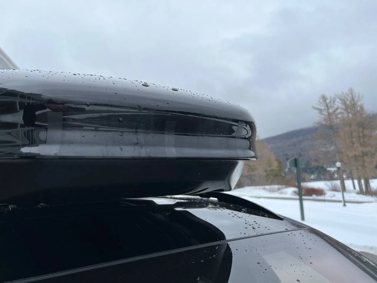

There was no visible shaking, so after double checking the torquing of the clamps and making sure nothing else was loose, I eventually narrowed it down to the front edge 'nose' of the box, where the upper and lower parts of the clamshell come together. It seems as though the airflow is such that its pushing through that front nose junction and causing them to chatter intensely.
Given that the press release for the Performance Roof Box was touting wind tunnel tests at up to 120mph, I'm pretty disappointed. However, I'm inclined to attribute the problem to a combination of the roof box and the Thule WingBars together. The Thule WingBars sit lower than the OEM bars, closer to the panoramic glass surface. Also, where the OEM bars have compensated height such that the PPRB would sit perfectly horizontally, the Thule WingBars are not height compensated. So on top of the WingBars, the PPRB is not perfectly horizontal - its flat underside is at about 3º to the horizontal.
I am very reluctant to switch to the Porsche OEM bars and risk trashing my roof rails. So my low-tech solution is to add three strips of black electrical tape! With three strips of tape at the front, the box is quite silent.
Sharing this as an FYI to other folks who have or are considering this combination of accessories. I'm interested to hear if anybody else is having noise issues with their Porsche Performance Roof Box, regardless of how its mounted.

Just throwing this out there, but I have seen online that in some cases turning the carrier around with the bigger end facing forward improves efficiency. Maybe it might take care of your noise issue?
Your car looks great in snow, btw.

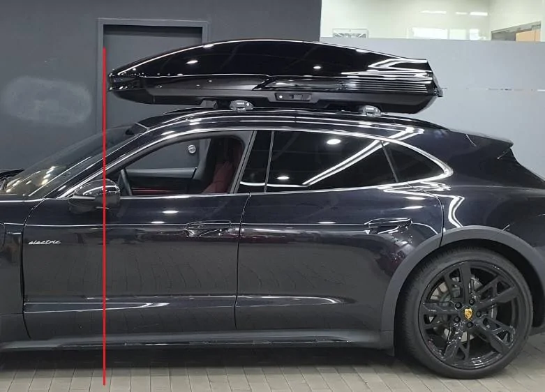

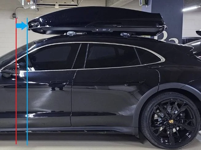

I got the same setup as yours. (Thule low profile bar + Porsche roof box on a CT4 ^^). The buzzing sound from the box at around 100~120 Km/h drove me crazy. Today, I moved the box as far as it can go to the rear.
The noise is gone now ^^ (I hope it does not comeback!!!)
Here are the pics
Porsche Taycan Performance Roof Box + Thule WingBars = Noise Issues 타이칸루프박스출고위치before
Porsche Taycan Performance Roof Box + Thule WingBars = Noise Issues 타이칸루프박스소음제거위치
(FYI, I also moved the bars forward as much as I could.)
Here are the pics
(FYI, I also moved the rear parallel bar forward as much as I could)
I am also having noise issues but with the Thule Vector M roof box. Not buzzing but more a wind noise. I hoped it would be more silent with the aerodynamic box. I wondered if it would be less with the Porsche box but the trick seems to be to shift it as far back as possible.
if you shift the roof bars more to the rear the box will be unleveled I presume. Front one comes higher and the trear one deeper. Probably why you shifted the rear one to the front ? That’s why I did it.
Here are the pics
Thanks for sharing - I might try this.
Looks like the box is slightly more level - would you agree?

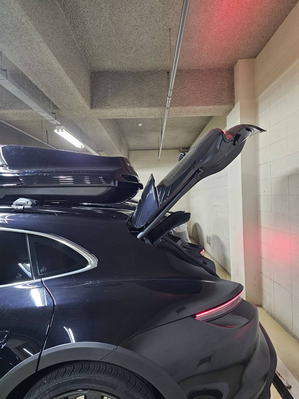

Do you have any issues with the rear hatch / trunk door clearance when opening?
Driver
Kirang
Jan 5, 2024
Taycan CT4
Yes, I would say my roof box looks more level now. The buzzing noise is gone really :please:👍 so far, so good.
There is about 1cm space between the box and tailgate when fully opened even though they look so close in the pic below.
