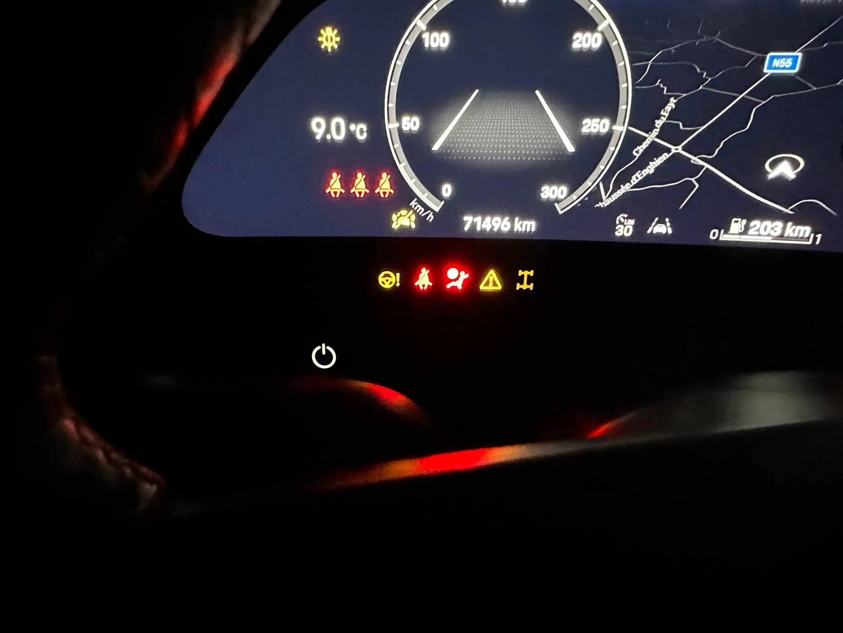

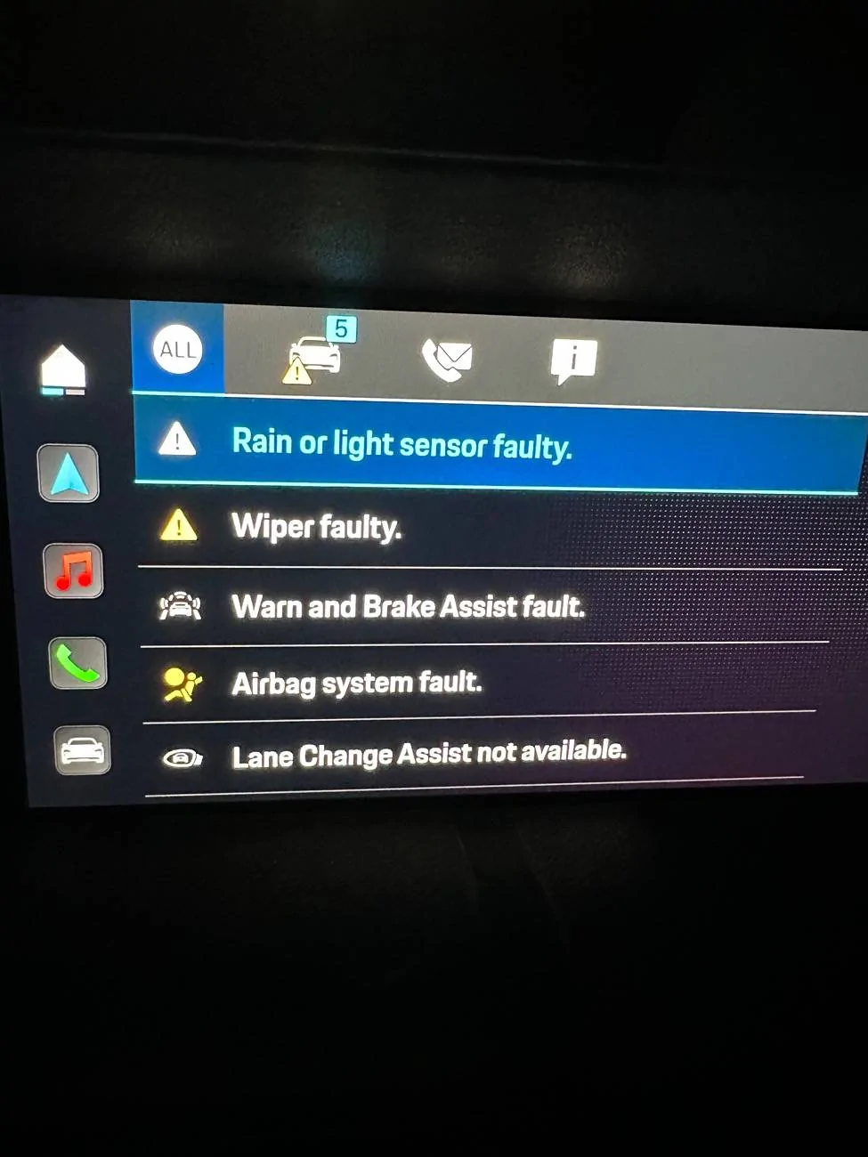

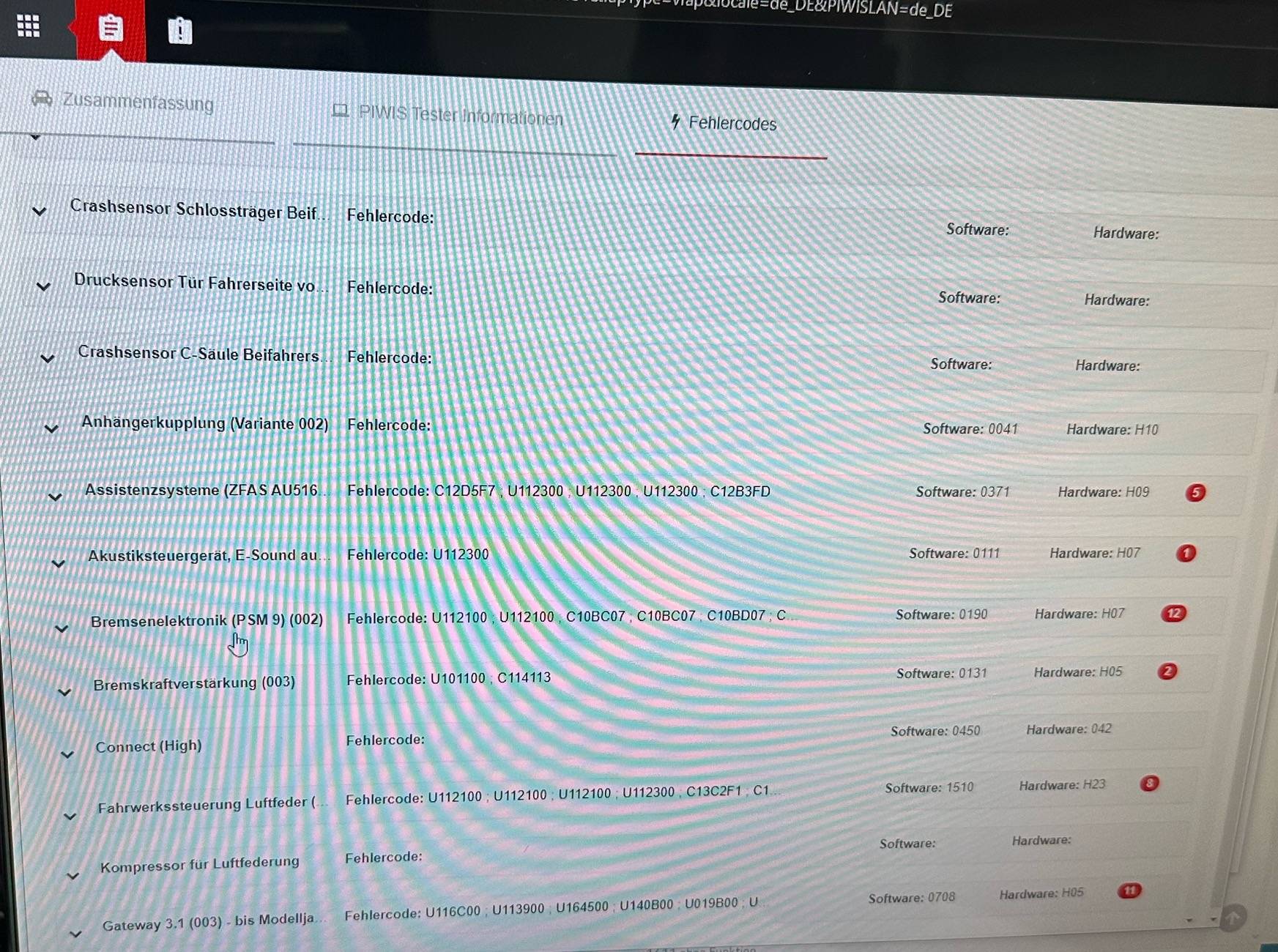

Good afternoon to everyone here in the group, I bought a 2022 Porche Taykan Cross Turismo, the issue is that I have warning lights on the instrument panel and they seem to me to be errors that are in the car's control unit, which can only be erased with the program from the porche piwi (3 or 4), I imported the car from the Netherlands and I have already done all the paperwork for legalization. The problem is that now I have to do an inspection to be able to obtain the registration plates but without the lights off and the car with diagnosis made, the car cannot be inspected, on the other hand, as I still don't have registration plates, I cannot drive the car to the Porche dealership to carry out the diagnosis and erase errors, as even trying to hire a tow truck is a bit difficult. here because the car weighs 2.3 tons and existing trailers only transport up to 1.5 tons, refusing to do the transport service as they could lose their license if they are stopped by the police! In addition to the errors, my front wiper also doesn't work , it sends water squeaks, the back one works perfectly but the front one doesn't…..it also says that the rain and light sensor is damaged….I don't know if that's the reason why the front wipers don't work!as for the rest The car works and drives perfectly… Does anyone here know where I can get the piwi diagnostic program for the porche taykan….?????does anyone know how to exclude these errors from the control unit without the porche diagnostic program????….and without the program I can't even know for sure if my rain sensor has any problem, in fact I have already removed the rain sensor and apparently everything is fine….
Porsche Taycan Piwi diagnostic program for Porche Taykan IMG_8078
Porsche Taycan Piwi diagnostic program for Porche Taykan IMG_8075
Porsche Taycan Piwi diagnostic program for Porche Taykan IMG_8063
Porsche Taycan Piwi diagnostic program for Porche Taykan IMG_8062

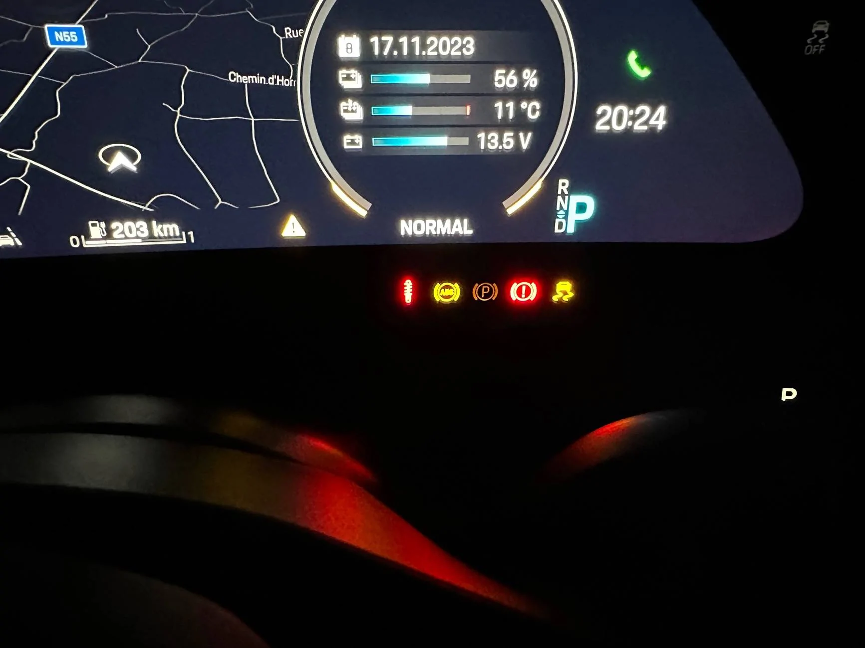

Well, regarding my previous post, I went to the official Porsche dealership in Katowice, Poland, and left the car there this morning for a fault diagnosis. After 6 hours, no one called me to pick up the car. I went to the dealership to find out whether I could pick up the car or not....
Well, things started to go wrong. As soon as I got in, I was told that the car had 149 faults (I was in disbelief). Then the man who did the diagnostics came and said that he hadn't even erased any faults. I asked him why and he replied that there were a lot of faults.... (I thought... he must be joking). Then he went to the parking lot where the car was and started talking about my tire, which had a puncture (anyway). I told him that I was there to find out about the faults, not to see the car's exterior defects! Well, they told me they had no idea, maybe it was some wire inside the car that came into contact with another or that became bare... blah... blah... blah, conclusion: I paid 420 euros and they didn't even give me the list of errors. They said that in order to see what was wrong with the car, they would have to dismantle the interior to see all the electrical parts inside (I was shocked), in other words, they don't know the reason and they have no interest in knowing...!
Later I went back to the dealership again to speak to the workshop manager and ask him why the diagnostics cost 420 euros when they had previously told me that they had not even erased the errors and that they had been with the car for 4 hours (which I thought was a complete exaggeration), 4 hours to diagnose the errors... (something is not right here)! After speaking to the shop manager and after he made a few calls, he informed me that they had checked the errors and cleared them and that they had done the check-up again after 30 minutes and that the same errors had returned again (a bit strange). Then he let me take three photos of the error codes that were on the computer, he told me that they had no idea why the errors were occurring and that I should try to disassemble the plastic around the inside of the car and try to find some wire, stripped or melted...... which could even be the 12 V battery that was causing all those errors in all the modules... etc... etc...
In conclusion, I paid 420 euros for a service that was not done and at the top it said they didn't even know how to provide information, in fact they don't even know why the errors are occurring in the car!
The car drives, works, charges, etc... but the lights on the instrument panel and errors are still on... anyway, I honestly don't know what to do.
I'm sure I'll never take my car to the official Porsche service again, I'll try to sort out the problem as best I can but never again!
Porsche Taycan Piwi diagnostic program for Porche Taykan IMG_8175
Porsche Taycan Piwi diagnostic program for Porche Taykan IMG_8173
Porsche Taycan Piwi diagnostic program for Porche Taykan IMG_8174

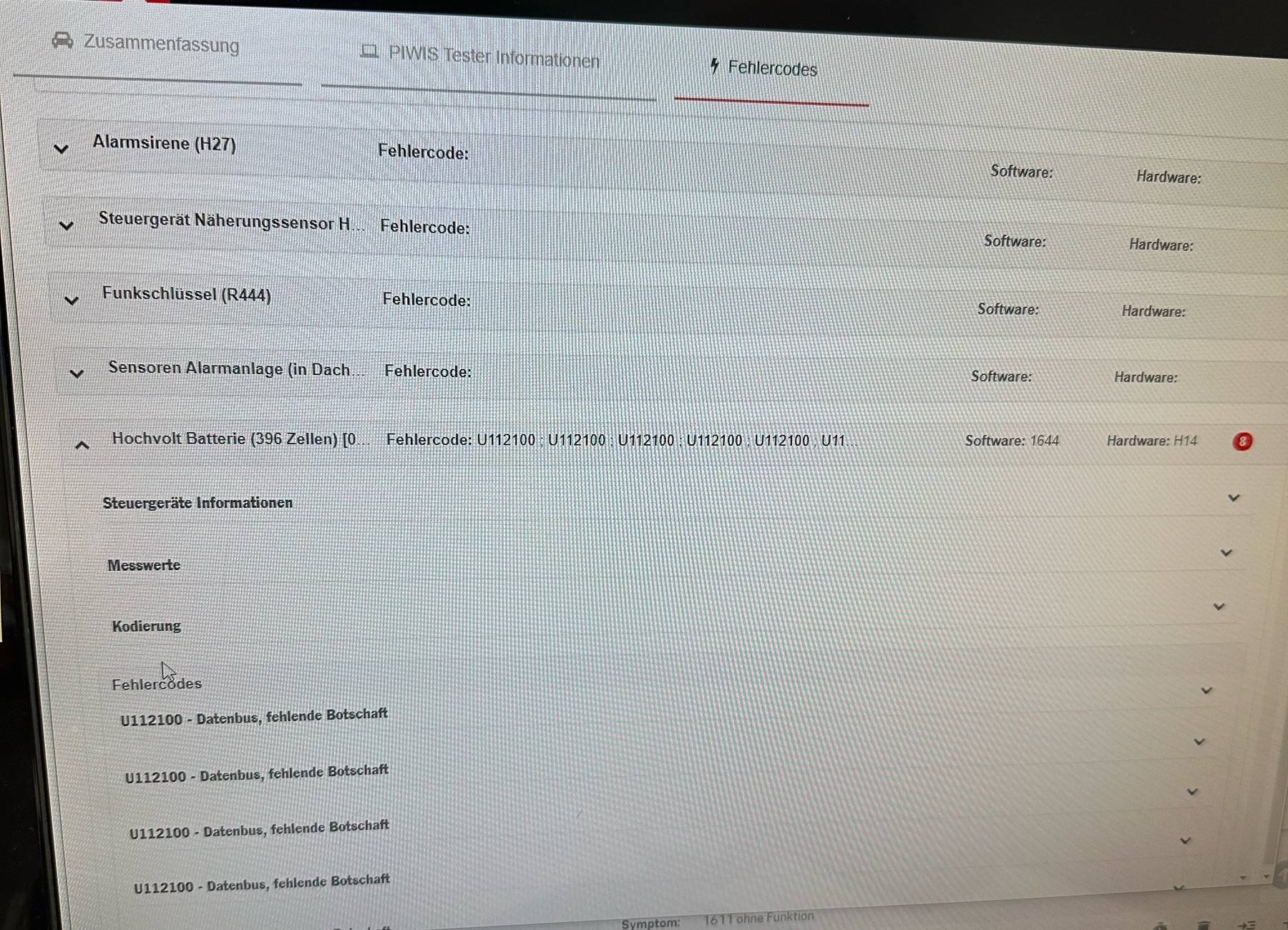

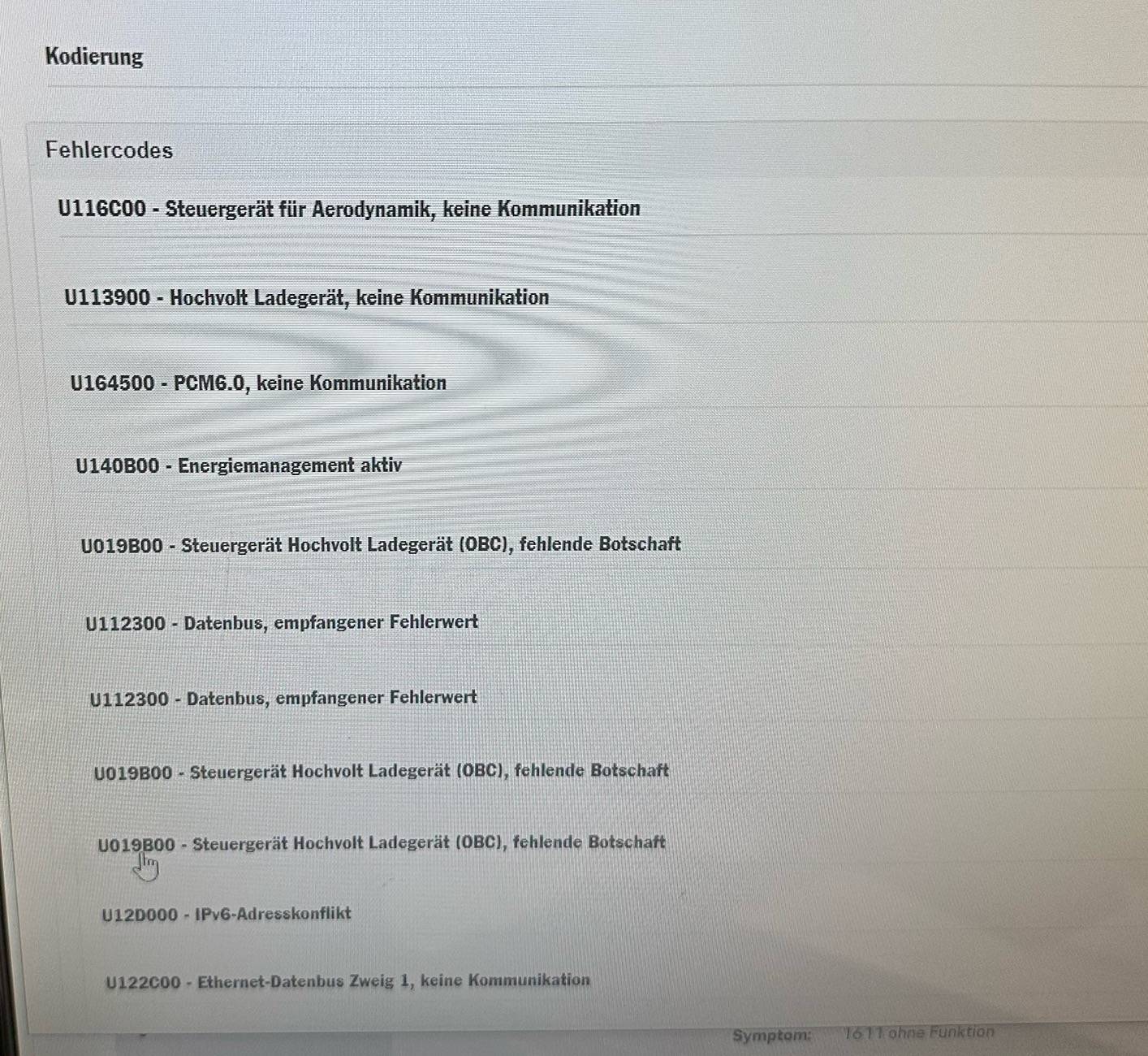

I leave here some photos with some errors that I managed to remove photos of but not everything is here, because they only let me take these photos...

Carlos, the items in your images with the red dot show that there are active errors and how many there are within each read dot, these can be groups of errors in a particular area.
Non active errors are shown like the red dot, but grey.
The text to the left of the screen tells you what was looked at, if there are no red or gray dots, there is no error.
