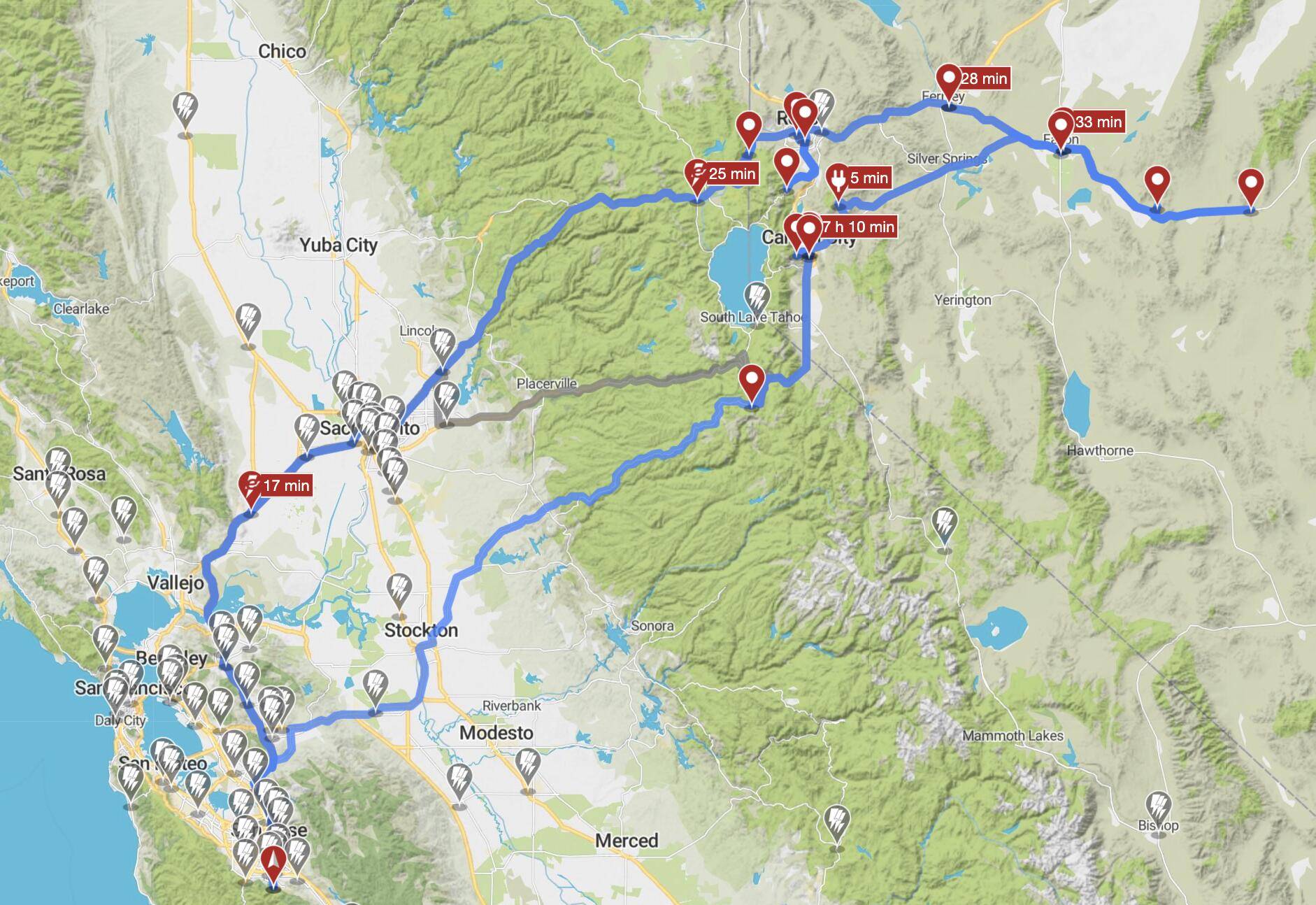

Taycan Trip to Loneliest Road in America (Hwy 50)
Only travelled on approximately a 120mi section of Hwy 50, as I planned sightseeing and charging infrastructure is indeed spotty.
Stealth Photos along the way: https://www.taycanforum.com/forum/t...s-of-your-taycan-with-scenery.2117/post-60897
Tools used:
  • A Better Route Planner with Taycan 4S Large Batt selection and 250Wh/mi @ 65mph (which is needed because it seems to underestimate usable battery size) and California spring temps. ~50F-65F.
  • PlugShare to check on health of chargers and any recent complaints. It’s the Yelp of EV Charging. :)
  • Waze to predict the location of friendly people with pretty flashing lights.
Summary at bottom of post, sorry for
DescriptionDist (mi)Elev (ft)Details
San Jose CA to Vacaville CA Outlets99200 - 200Started Batt at 87% (as charges past this point were problematic) Arrived at
EA Charging: Arrival 89F/60F 48%-81% 31kWh 17m Avg 109kW
Exactly as predicted by ABRP with 250Wh/mi @ 65mph
WalkDid a half mile walk around outlet stores.
Vacaville CA to Truckee CA130200 - 6600 - 5800One aborted charge after 4min (reported to EA) and 2nd charge was slower than it should be (reported to EA)
EA Charging: 89F/43F 12%-29% 15kWh for 4m Avg 225kW (Failed)
and restart 29%-74% 38kWh 21m Avg: 109kW (Slowish)
Truckee CA - Reno NV695800 - 4500 - 5900 - 4500First went to hike at Galena Creek Trail and went to Costco
Stay 1 nt in RenoNo nearby charging at the chosen hotel.
Reno NV to Fernley NV374500 - 4200Routed using Porsche Connect App which did not trigger battery Preheating :-( Arriving with Batt at F I was not driving this leg or I may have noticed. Did shopping at Walmart and left pretty much when done with business.
EA Charging: 62F/58F 36%-72% 31kWh 28m Avg: 66kW
Fernley NV to Fallon NV284200 - 4000Tested charging in town while walking in the area
ChargePoint Free 50kW: 63%-76% 13kWh 16m Avg: 47kW
Visited the museum, had lunch.5The Churchill Museum is excellent in Fallon NV
Fallon NV to Shoe Tree474000 - 4600Visited Shoe Tree ~40 mi outside of town. Highway driving at reasonably high rates of speed. :)
Shoe Tree to Fallon NV504600 - 4000Visited Sand Mountain Recreational Area on return. Needed a bit of charge again with Shoe tree being so far out.
Rested in the car during this charge.
ChargePoint Free 50kW: 31%-56% 22.2kWh 29m Avg: 45kW
Fallon NV to Virginia City NV574000 - 6200Opportunistic charge during visit to town 1 block off main st..
Tesla Dest Charger Courthouse Free 9kW: 30%-38% 7.2kWh 45m
Virginia City NV to Carson City NV166200 - 4800Unloaded at the hotel and parked the car at the charger for the evening just 2 blocks away.
ChargePoint Free 6kW: 37%-99% 63kWh 12h (preheat cabin and idle time as departure time set)
Stay 1 nt Carson City NV104800 - 5300 - 4800Hiked in the morning and visited a great Railroad Museum in town.
Saw the mysterious “WBA limited” warning on the driver console and it went away after hike.
Looking forward to my April 12th SW update.
Carson City NV to San Jose CA2364800 - 8500 - 200Left town with 93% arrived SJ with 20%, 270Wh/mi avg.
Summary:
  • Total Distance 777mi
  • Total Charging: 220kWh, Est recovery to departure charge: 63kWh
    Figuring 10% charging loss so 255kWh used, Average: 328Wh/mi,
  • Range at estimated 85kWh battery: 259mi.
  • Speeds, flow of traffic (if any) I can state that car easily does 5-15 over limit. :cool:
    I tried to always drive it like a Porsche, not an EV. I think my wife would agree…
  • Most freeway/highway driving was in Range Mode which was limited to 90mph when routing or 85mph when not routing. Passing on two lane roads accomplished by a quick twist of Sport Chrono dial to Normal or Sport, then triple digits easily obtained.
  • Next trip plan is Death Valley
