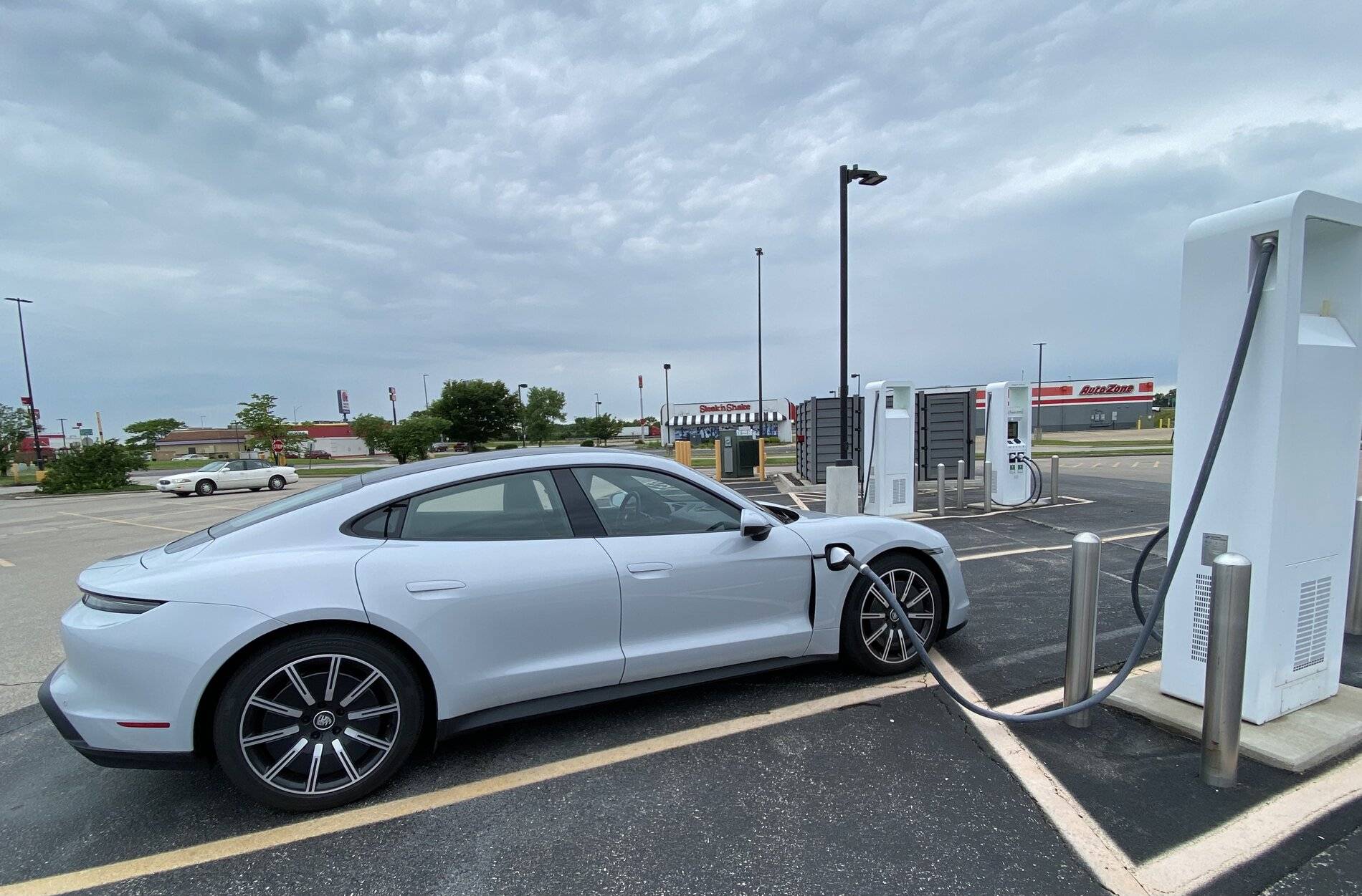

My first DC charging ever, today: I activated Plug & Charge in my 2021 4S (PCM menu: Charging > touch 3 dots in lower corner > check box for Activate Plug & Charge) and plugged it into a 350-kW Electrify America charger in rural Sullivan MO, and after about a minute of the charger’s
Porsche Taycan Plug and Charge just worked for me E441E6C3-81C9-442D-BF8D-66FADDF46C64
communing with the car, charging began. In 25 minutes the charge went from 33% to 85% (I meant to stop at 80% but overshot a bit), and I stopped the charging and unplugged. Worked great!
