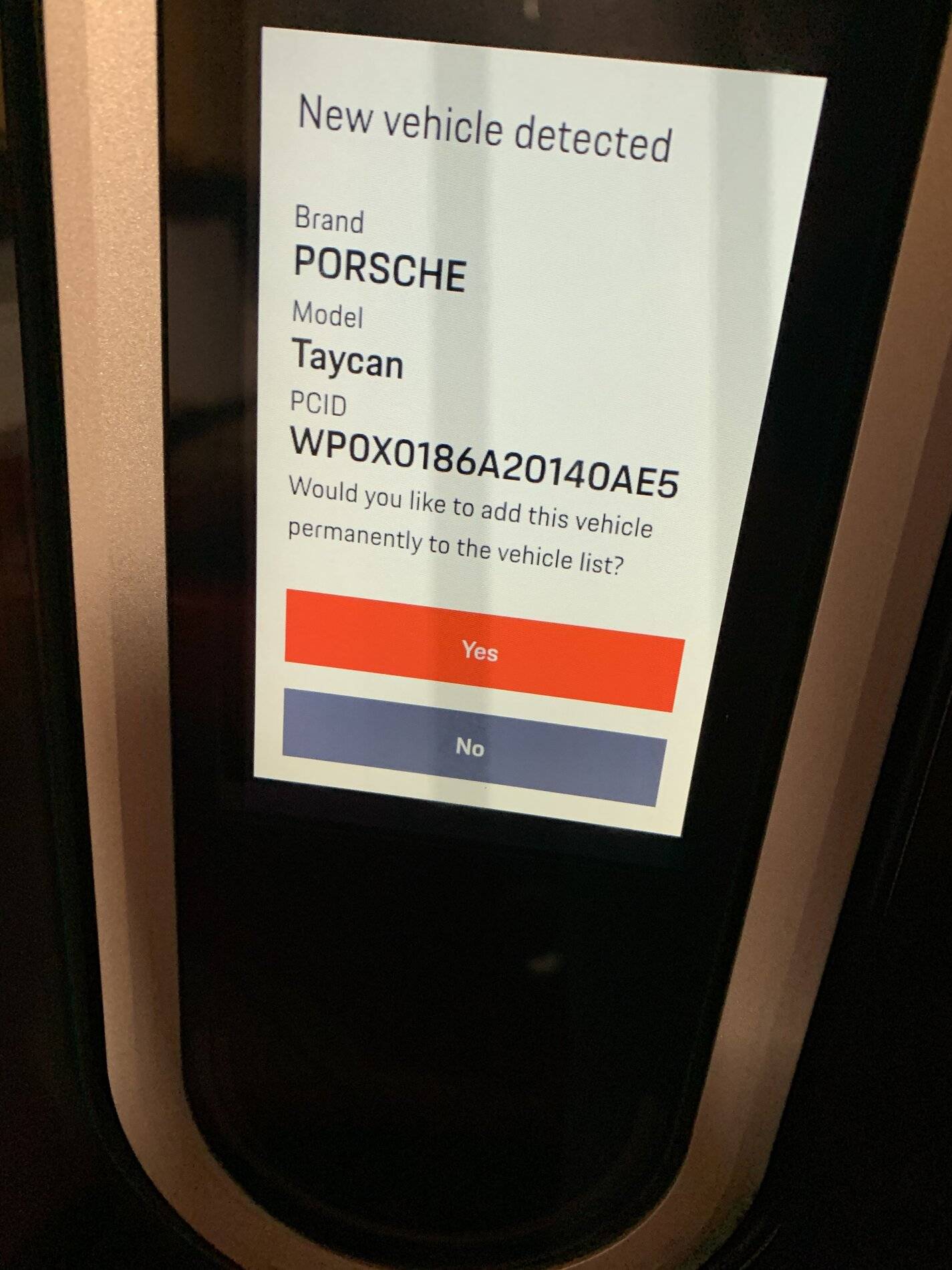

I set up my PMCC and it charges fine but it doesn’t recognize my Taycan and instead recognized this non-existent VIN. This happen to anyone? Factory reset did nothing and still recognized the wrong car. I get no charging tracking.
This isn’t my VIN in the photo.

@rquinton
Could your dealer or PECATL have needed a PMCC in a pinch and swapped yours with another vehicle?
I would call PECATL and tell them you have the wrong VIN on your charger since that is where you collected the vehicle.
Have you tried pushing No to add vehicle and see what happens or if it will charge your Taycan?
Your vehicle looks great and I really like the wheels you selected. Congrats!

This “VIN” is actually the PCID (unique to all cars and you’d expect it to be your VIN but hey ho) which the PMCC picks up when you have Plug & Charge enabled and PLC to Vehicle enabled. If you select ‘Yes’ then this authorises your car to the PMCC and it will record the same PCID in all charging logs and display the connected vehicle as Porsche Taycan.
Next time you connect the car will be auto authorised and won’t prompt for a PIN plus you can disable PIN requests (and Guest PINs) in the PMCC Web Portal on your PMCC. This effectively gives you plug and play plus prevents another non-authorised vehicle connecting and charging (PIN would be required).

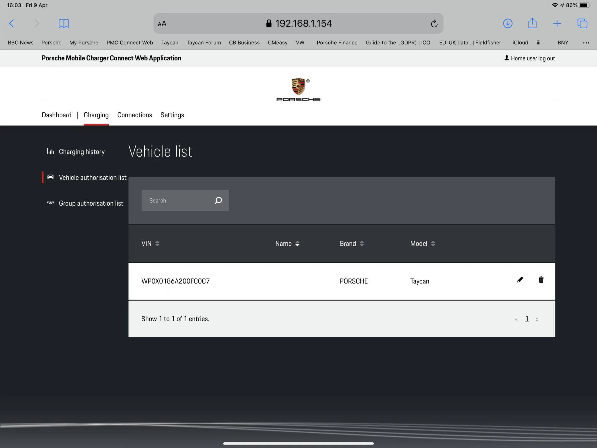

My PCID is as follows but a shame it doesn’t transmit the actual VIN for the vehicle as both PCID and VIN appear to be the same thing.
Porsche Taycan PMCC doesn’t know your Taycan? 0C429701-06F2-4326-9B97-476854AE6974
