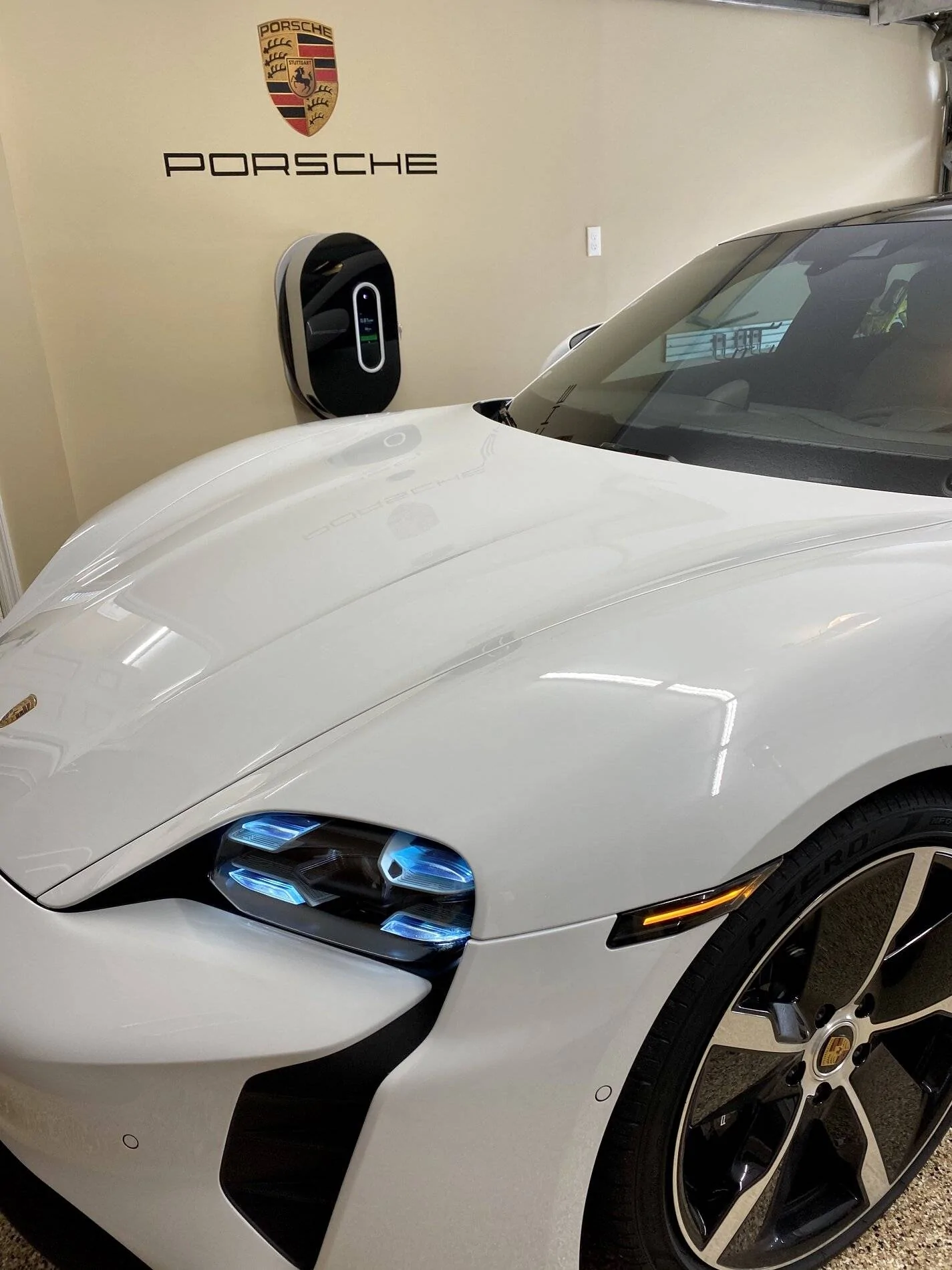

So I notice heat from both sides. And yes it’s significant. Lifelong Floridian. Hot garages are common. But this thing is clearly adding heat. You are correct. A two car garage going up in temps by 3 degrees is huge. Which is fine in the grand scheme of things. A charger shutting down...bad.
My charger is located on the passenger side.

hmmm -I"ve not noticed/checked/paid-attention-to any soft quiet heated airflow from the passenger side - I"ll have to check it out - but your PMCC does seem perfectly positioned such that the exact area the airflow is exhausting will add additional warmth to the general area of the PMCC Dock - we'd need a thermal engineer (which I'm not) to be able to determine if it's significant enough to make a difference - I can probably say it's not helping…
when I install EV chargers I always install them as close the garage door as possible so that the charging cord has maximum reach into the driveway…this tends to position them towards the back of the vehicle rather than the mid-section…
as to if that makes a consequential difference I really can't say with out a more detailed study and some expertise in thermals which I sorely lack.
in any case I believe we're gaining a better picture of the PMCC and it's relative reliability and robustness…
it appears 100% safe, but perhaps not the best, most reliable or robust EVSE on the market. It is certainly the most expensive and complex one on the market.
