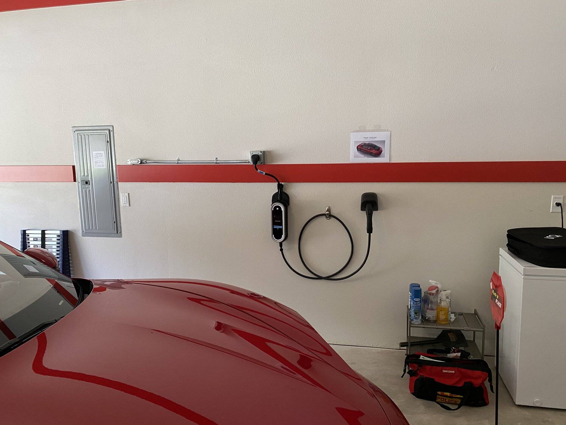

So far, after three days, am perfectly happy with the PMCC with a NEMA 6-50 plug, Hubbell industrial receptacle, #6-gauge wire run, and Siemens circuit breaker. Nothing gets too hot to hold at 82 degrees ambient and a 40 amp rate.
And the PMCC has performed flawlessly for us, except for taking a long time to update its firmware. No trouble controlling the charging from my iPhone 11 MAX or from the car. I did take painstaking care to ensure MyPorsche, Porsche Connect, and the car all had personal information, passwords, and preferences that were identical. Some of our information went back to Germany from a 2011 delivery in Stuttgart and suspect it caused some initial login and country problems. Also, Porsche email login names must be lower case (some parts of their system are legacy), passwords must be no more than 16 characters, and ! is the only special character allowed.

@wmras nice install - with the supply cable in open air it will run much cooler - congrats…
also given the conduit - upgrading to a 60 amp charger should be trivial if you ever decide to go that route!!
