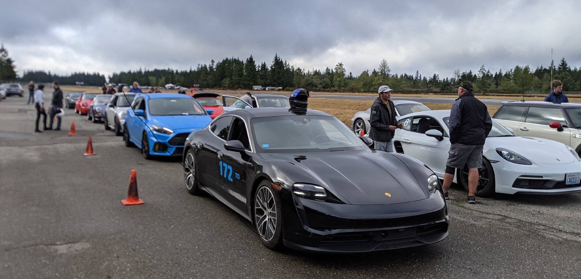

After 6 months and 12K miles, I finally got around to taking my 4S to an Autocross event hosted by the PNWR PCA down over at Bremerton.
Conditions was damp and rather moist in the morning, but mostly dried up by 4th runs expect for a damp spot at the last slalom. Car is still on the stock 245/285 Michelins Pilot Sport 4 that has 10K+ miles. Started at 36/32 PSI cold which was really pushy at the start and as I worked thru the runs I ended up settling at 36/36 PSI by run 4 which was mostly tolerable for me. At the end of run 4, the front tires was starting to get warm, but the rears were still pretty cold. Plan is to go w/ 275 or 285 in the front and then 305 or 315 in the rear similar to the Turbos. I'm keeping the car in SCCA SS class rules so what I'm running is going to be dictated by class rules. Running on truly competitive tires, I'm fairly certain I can drop the times by another 2-3s, and if you throw an alien in, that's probably another 1-2s.
Body roll and composure was more than adequate given that it's still stock. It's still a really wide and heavy car so the laws of physics still apply. Brake feel is interesting and a bit unnerving at first. I think because of the break blending the top half of the travel feels light but once I get on the mechanical I started getting the stiffer pedal feel that I prefer. Not too big of an issue and it's something that I intend to focus on in the future. I'd like more bite from the standard brakes, so once I burn thru the OEM pads, plan is to see if I can get something like the Hawk HP+. Primary concern is still how wide the car is. Given its width, tight slaloms are painful.
For those in the Seattle area, I was able to easily to get from the northside of Seattle to Bremerton via the Tacoma Narrows Bridge, do 4 runs and multiple additional launches cause people were interested in the car. and then back to Home w/ 25% battery still left.

What brakes do you have?
My Taycan is w/ the standard brakes. Reason was because I was planning on running 19" tires which typically has much better extreme tire options. This is actually becoming much more difficult than I had originally anticipated as I would need to have custom wheels made and not been able to find any 200TW tires in 19" that would keep the general overall diameter to be able to support the weight of the car.
I'll likely see if I can borrow a set of GT4 wheels and tire from my friend and see how the Taycan runs with them. Unsure whether the significant drop in ride height is going to be an issue.
SCCA SS class rules allows for you to go +/- 1" diameter and +/- 6mm offset, but wheel width has to stay the same.

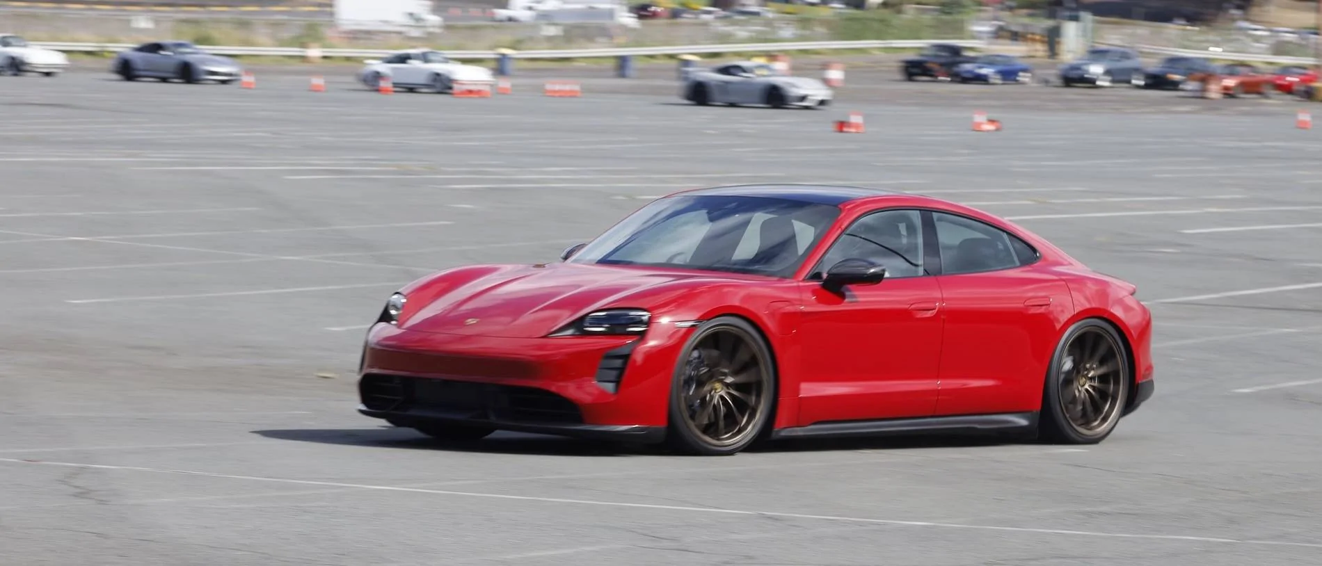

I did another NASA event in my Taycan RWD yesterday. The Taycan continues to perform really nice on the NASA "small circuit" layout we run here in Hawaii.
For quick comparison's sake, the lowest time of the day was in a 718 GT4 at 45.6 seconds and I was 46.2 in the Taycan. My friend with the GT4 swapped cars for the final session and he nearly matched my 46.X times and I matched his 45.X times.
The biggest handicap I noticed with the Taycan in comparison to my 992 and the GT4 was the visibility through the "A" pillars. I found myself needing to adjust my head position to look
"far forward" in the Taycan. I think this may be due to the extra width of the Taycan and it felt very similar to my vision in my Audi S6.
I do not have the exact sheets in front of me at the moment, but will see if I can grab them.
We also have some static overhead drone footage coming which will be interesting to compare the two cars.
