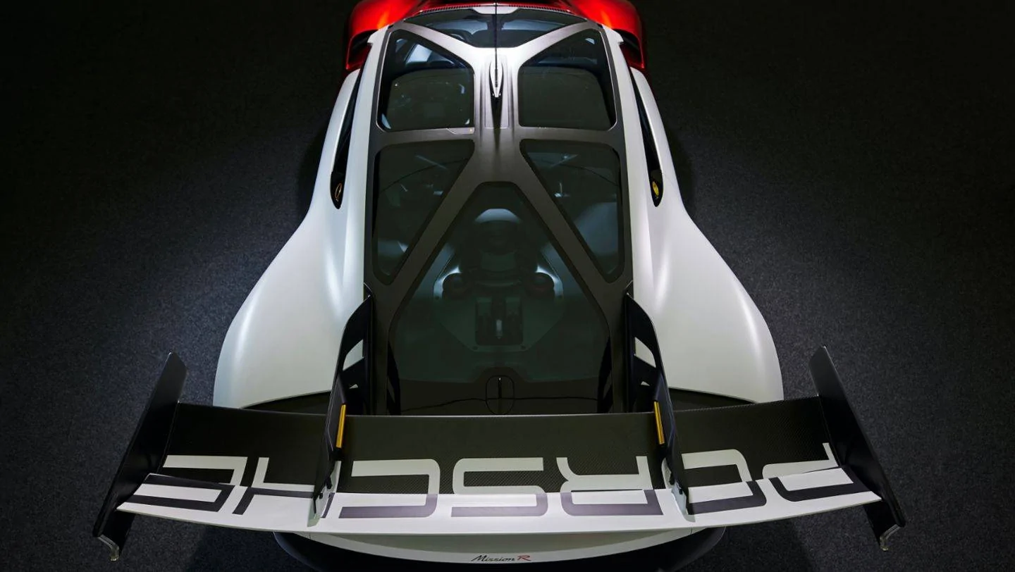

Innovative cage structure made of carbon fibre composite material
The ‘exoskeleton’ is the name Porsche’s engineers and designers have given to the eye-catching carbon cage of the Mission R. The carbon fibre composite cage structure combines high protection potential for the driver with low weight and a distinctive look.
Porsche Taycan Porsche Announces Mission R EV Sports Car Concept 300821-Porsche23900_LDN
Porsche Taycan Porsche Announces Mission R EV Sports Car Concept 300821-Porsche0276_LDN
Porsche Taycan Porsche Announces Mission R EV Sports Car Concept 300821-Porsche0318_LDN
The protective structure forms the roof section and is visible from the outside. Like a half-timbered construction, it provides a framework around six transparent segments made of polycarbonate. This enables those racing the car to enjoy a new feeling of generous space. There are also some transparent surfaces, including a removable escape hatch for the driver, which is based on the FIA requirements for racing vehicles used in international competition. The roof solution with the exoskeleton is a modern interpretation of the Porsche Targa, in which the solid roll bar is also combined with a removable roof section.

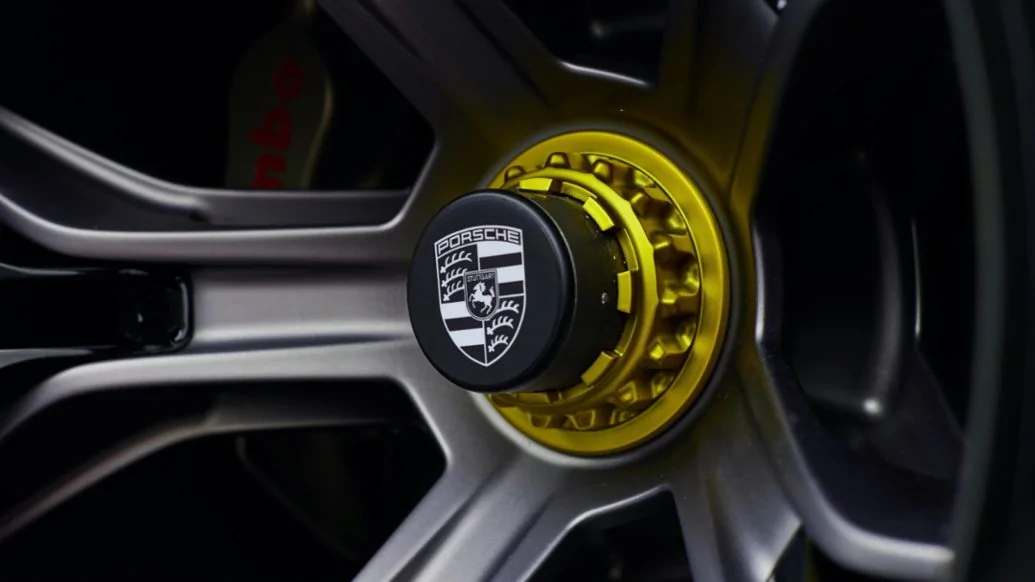

Magnesium wheels with aeroblades and tyres
The Mission R rolls on 18-inch magnesium Cup centre lock wheels. With smooth-surfaced carbon aeroblades, the alloy wheels are also flow-optimised. Their five twin spokes are also milled, which saves weight.

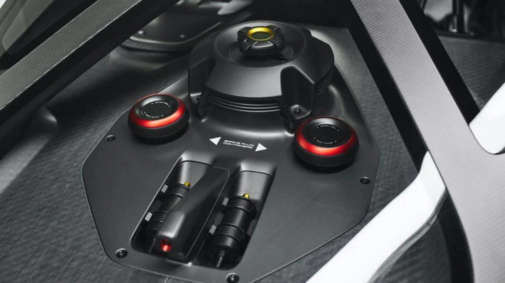

In the brake-by-wire braking system, a control unit models the interaction between the hydraulic and electric brakes, which is known as brake blending. Due to the high recuperation output of up to 800 kW, the conventional brakes are subjected to a significantly lower load and could thereby be reduced in size. The diameter of the brake discs is now 380 and 355 mm at the front and rear, respectively. Six-piston callipers are fitted at the front, four-piston at the rear. The car is started with a battery status of 85 per cent (SoC). Recuperation is possible therefore in almost every driving situation. This means that, depending on the race track, more than 50 per cent of the energy can be recovered and is available for use.

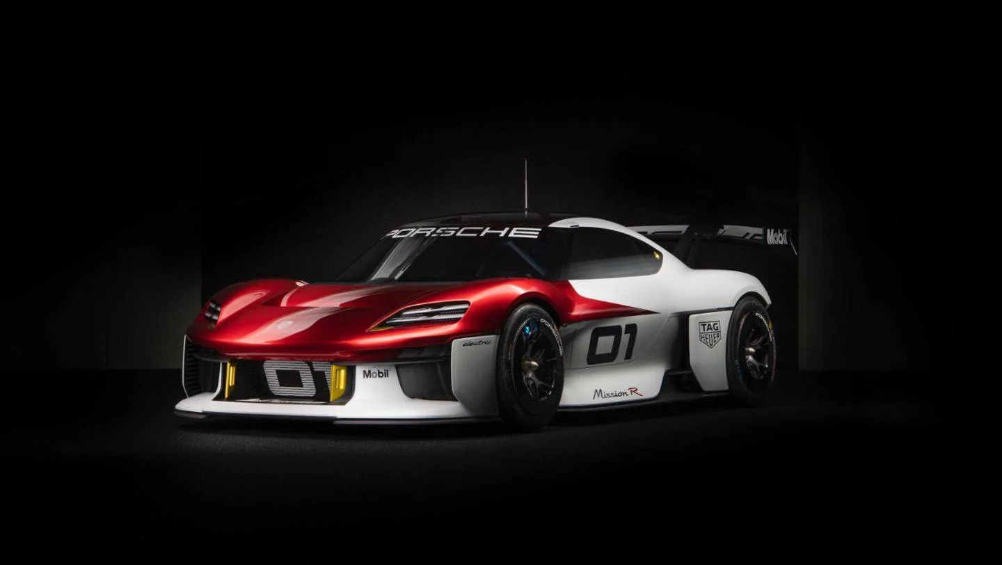

On Performance:
The Mission R is on a par with the performance level of the Porsche 911 GT3 Cup. The power output remains constant over the duration of the race, so there is no thermally induced de-rating – a major advantage of the electric motors with direct oil cooling developed by Porsche. The electric motor on the front axle produces up to 320 kW (435 PS) in race mode.

Special high-voltage alert system for the pit crew
As a matter of principle, the high-voltage safety concept of the Mission R meets the same high standards of safety as those required for series production vehicles. This means that, in the event of a collision, the battery connections to the vehicle and the high-voltage consumers are automatically disconnected to ensure no voltage is present. There is also an alert system designed specifically for the pit crew: special LEDs behind the windscreen and on the roof provide fast and detailed information on the operating status of the high-voltage system. If the LEDs light up green, the Mission R is high-voltage safe. If the LEDs are red, on the other hand, only high-voltage trained personnel should approach the vehicle. There is also a light in the roof module behind the speed-measuring pitot tube, which is included in this colour-coded warning system.
