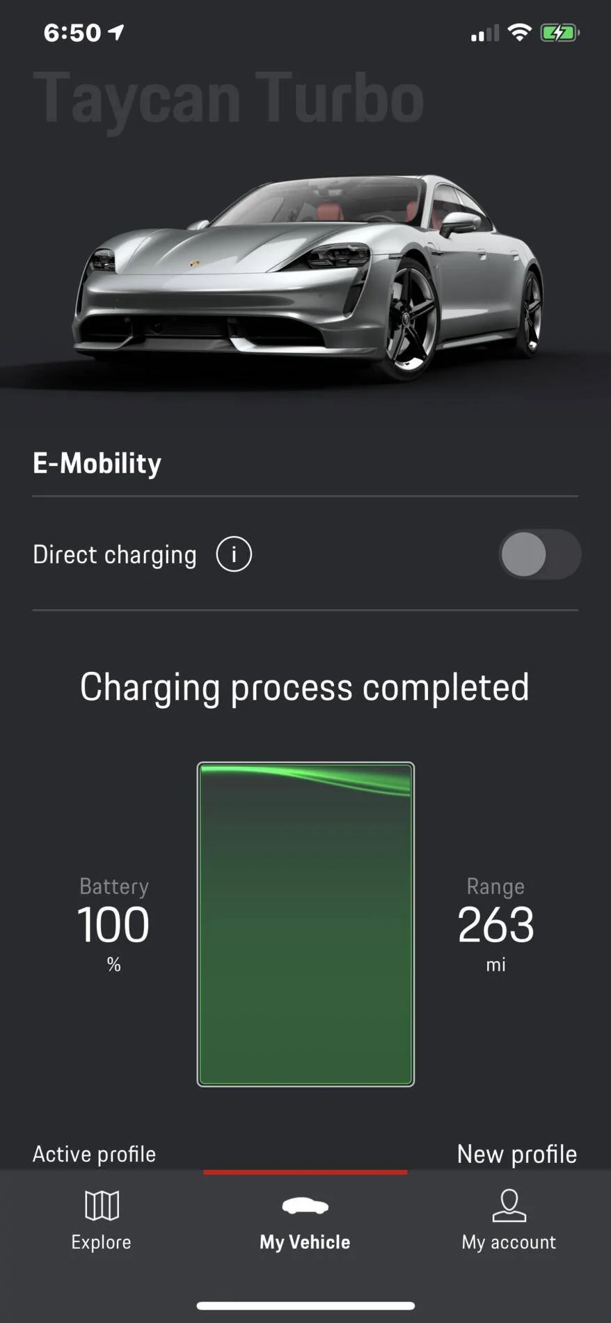

I got my Turbo about a week ago and I love it! The 11KW charger that comes with the car works smooth and trouble free, I have a 14-50 50amp circuit and it draws 8.8 kw only. Charges .4 miles per minute, I’ve got about 400 total miles now that I’ve driven 100% of the time with the AC running and the seat coolers running and I am averaging around 270 miles range per charge,
