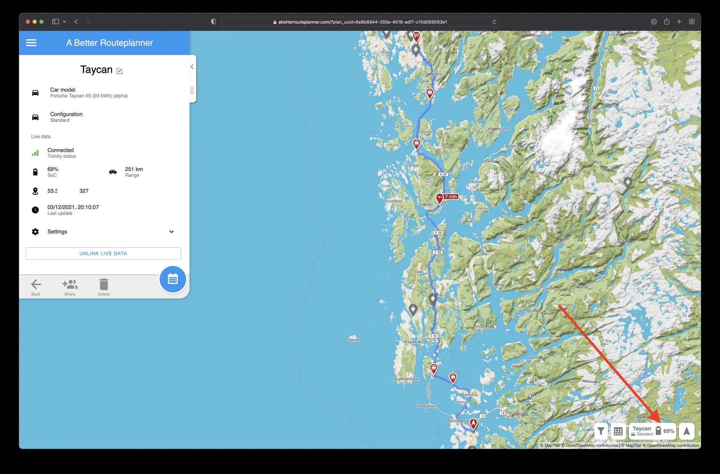

Here it is in action – ABRP linked up to live data via Tronity.
Porsche Taycan Porsche Charging Planner/A Better Route Planner Screenshot 2021-12-03 at 20.10.57
Probably more useful than sharing the current charge level with ABRP – is the fact it shares actual historical consumption kWH/100km – so that ABRP can then calculate suggested stops based on real-world usage rather then relying on the "community settings" for your car model type.

If you want a four week free trial of Tronity – here is a referral link that they show in my account:
https://app.tronity.io/signup/HtzfazUIn
WARNING- Tronity only works in Europe- Do not use if you are in North America or outside of Europe .... it did work for a while then they starting using a different solution to login to porsche servers (service called Driver). As far as I can tell they have no plans to extend support outside of Europe.
Is there a similar service for folks in North America?

- To start recording vehicle data, you must first add your vehicle to Tronity.
- Click "Add Vehicle"
- Response: "You have reached the limit of vehicles".
Great.
