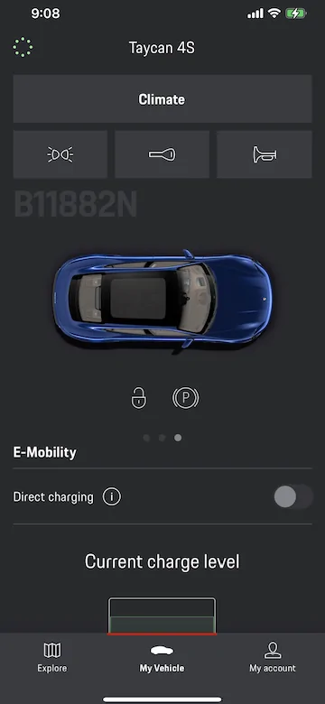

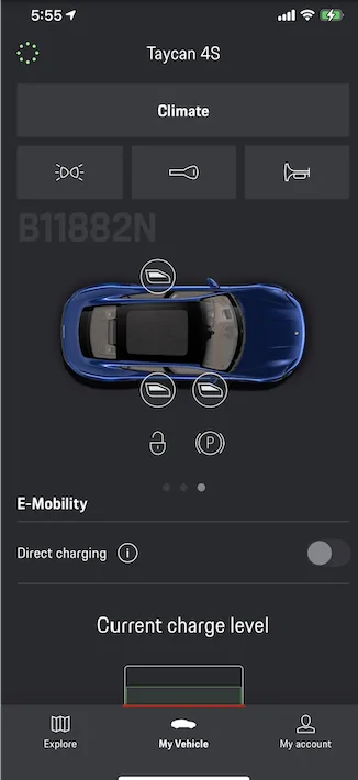

For some reason the windows are showing open when they are not. The only one that shows closed is the driver's door, probably because I use that door.
Does anyone else have this problem.

Sometimes the app can hang up and do that, but to make sure I would put them down and then up again.

I have done that, and it does work, but then they show open again later on.

I've had that issue since getting the car back in August of 2020. It still persists even after the most recent software update. If I open the app and then leave it open for awhile it seems to eventually correct itself and show all the windows closed but just about everytime I first open the app it shows several if not all the windows open.

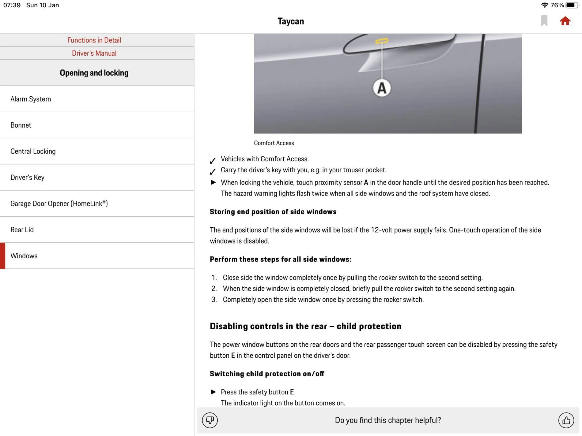

Have you tried recalibrating the window travel limit?
OK, done. Good for now. Let's see what happens after I drive it.

I have found this is a connectivity issue. If I get out of my car and the App has not connected to the car, it shows the windows open. Once it connects to the car after I leave the car, the open windows go away.

The My Porsche app does this too. Seems to default to showing the car unlocked and windows open. Once it connects, it corrects itself. “Unintelligent defaults”

Next time it happens, shake the phone from side to side and a bug report form shows up. Fill it in; that way they will know that this is happening frequently to many of us. Basically when the app connects to the car it often shows a semi-random state (eg window open) until it has fully connected; correct behaviour would be to grey out the indicator until it can provide a correct value.
