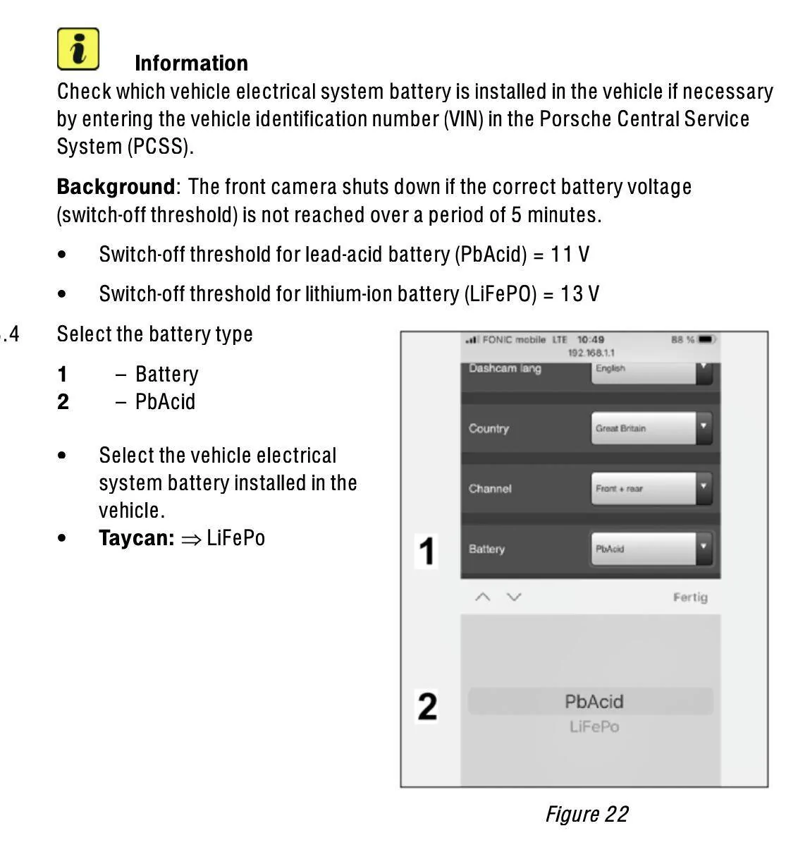

If you can, can you check in the parking mode settings what the voltage cut off limit is? ( It seems to be not mentioned in the manual though so maybe it's not user visible)
Sorry, can't see this information anywhere.

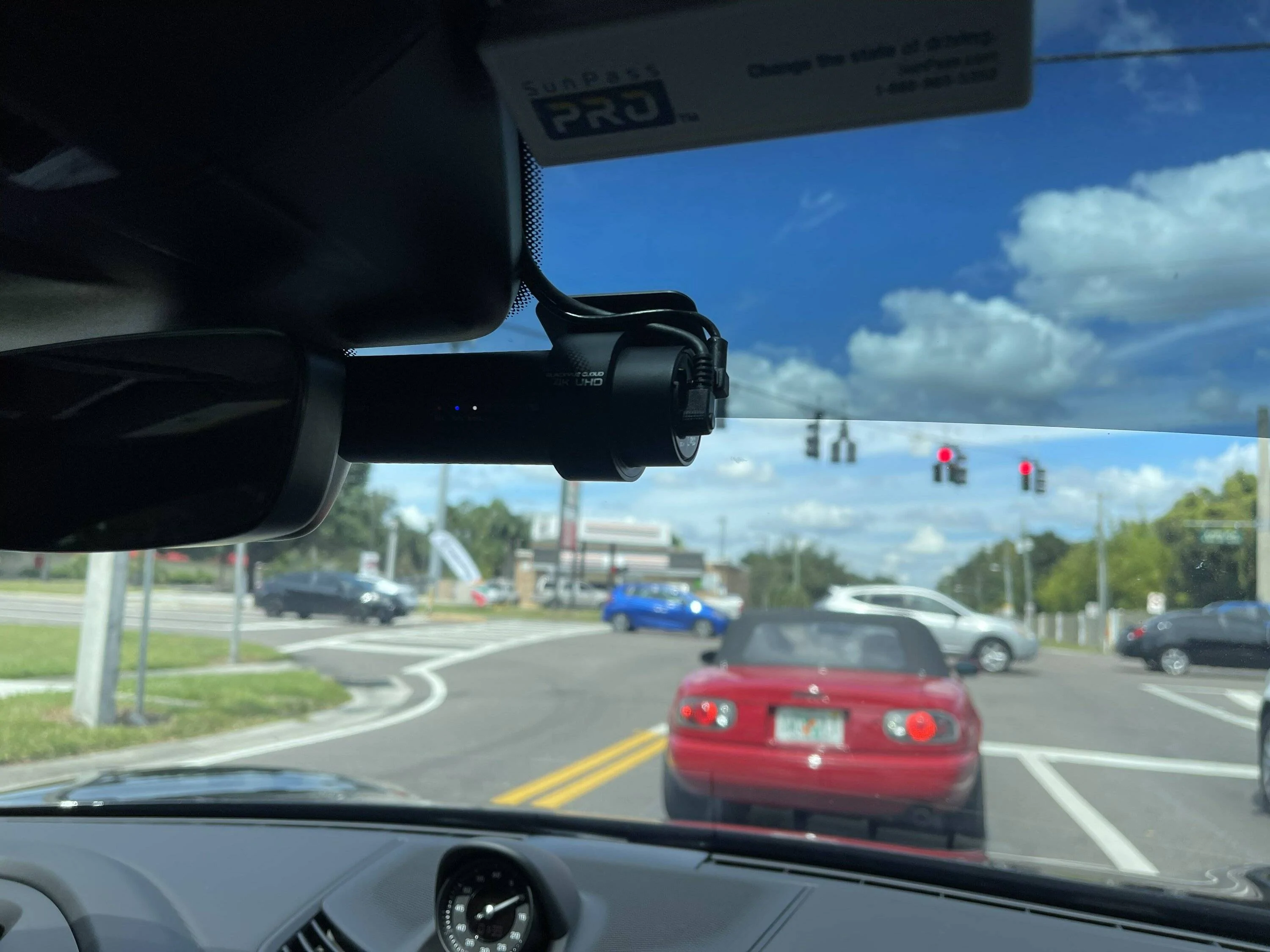

I have my Blackvue front dashcam mounted on the passenger side (right in the US) up behind the mirror and absolutely does not block my view as a driver. I have the rear camera tucked up in the rear passenger window. You cannot see it and it does not obstruct my view. Look at the picture and there is no sign of a rear camera. No wires visible other than those plugged in the front camera.
nicely done! this is how it is supposed to be

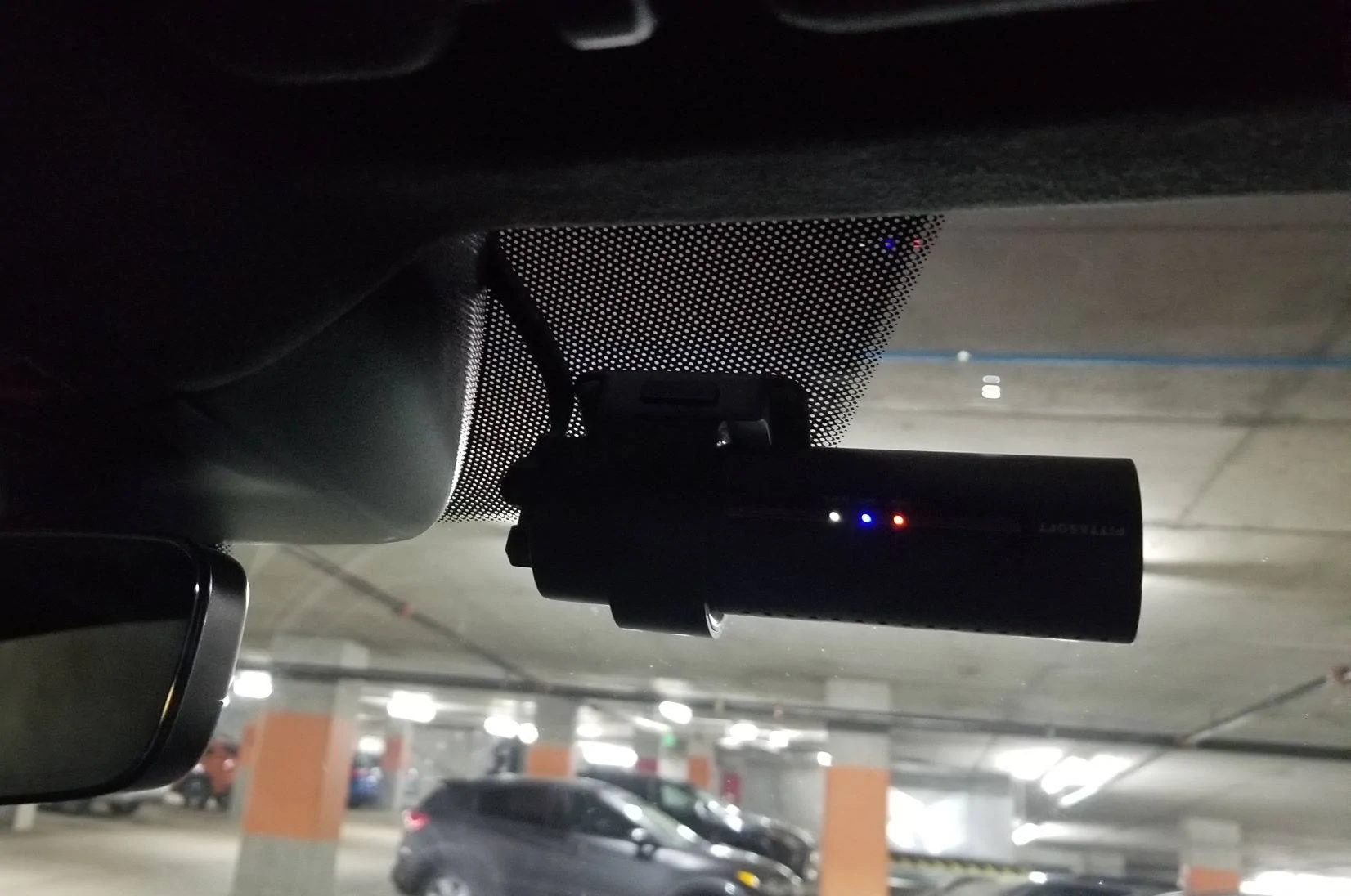

Just wanted to add that if you want GPS reception on the Blackvue camera (and have thermally and noise insulated glass?), you need to move it the other way around with the connector part into the black dotted area. It will make it more visible though and a bit off center... still fine though for me.
(here is another thread that uses a similar location -- that one is a tad more to the left but then you will get the black dots into the view).

The manual for Porsche Dashcam is 230 pages in various languages . Here is the english section. I will research the install but the mechanic had only 1 sheet and all it showed was the camera installed on the right side. Sorry re the confusion re Europe but after we moved the camera the mechanic said he thought of European cars with right side driving. Again the camera blocks view if mounted on left side.
Only install instructions showed placement of camera on left side. But this blocks drivers view. Attached are the english guide from the 230 page dashcam guide that is in various languages
Here is the manual that is in the Porsche Dashcam application. I will try and get the fuse slot info from the mechanic. Note the manual refers to vehicle battery monitoring, the camera monitors its own energy use and in order to protect the vehicle battery and maintain operational. This is critical for the Taycan with its' 12 v battery. Do other cameras do this? This is why Porsche wants only this camera in the Taycan I think. The parking mode interacts with the Taycan's radar sensors so if someone hits car while parked the camera activates. The question Taycan owners have to ask do you want to risk putting a non Porsche part in your $150K car and have it potentially void your warranty? This is probably why the manual states have a Porsche partner do the installation ( and they can charge $1700 just to install). I think its worth it if i am involved in an accident and In CA the other driver almost always claims they were not at fault.
13V (from the installation manual)
