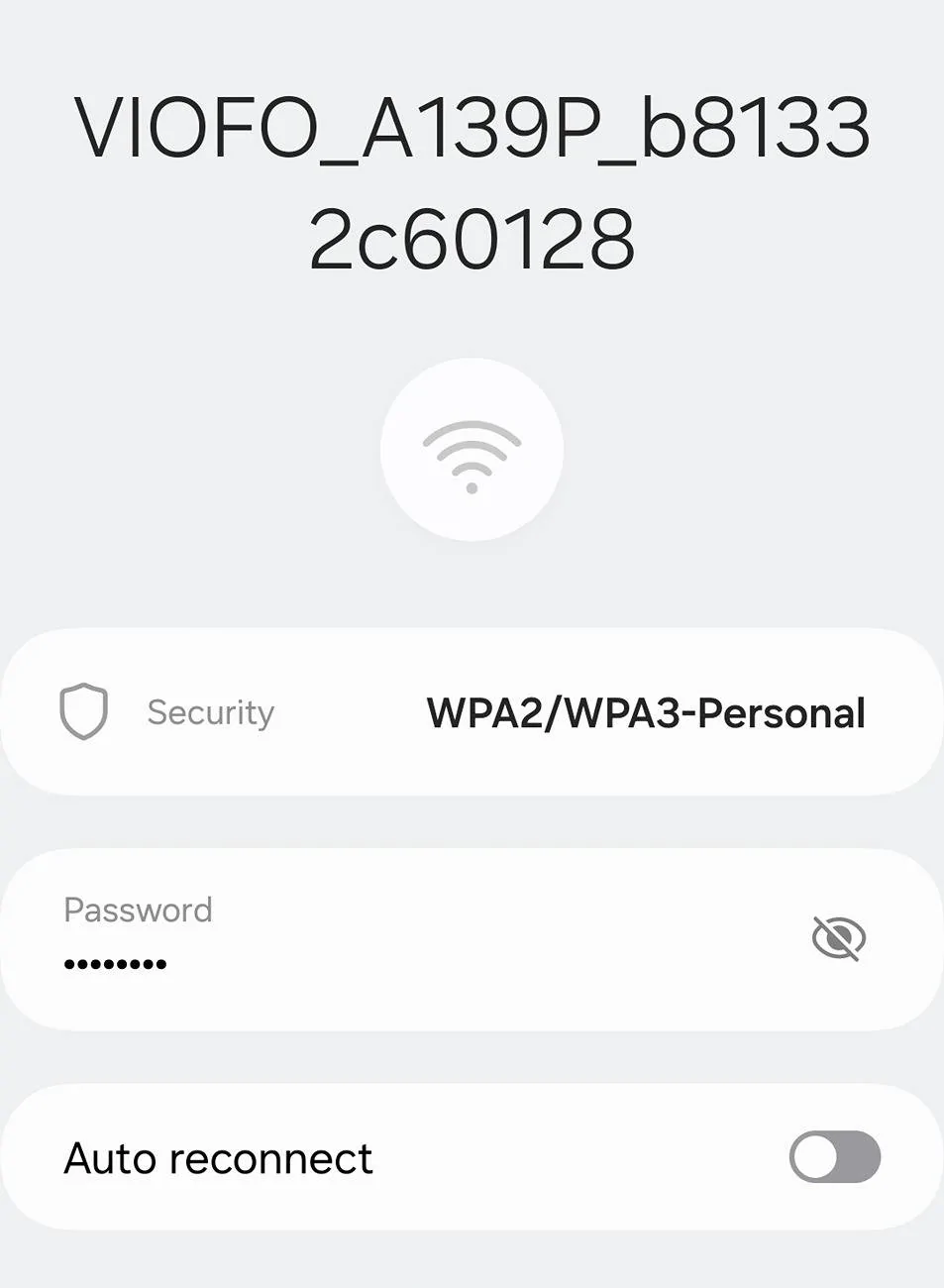

I had this with my Viofo A139Pro but solved it by switching Auto Reconnect off. See image
Also on the Viofo it automatically turns wifi off after a few minutes if the App is not being used

It is the same with all cameras that use WiFi to connect to a mobile. They compete with the car for the connection. You should be able to resolve this by turning off auto reconnect in the phone wifi settings for the camera.
