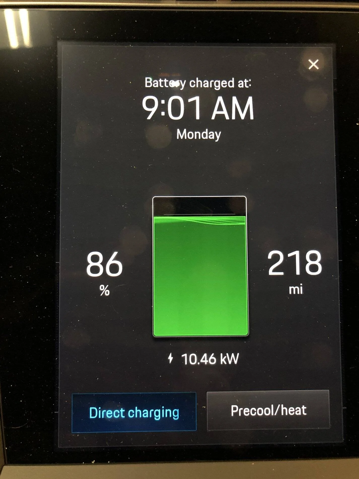

Question: If I'm hardwired for 48 amps, will I charge 20% faster? If so, a bonus!
this question is meaningless with out specifying which EVSE (EV charger) you are using? The PMC+/PMCC currently sold is documented as a 9.6 kW EVSE - so hardwiring it won’t magically make it provide more than 40 amps (50 amp breaker) - Porsche does have “bare hardwire supply cables” in other regions, but so far does not offer them for sale in North America. Now the Porsche supply cables are “indexed” cable, they have electical connections inside them to “tell” the PCM+/PMCC what type of cable is currently connected - so that the PMC+/PMCC will provide the appropriate Amperage given the type of supply cable (and hence the breaker size) it’s currently connected to. I’m not sure what would happen with a North American PMC+/PMCC if you attached a “bare-wire supply cable” and what set of Amperage would be allowed by the charger.
So for now charging a Taycan in North America at more than 40 amps requires a non-Porsche EVSE - because Porsche does not yet offer a faster charger for purchase - they could, they have it in the parts catalog for other regions, but they do not yet offer it in North America.
the “mythical” 19.2 kW PMCC would charge a normal Taycan at 11 kW - but to date I’ve not spoken to anyone that actually owns one of these in North America nor how it was installed/configured.
in North America you need a few things to benefit from 48 amp charging:
  • 60 amp 240 volt circuit available (circuit breaker + appropriate gauge wire)
  • a 60 amp EVSE (external EV charger) like the ClipperCreek HCS-60 (there are others)
    • it will be hardwired - there is NO plug based EV charger above 50 amps (breaker)
_IF_ you have a 60 amp circuit & you have a 60 amp EVSE - your taycan will charge at approximately 11 kw or 48 amps - the in car charging display reports 10.46 kW during charging on my 100 amp Tesla Gen2 wall chargers. Which is more than the documented 9.6 kW charging rate specified by Porsche on the North American website - and exactly the amount of kW you would expect for the Taycan if it was charging at 48 amps (and matches the charge rate in regions where Porsche documents the 11 kW limit)
https://www.taycanforum.com/forum/t...-charger-48-amps-not-max-9-6-kw-40-amps.1793/
