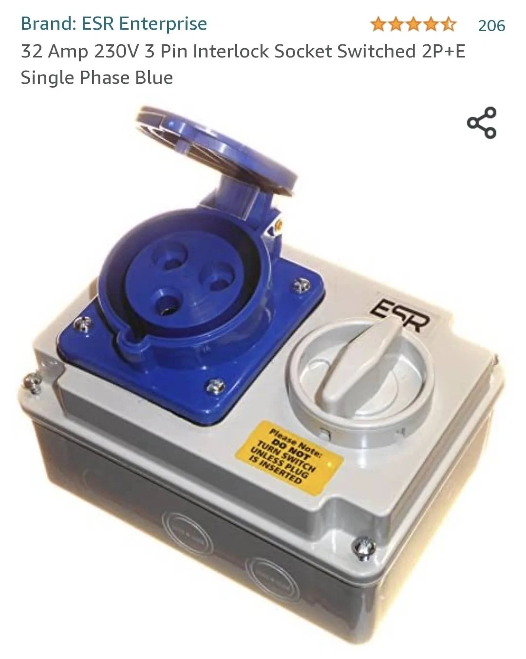

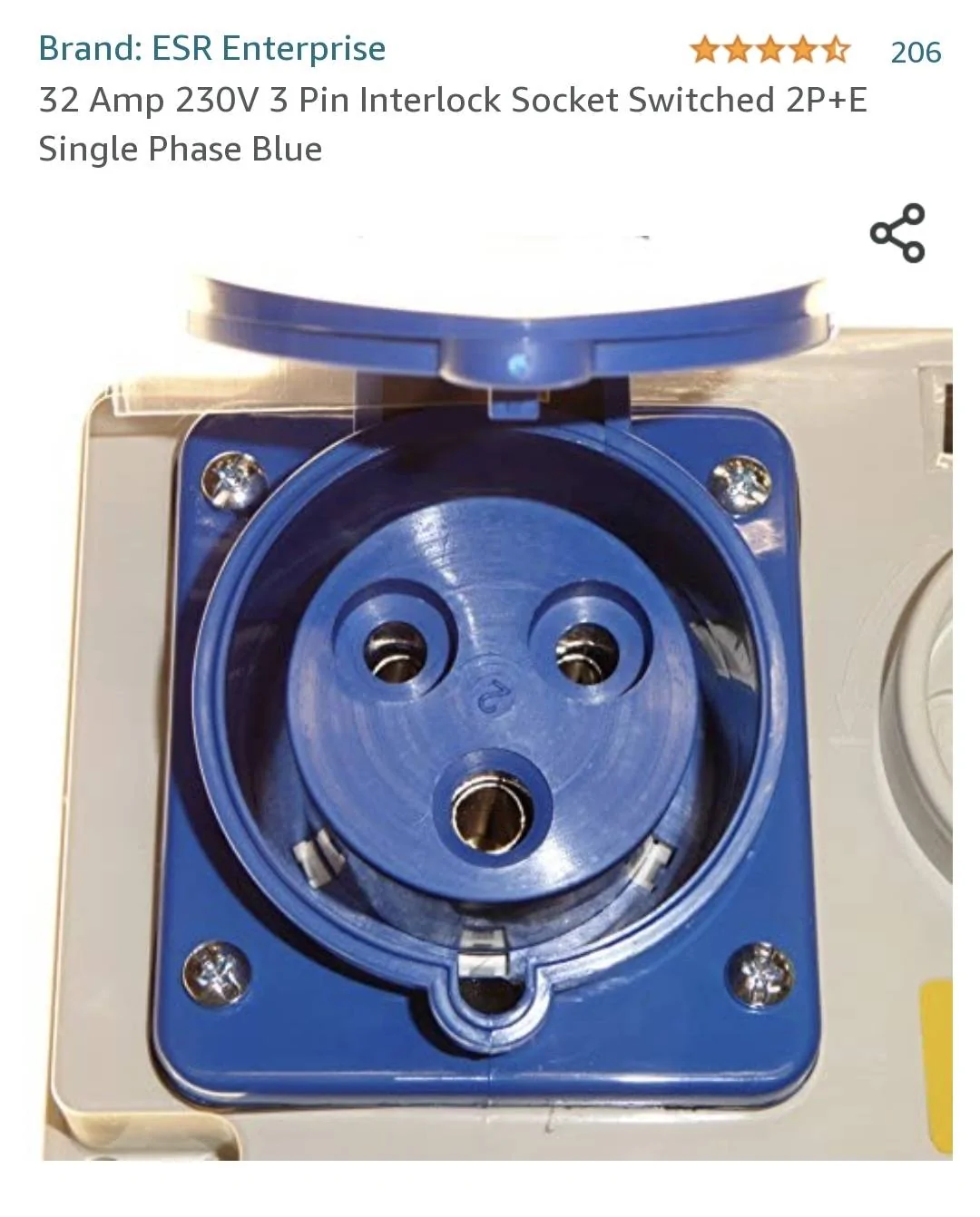

(a) is the mounting bracket included in the PMC+ standard package?
(b) Is the standard UK 32A 230V 3-pin socket (see photos) the right configuration?
Grateful for confirmation/views. My aim is to home (garage) charge at 7.4kW

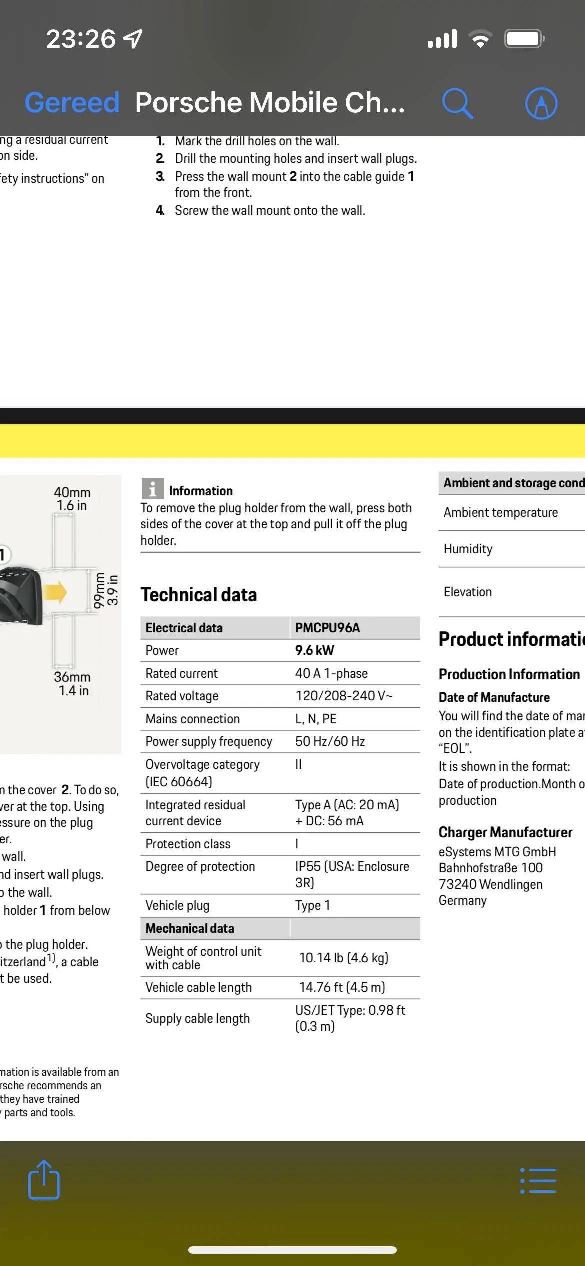

The mounts shown in the device manual (do a search for "porsche mobile charger plus installation" for a copy see pages 20 - 22) came with mine.
Can't answer question about UK plug because I am in USA.
Edited: Although you did not ask about this. In US the electrical receptacle which fits the plug for EVSE comes from different suppliers starting at $5 in building supply stores. Recommendations are to use a "high quality" receptacle for this use - one here which costs $97, not $5. Thought is that you do not want to scrimp on quality of receptacle you have installed at home.

I have a similar question about the PMC+: I receive my car in a week and want to get the wiring done in my home.
What is the maximum kW that the new ones will charge. All the documentation that I've found online says 9.2kW with 1 phase, while the press release says 11kW
Can this charger accept 3 Phase (400v) and at what amps to do 11kW?

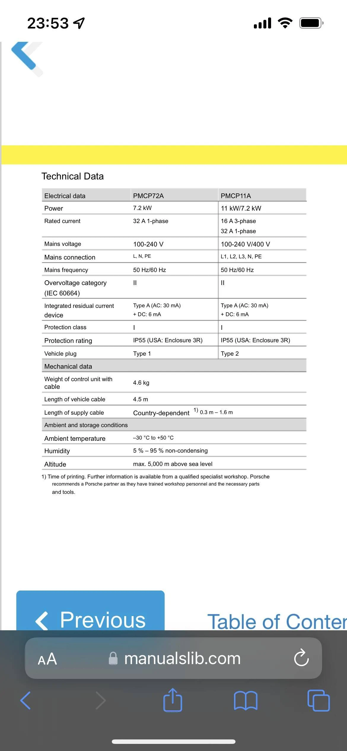

Does anyone in the UK know if the PMC Plus built in RCD protection is double pole, i.e. it disconnects both live and neutral if the RCD is tripped as required by the 18th edition regs?
I haven't been able to find a UK version of the spec or installation instructions online.

Two different versions. The standard delivered European Mobile charger plus is 400 volt, 3 fase, 16 A, 11 kw. It needs an industrial 3 fase Socket to charge 11kw (the plug is included). With the delivered Schuko household plug it will only deliver 2,3 Kw.
The US one is 9.2 Kw and is 40A single fase.
The European optional PMC Connect is 22 kw (32A).

Electrician needs to know if CU needs 2 pole RCBOs. If EVSE has in built RCD protection that complies with IET 18th edition then CU only needs single pole RCBO Type A B curve..... I'm not guessing just trying to find spec for UK version of PMC + for EV installer.
This is the European one PMCP11A
Many thanks, in the UK the regulations now require that THE RCD disconnects both live and neutral and none of the manuals I have found tell me. Not a big issue we can install double pole RCBOs in the consumer unit, but I suspect the UK PMC+ will already have them and legally it has to comply with the smart charging code from June this year.

Standard AC onboard charger is a max of 11kW.
To achieve this you will need a 3 phase supply.
Standard single phase supply with a dedicated 32A fused supply from your main board will deliver 7.4kW max - ample for overnight home charging.
RCD in the mobile chargers disconnects all poles (1 or 3 live depending on 1ph or 3ph charger), also the neutral even though I think the regs (even amendment 2) still state only that all LIVE connectors need to be disconnected during a fault - but I'm not a sparky!
Brilliant that is exact;y the information I was looking for.
The definition of disconnectiong all LIVE connectors in the Regs includes neutral. 722.531.2.101 Every charging point shall be protected individually by an RCD having the characteristics specified in Regulation 415.1.1. The RCD shall disconnect all live conductors, including the neutral.

FWIW,
Because other family EVs or hybrids may us my 32A commando at some point in near future - and I am not sure of their spec ......
I got installed - a separate 32A metal clad Open-PEN RCBO fault correction device - specifically suitable for EVs - close to the commando socket (was only £120 ish) -
and a normal 2 way 32A consumer unit where the circuit links with the meter tails in my porch (around £30) - i.e. the supply is not linked to house consumer unit but picks up the supply between that and the meter.
Also the cable is slightly oversized for 32A @ 10mm2 - differential cost is minimal
total cost for installation - including running cables inside and outside <£700
main cost is labour - took 6 hours including some awkward bends near pipework
the kit is relatively lo-cost - so why skimp?
