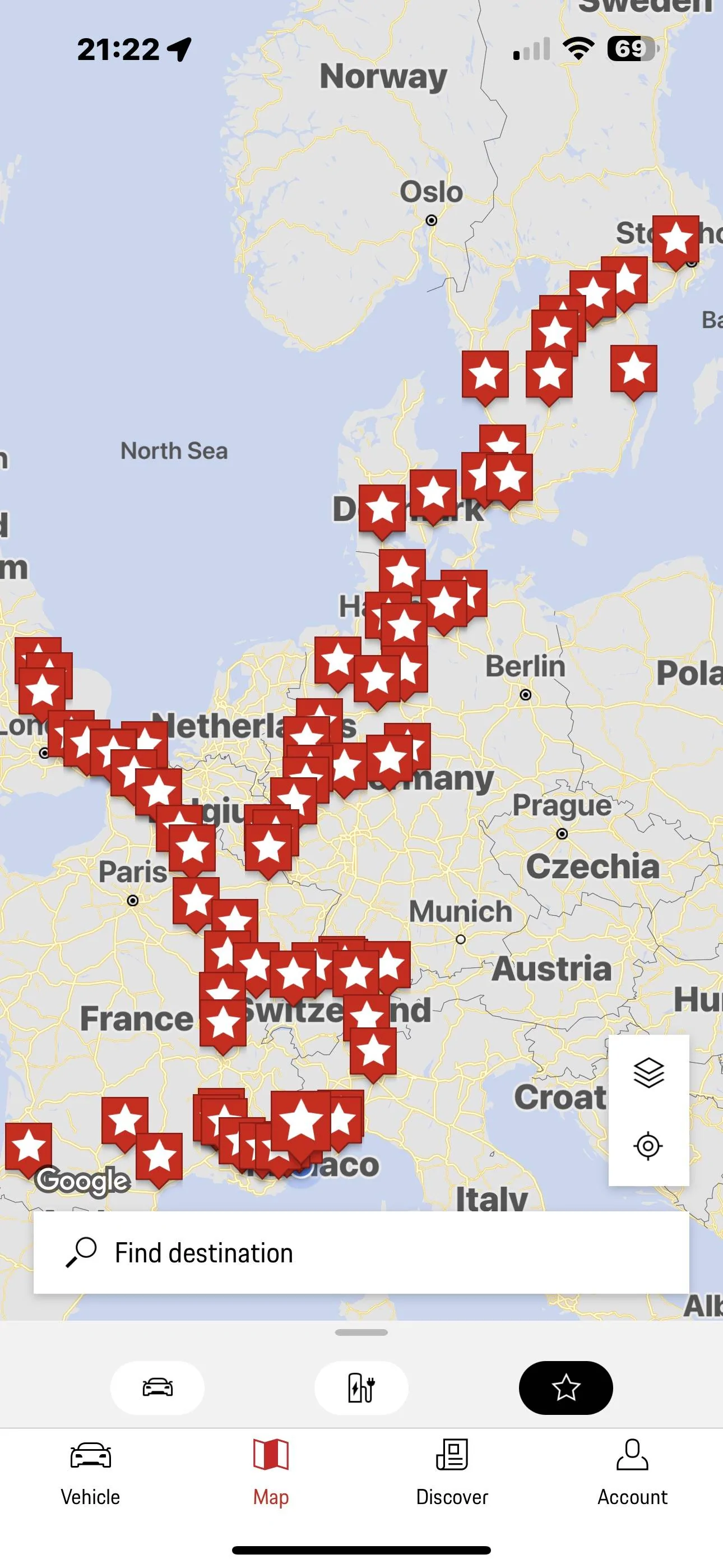

I actually saw today that you can filter the MyPorsche app to only show the Ionity stations. That could help out as well. It seems to work for me when looking for chargers, but when trying to plan a route in the app, it does not adhere to that filter?/ Why oh why?
Use the app and browse along and check the different stations and send them as favourites to your vehicle.

Yes, I did saw the same today seems to be the latest update.

Finding the right ionity through the Porsch nav sucks, I’m also struggling with it in germany. I use the nav app ABRP. This saves a lot of time.
Even easier now that you can set the Ionity filter in MyPorsche app. It only shows Ionity stations and when you zoom in you can see if it is in the direction you are travelling. Then simply send that destination to the car and also mark it as a favourite for future use.
