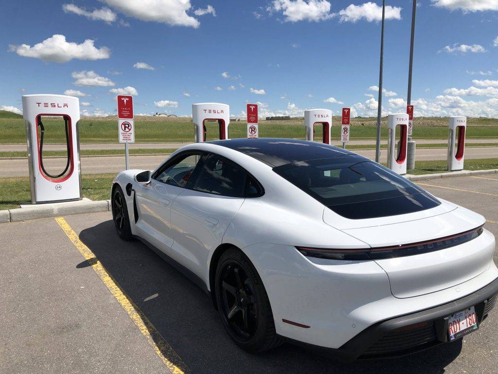

{sigh} - it's sad that all EV owners can't get along - I'll stomp out dis-information about Tesla on Porsche forums - but at the end of the day I'm customer of both companies and believe strongly EV's need to be part of the mix of personal transportation going forward…
the main reason superchargers are "patrolled" is to prevent the parking stalls from being taken up by gasoline cars - sometimes unknowingly and other times as a 'statement' from anti-EV enthusiasts - however I understand this can easily be mis-construed as Tesla tribalism…
we need a unified charging network - and there should not be different standards - Tesla should make a CCS adapter - and over time covert the supercharger network to CCS connectors - in Europe the connector is already the same and I believe it's a much easier task to eventually just make the stations work for any car willing to pay the charging fee's…
at the moment I would enjoy that because the supercharger network's reliability is much better than any of the other CCS charging networks and the competition would do everyone a little good…
but I'm not optimistic that will happen any time soon which makes me sad.
Both camps have pro's and con's and represent stepping stones in the EV evolution…

From my understanding of Tesla's SuperCharger architecture all of the "smarts" are in the car (i.e. allowed to supercharge, reporting time/duration for billing, etc.) so problem #1, its not a simple "change the plug" kind of operation. So either Tesla has to document the "in car" spec and a certification program, including some minimum hardware which manufacturers will take years to implement, or they have to do significant SuperCharger upgrades to pull intelligence back into the SuperCharger (i.e. add touch screen and phone controls, add card swipes/NFC support, etc.). Problem #2 is adding support resources to handle calls from drivers of other manufacturers vehicles when something isn't working, resources to troubleshoot, etc. #1 and #2 together are a lot of work for minimal cash, complicates their infrastructure and slows down innovation as they have to wait for other manufacturers. Rule 1 in Elon's book is minimize external dependencies/shorten supply chain to zero.
Problem #3 is from the business side they have no incentive to give up a huge Tesla selling point, which is the widespread SuperCharger availability, reliability and charging speed vs everyone else.
At the end of the day its pretty much 3 strikes and it won't happen. Elon is building a business that happens to be good for the planet, rather than doing things that are good for the planet that just happen to be a business. Don't get the order confused :)
Best bet is for someone with a large existing footprint and a related business to get interested. Petro Canada has taken some steps here (brings in some business to their convenience stores), but now that the "corridor" is done the question will be do they continue rolling out to other locations and get to a usable density to get places other than coast to coast. And they have work to do yet on realizing the full potential of their charging infrastructure in all locations (they're supposed to be capable of 200 or 350 kW depending on location however Don was seeing 50 to less than 200 on his cross Canada trip I believe).

@MassDriver - I think you're correct - but the smarts are not "in the car" - they assume the car can contact the cloud - or the super charger can contact the cloud - and the whole thing is managed by having the car-plug identify the car, and then the car/network decide to let the charge proceed - they designed the system from day 1 to be "plug & pay/play" - i.e. the chargers are stupid, but backed by a cloud service that controls charging
the assume the car has a fairly common but fully functional PC grade computer with software that can be easily modified, updated, and maintained vs. the more lock it down early and minimize the computer cost approach of existing supply chains - each Tesla has effectively a Linus grade computer running a general purpose OS with fairly open and modern software platform - so they can easily implement apps with a full time internet connect to do cloud based things that are beyond the planning capabilities of existing car manufactures…so the smarts are as you say "not in the charger" - but rather it's a distributed system that relies on specific nodes communicating with a master cloud service to controls the charging network in this case…
yes vendors would need to have their car be able to interact with the superchargers - but the technical details are subordinate to business agreement - i.e. if there was a business agreement the technical issues would be solved, quickly, easily - as it's just a matter of engineering which is fairly straight forward vs. the egos & business case which is more elusive…
at the end of the day it's all just electricity - DC electricity to boot - so we know it can be done - the fact that the physics are the same and the technical issues really are not that complex - it's actually a tragedy that the businesses are so myopic that they are not engaging on the correct solution…
fast chargers should work for all EV's - period - end of story - anything less is unacceptable - and technical difference can be overcome - at the moment both sides are pursuing a plan that some how than can have an advantage, when in fact the advantage would be everyone to be on the same playing field so that EV adoption at scale could be accelerated…
there is equal blame on both sides of this current artificial technical chasm to go around…so please don't claim I'm an Elon Fan boy or Porsche apologist - they can make it work if they wanted to - right now they perceived it's in their best interest not to pursue it - when in fact for their customers it would be better if it all just worked…
I agree, but we are making progress. While it may seem slow and painful while we are in it, in product-evolution terms I think things are moving right along. Already the first big conflict - CHAdeMO vs the upstart CCS - has mostly been put to rest, with the death knell being Nissan's announcement this month about the Ariya. Also, Tesla is starting to use CCS natively in certain markets, and dieselgate has provided for unprecedented investment in infrastructure. I think the next domino to fall will be CCS Plug and Charge adoption following the IEC/ISO 15118 standard. Once that's in place, the move to consolidate on CCS should pick up even more momentum. Of course, China's relatively new ChaoJi standard adds yet another obstacle.
taycantom
Oct 18, 2018
85
90
PDX
2018 Tesla Model X, 2020 Taycan 4S+
That was very poor form for the article's author to simply leave his car in the Supercharger spot while he went to the mall. It's not actually a matter of "sacred real estate" where only Teslas may trod - it would have been equally poor form if it was a Tesla parked there and not charging.
