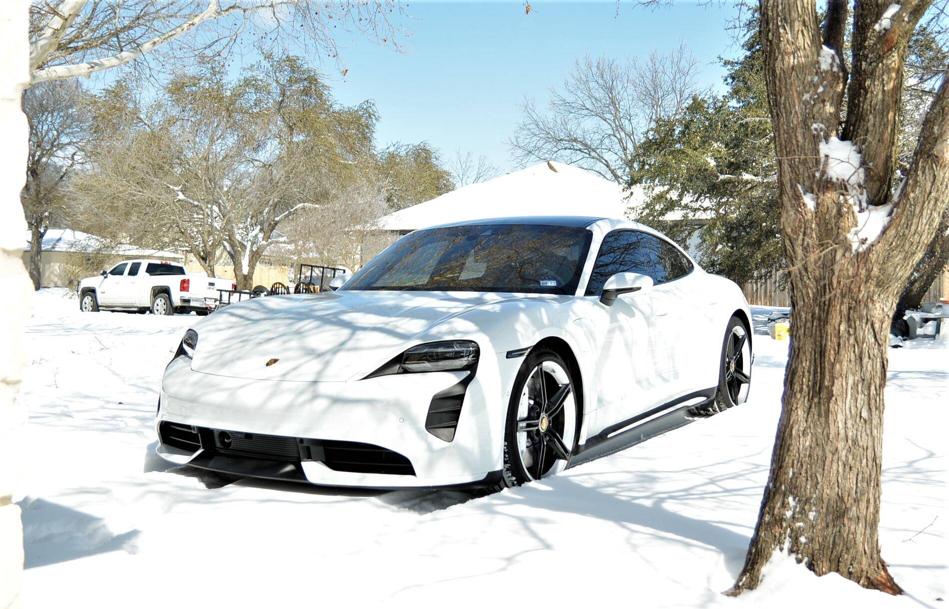

Same shot as posted in the location thread, but with better editing.
