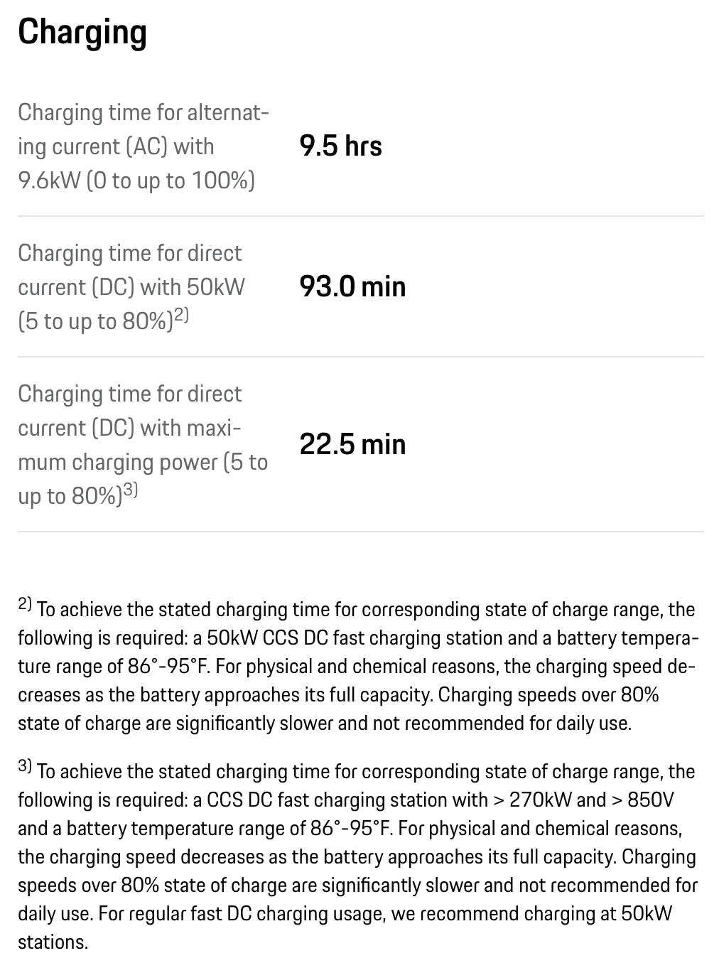

calculation of charging time is straight forward and easy
you take the charging rate (kW - kiloWatts)
and you take the capacity you are attempting to provide (kWh - kiloWatt Hours)
you divide the capacity(kWh) by rate(kW) - and you're left with "hours" as a result of the math
example
84 kWh (Taycan's 'usable' capacity) - this would be pretty close to a 3% to 100% charge session
9.6 kW (any NEMA 14-50/6-50 40 amp EVSE)
84 kWh / 9.6 kW = 8.75 hours
charging is not 100% efficient - so we add a "fudge" factor of about 6-10%
with a 10% fudge factor you end up with 9.625 hours - so let's call it 9.5 hours for an "empty" to "full" charge session at 9.6 kw (40 amps @ 240V)
Porsche apparently agrees with my Math (or do I agree with theirs?) - the table below is from porscheusa.com website - Taycan - Technical details section…
Porsche Taycan Porsche Wall Charger Connect | Unbox & Install 02F1723D-6BA3-4A21-80C8-59D4560A01F4
you can repeat this process for any charge rate and come close enough as to not matter, in that the math will predict the charge time +/- 10-20 minutes - other factors (such as Porsche's charging software taking breaks for 3-7 minutes mid charge which it will in fact do) can not be predicted or factored in - but I believe +/- 15 min accuracy is more than good enough as a predictor for L2 charging
