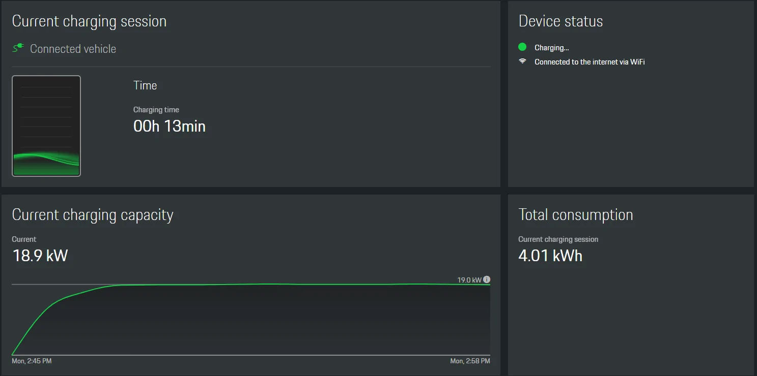

I installed a Porsche Wall Charger Connect some time ago in anticipation of the arrival of my new Taycan. The car was delivered on 7 May. Also like a number of other folks I had the dreaded certificate not valid error. Nothing I did would clear the error. I'm happy to report that they finally released a new version of the software. I had to manually download it and install it from one of my computers, but now the error is cleared.

I just installed my PWCC and am also having the same "certificate not valid" error.
How did you manage to manually download the new software and install it?
I put the steps I used in the other thread. Let me know if they work out for you.

@gnop1950 Congratualtions on the new Taycan and PWCC.
IMHO ‘dreaded’ is a bit of an exaggeration if the unit is still functional, per anecdotes on the other thread. People shouldn’t panic if they see this error on the PWCC. Annoying, yes. Catastrophe, no.
I experienced this same error when I first fired up my PWCC after installation in November 2021. In my case it resolved itself with a power cycle at the circuit breaker IIRC. At the time, I immediately checked for an update, but my unit had apparently shipped with what was and still is the latest version for the PWCC.
I assume there is only a single hardware version of the PWCC to date. My unit’s software version is at v6022 as of today.
