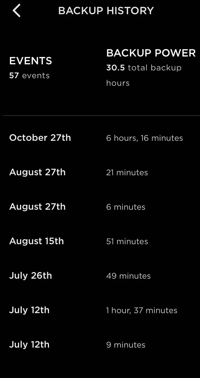

here is the backup history of my Santa Cruz Powerwall system…57 “grid outages“ in two years - totalling 30.5 hours of “offline” - in each case the powerwalls stepped in and the powerwall gateway cut off the home from the grid, and allowed my solar panels and batteries to continue to power the home during the outage…my wife LOVES it -and in particullar last year during thanksgiving day the system bridged a 4 hour outage while we had the entire familiy to our home for thankgiving dinner - there was ZERO interruption thanks to the Solar and the Powerwalls…
sign me UP if I could use my Taycan’s 93 kWh battery as part of this system, but I’m not holding my breath and Porsche would need to release software for both the vehicle and the vehicle charger to allow power to be backfed, and communicate with the home power management system.
I look foward to the day- but that day is not today.

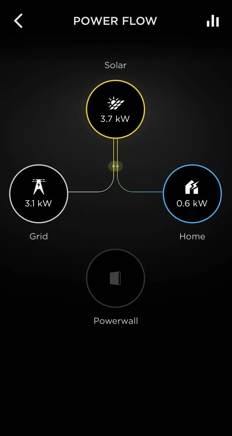

here is the visulization of the powerwall’s master control computer for your home - note the “idle” powerwall at the bottom on the picture - if the grid drops offline - the powerwall gateway computer will isolate the ”grid” and allow the the battery to “feed” the home along with the solar - it also allows the solar to “charge” the battery if the home’s demand is less than the production - excess solar is automatically redirected to charge the batteries - allowing the system to run indefinately for many days as long as the day time solar production can charge the battery from overnight usage…adding a EV battery as a potential alternative power source would be beyond awesome!!!
even including smarts to charge the EV battery during the day when there is excess solar
the possibilities are enticing, but I’m aware of very few systems that have the total picture in mind and are on their way to market in such a manner than people could actually install it in their home…
again I reference the confusion/angst caused by people simply trying to understand how they are going to charge their EV at home, and that doesn’t require redesiging their home’s entire electrical system, just adding a 240V 50 amp circuit…

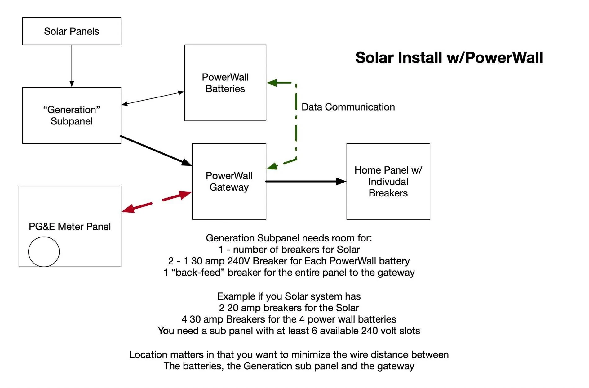

here is a simplified diagram of a home self back up system - you could put any EV in to this picture on the generator side of this diagram if the vehicle’s software and charging infrastructure supported back feeding…which most do not as of this writing…you would add the “car” next to the Powerwall battery’s in this diagram - but you still need a communcation channel “to the car” for the Powerwall Gateway - tell the car to switch on/off as the home demands go up/down…
we lack a standard “gateway” specification - so at the moment systems like this require a lot of vertical integration - all made by the same manufacturer…the Porsche Powermanager available in europe is intriguing to me…but Porsche still has a long ways to go…
the red arrow in this diagram is the “key” element (between the PG&E meter panel) and the Powerwall gateway - this connection can be severed in less than 5 miliseconds by the gateway (relay switch) which instantly turns the home into a “micro-grid” with dual power sources (solar & batteries) and the gateway can direct power from either source to the home’s main breaker panel…
my wife’s coffer maker keeps working and she doesn’t care where the power comes from - and honestly doesn’t even notice when we’re off grid…
