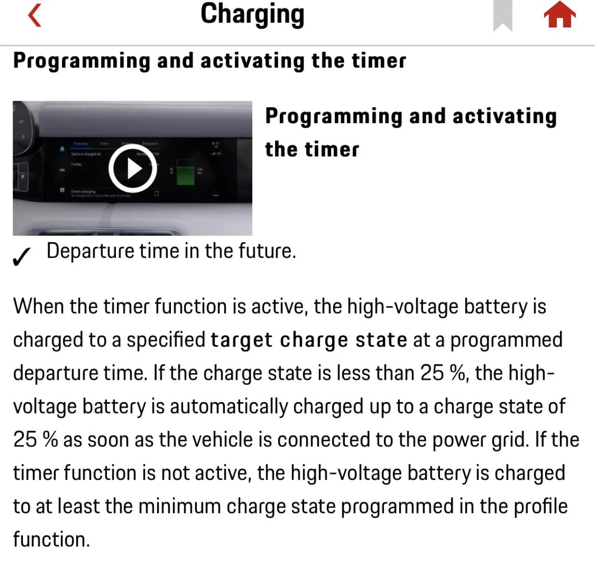

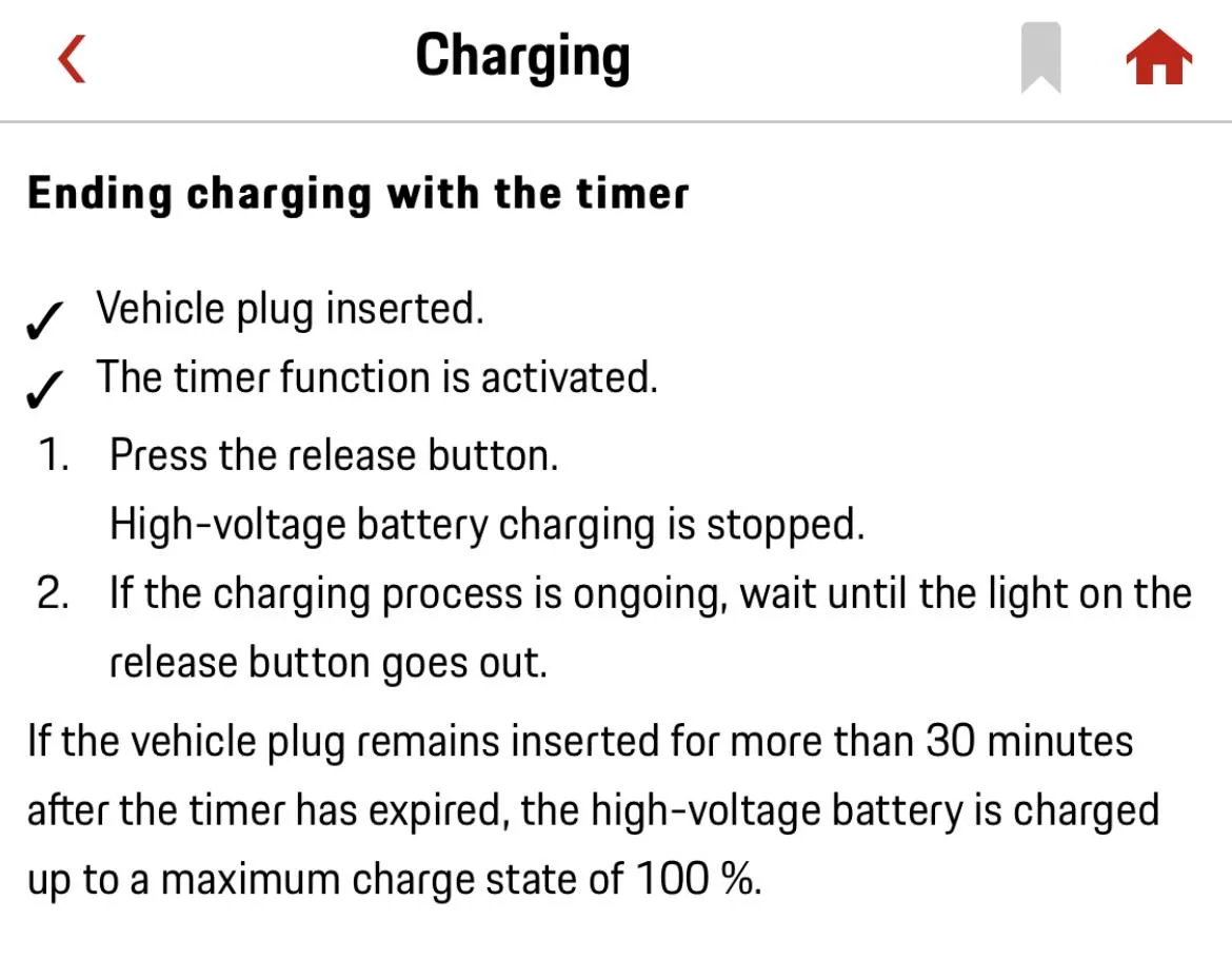

Is the timer repeating or not? If you don’t have a profile and the timer is non-repeating, the car will continue charging to 100% 30 min after the departure time has expired.
The alternative is to set a profile for 25%. This shouldn’t affect the timer because the car would charge to a 25% min right away with the timer anyway.

Thanks. I did not know about the 30 minute point. That seems to be what it did. It stopped with the timer at the target charge but I was on a work call and so it then started up again to get to 100% (presumably 30 minutes later). I like the sound of a Home profile at 25% preferred times between 2AM-7AM coupled with a 7AM daily 80% timer. I will try that. I guess the only thing that doesn't pick up is if I use an AC charger away from home (at like a Chargepoint at a supermarket). Then I guess I just hit the Direct Charging button. Thanks all.

Reference for 30 min expiration below:
Porsche Taycan Profile/Timer Interaction 3957DBAE-9548-4064-B84F-6FB2EEB04F17
And 25% timer min:
Porsche Taycan Profile/Timer Interaction A9A3F6BA-DFBF-497A-A618-7276EA3D953C

30 min rule - this doesn't happen in practice - I've left mine in for hours and it doesn't continue to charge. I believe the subtlety here is that if you press the release button and don't remove the cable then the 30 min override kicks in (poor English in the PGTKA).
