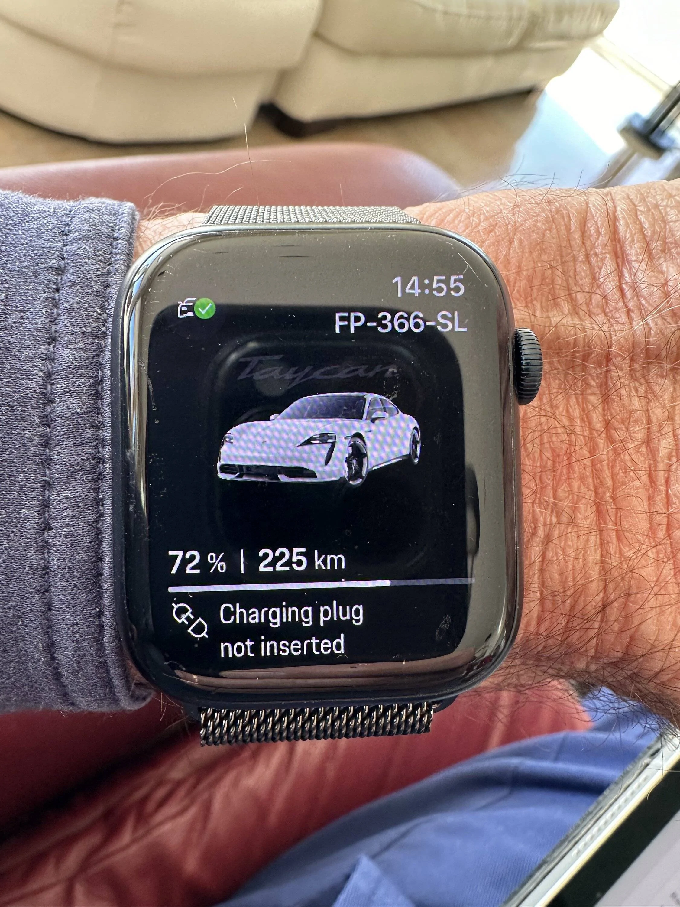

Depends on if you like a snapshot from your Apple Watch that is 300 km out in odometer and completely wrong on charge level etc.
Here is my Apple Watch shot today
Porsche Taycan PSA: Do not trust the latest MyPorsche app IMG_1329
As you can see that is Just Updated!!!!!

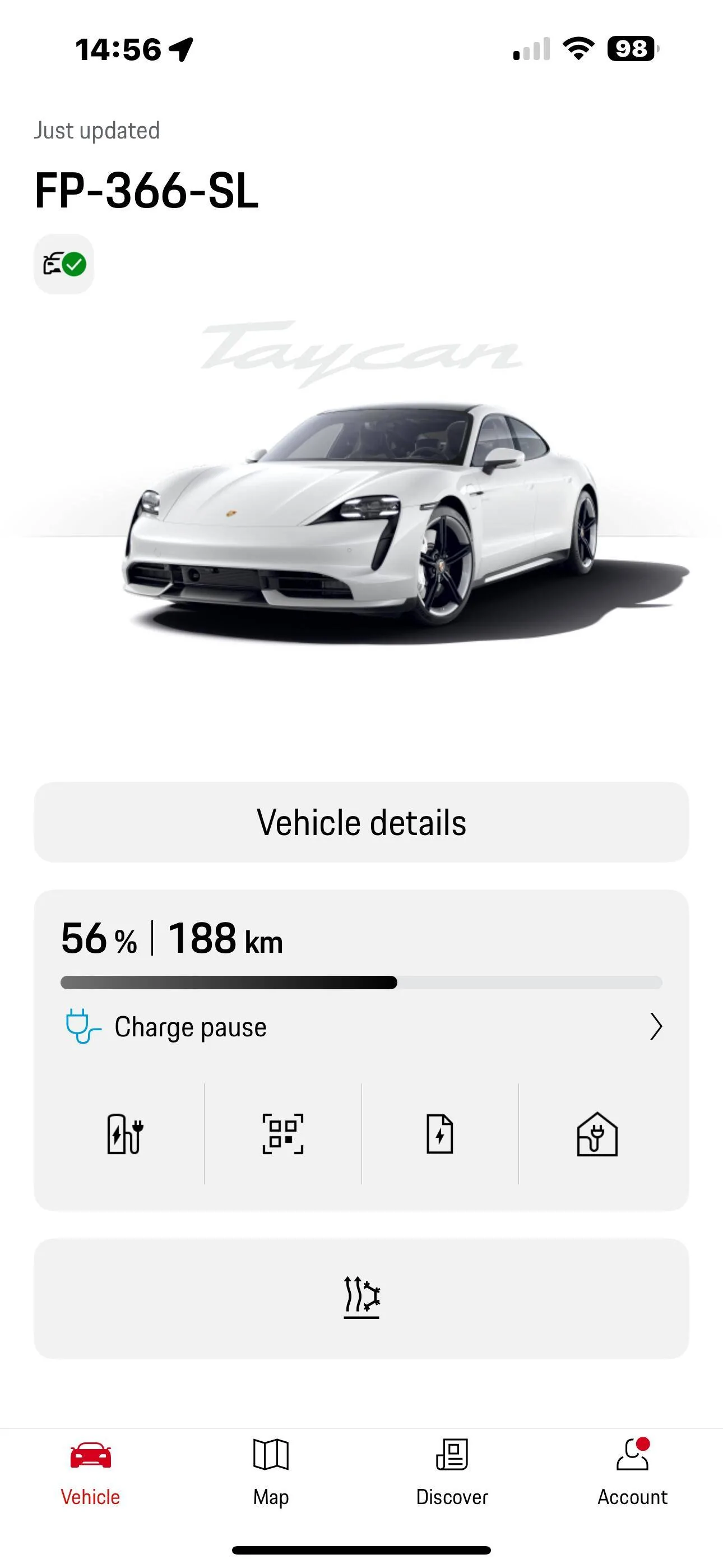

And here is the screenshot from the app at the same minute .
Porsche Taycan PSA: Do not trust the latest MyPorsche app IMG_1330
Not even that can they manage!
56% vs 72%?
188km vs 225km?
Details, details, ....
But hey, the image of your Taycan on that watch is great!
If the apps are correct, your Taycan lost 16% of battery in one minute. How fast does a Taycan have to drive to use the entire battery up in ~6 minutes? ;)
