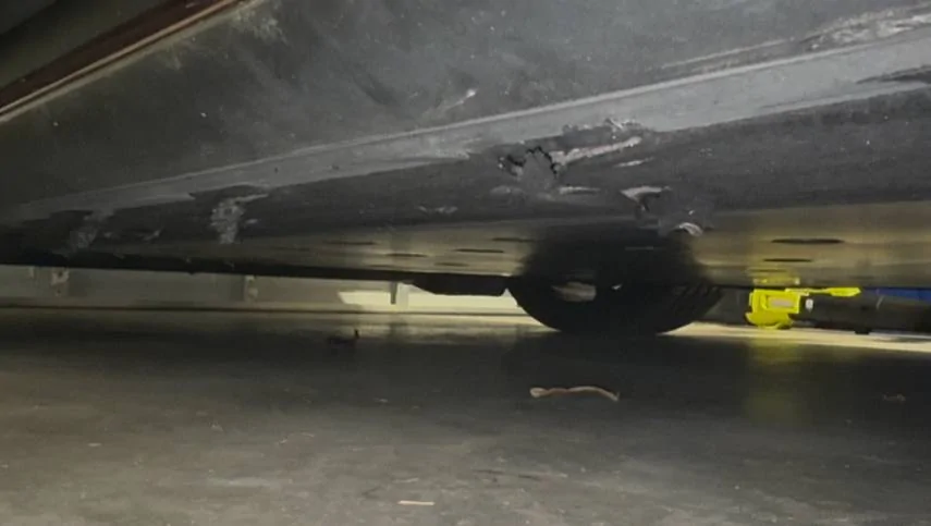

I still buy from and recommend CarMax, but they will sell cars with obvious damage unless it is documented frame/flood damage. They will not reveal any of their findings other than in the price as compared to like-for-like cars (not a lot of data for Taycans).
You can push them to do a full inspection, or have your own independent inspection (preferred) at which point they will likely work to perform work for you if serious issues are found. Otherwise you have the return policy. A typical dealership would have no problem foisting an issue like this off on a customer.
Take the car in to a trusted Porsche mechanic (with EV experience) and have it looked at. If you're not comfortable with any level of damage, return. There is ALWAYS another car out there for you. Pretty luck to have the option of a do-over!

Looks like someone routinely drove over a spot that they were too low to clear. I'm with the Don't Panic camp until you get it evaluated and see whether this is cosmetic or structural.
If you like the car, have them work with you to get everything ship shape.

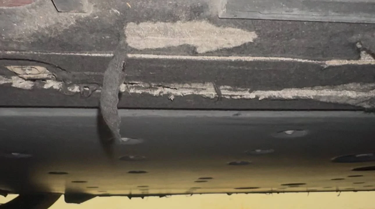

Agree, it doesn't even look like the battery pack itself is scratched... only the layer of noise insulation on the sides.

I keep follwing this topic since this morning and I was thinking the same. Based on what I see and what I know about the Taycan sub frame, damages are located on the side layer which is a $100 piece. Not a big deal. I would bring the car to a dealer, have it inspected and get a quote to replace this piece.

I just purchased this 2021 taycan turbo from CarMax yesterday. Today I saw material/fabric hanging from the bottom of the car so I looked under it and looks like it’s scratched up even has a few holes. Are these holes something to worry about, if water gets in there will there be any damage? Is this normal wear and tear for the Taycan ? The car was sold to me with no stated issues or accidents/damage and it passed all the CarMax inspections and went through reconditioning. The rest of the car is in great condition.
Ouch. If the battery is damaged, it can cost you as much as what you paid for the car. I think it's bad enough that Porsche can also void warranty on anything battery related. I would 100% return it if you can. How much did you pay for it btw?

You should take it to a Porsche dealership for battery damage inspection so that you’re not left holding the bag when they deny a battery related warranty.

Loo,ks like the battery cover maybe affected. If so expensive to replace and more importantly water can get into the batteries. Porsche did have to fix a number of battery covers by installing a new adhesive to keep water out. However, if there is that much damage they may deny the warranty
