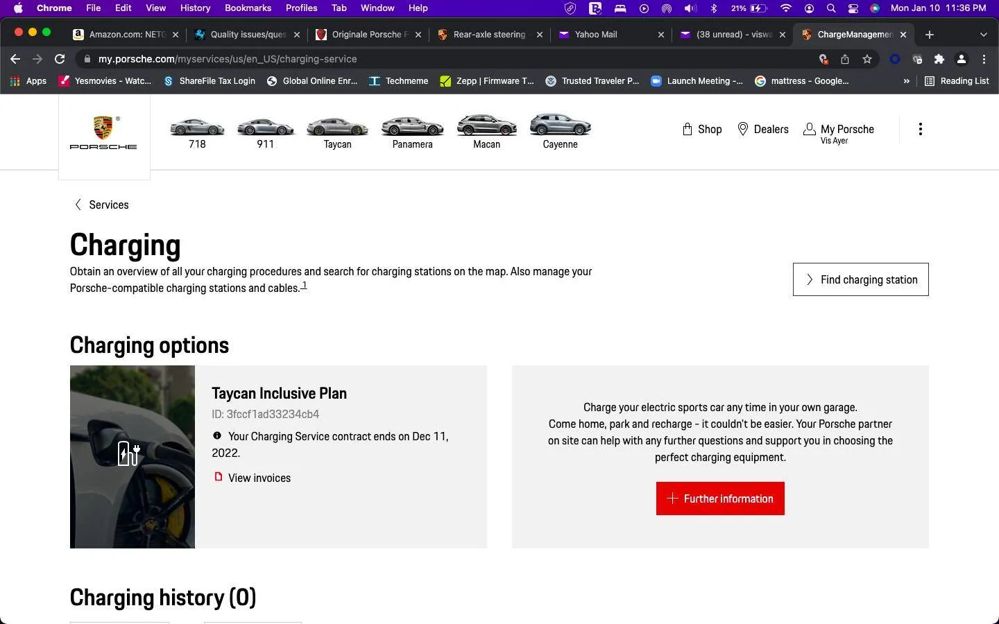

I updated my post to suggest you check that you've activated the 3 Years free charging on Electrify America. That might be a pre-req.
I think it was done. I see my contract being active for a year only. Read somewhere in the forum the contract needs to be reactivated for year 2 and 3.
Let me know what you find out at the dealer. I’m very curious now.

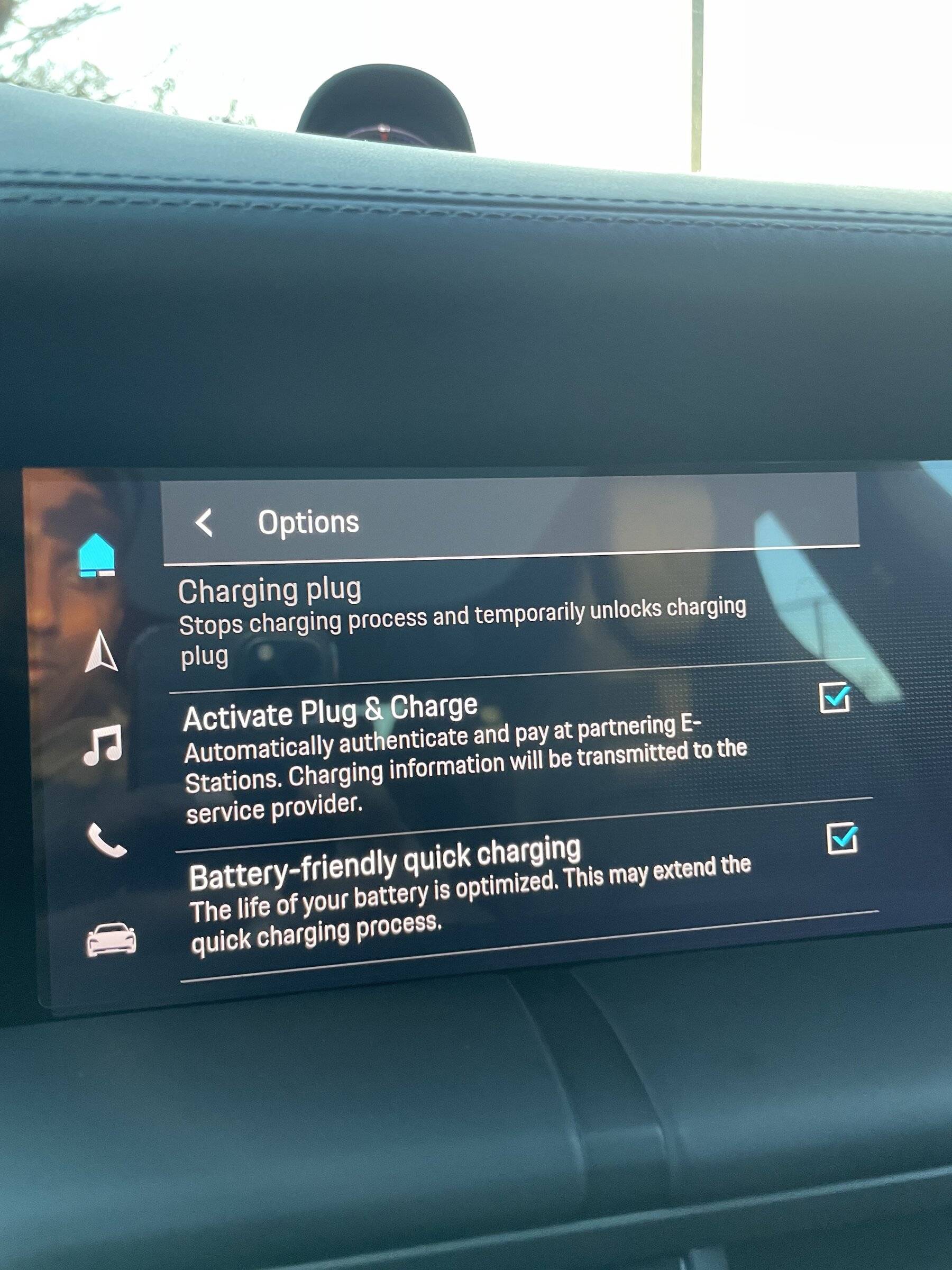

Some of the forum members with MY22 have reported seeing the options on PCM for plug and charge. Wondering why we are not seeing it, software bug?. I did try charing at nearby EA charger and all seemed to work fine. My SA advise is if all works ok, dont bring the car in,..who knows
I did factory reset per Porsche CS and there it was plug and charge..Glad didnt have to take my car to the dealership :). Hope the restart didnt break anything else. Also shout out to Porsche CS, the person I was working for the past month was following up regularly even though I gave up several days ago

I did factory reset per Porsche CS and there it was plug and charge..Glad didnt have to take my car to the dealership :). Hope the restart didnt break anything else. Also shout out too Porsche CS, the person I was working for the past month was following up regularly even though I gave up several days ago
Well yahoo!
Out of curiosity, how do you initiate a Reset?
