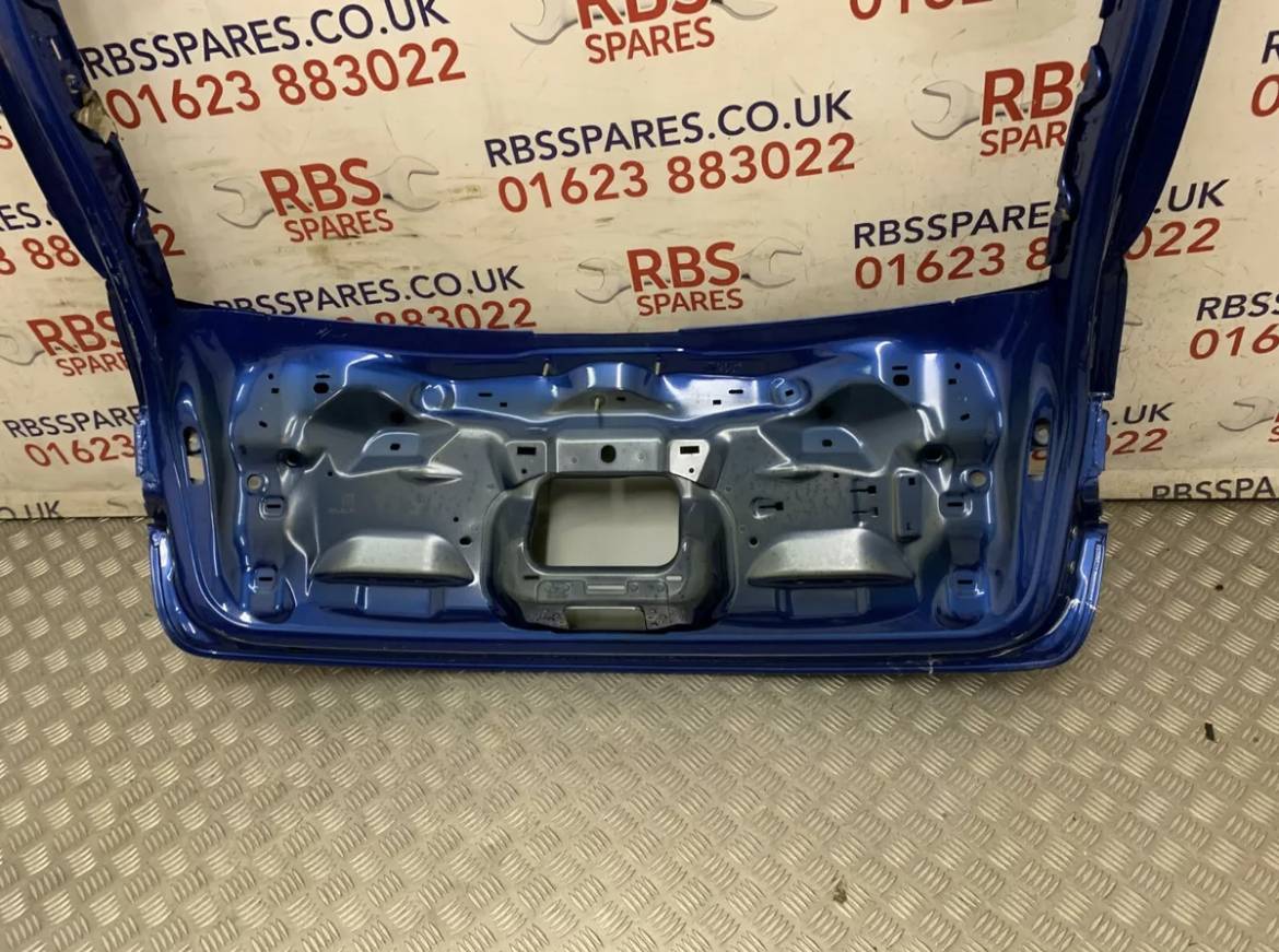

The tailgate will definitely be sealed around where the rear windscreen is glued on, so the glass you can hear should all be inside the interior trim, and maybe a very small amount inside the cavity areas of the tailgate where you would be able to get the hoover nozzle - see attached pic of a macan tailgate (I couldn’t find any Taycan ones)
