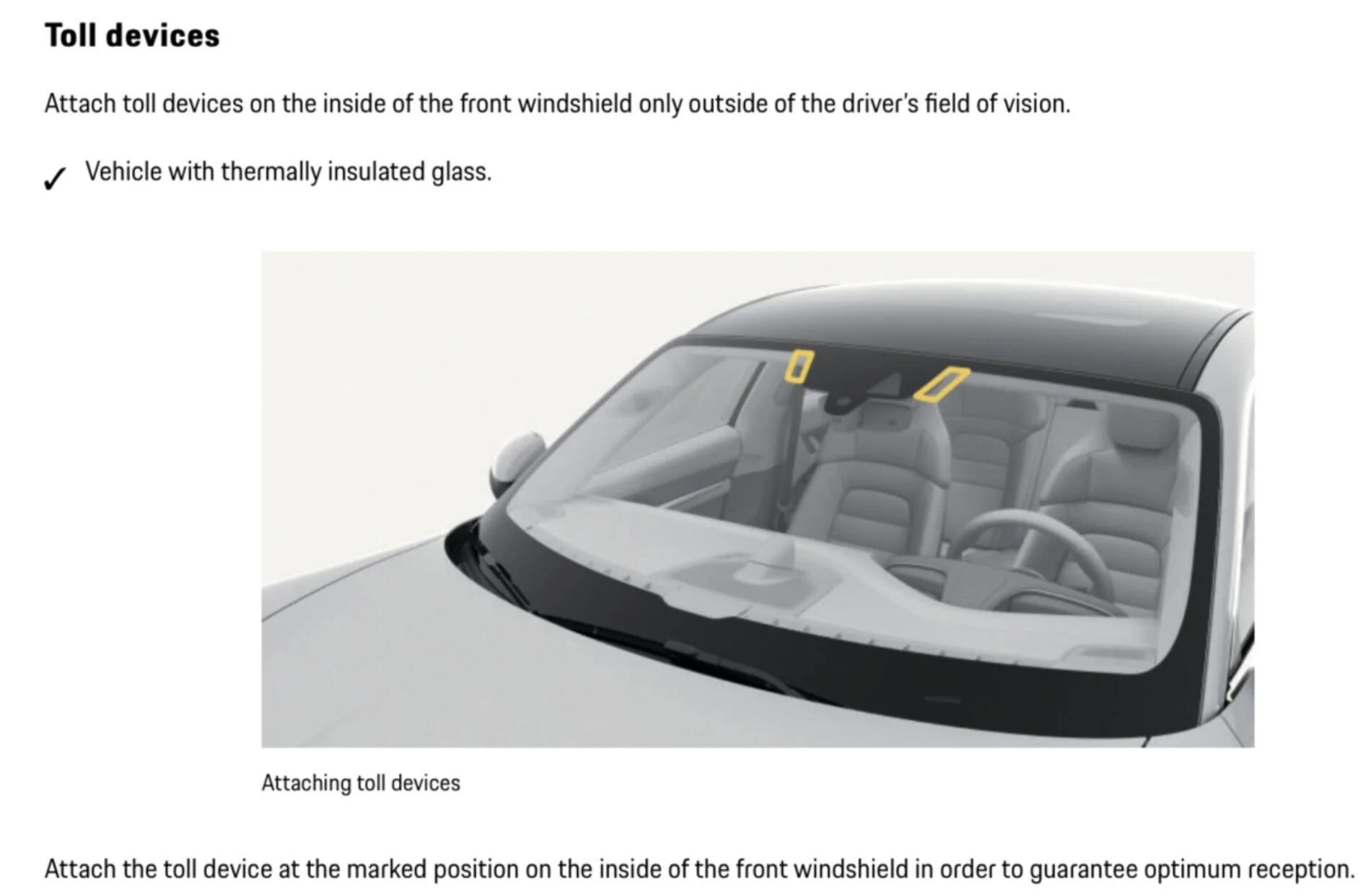

With the amount of interest in posts on the @artdept thread on "Taycan / Porsche must have accessories?" related to Radar & Laster Detectors with the Sound and Thermally Insulated glass both prompted me to create a thread specific to this topic and investigate further by reaching out to "Rocky Mountain Radar" in El Paso TX. They promptly returned a response.
Unfortunately the glass will reduce the performance of the detector for both laser and radar significantly.
Yes the forward detection will work but at a very reduced range.
So if such a detector is a key element to your vehicle you may want to refrain from the Sound & Thermally Insulated Glass option.
Note that with the glass there are two locations to use devices like Toll devices next to the rear view mirror but it is a narrow area.
Porsche Taycan Radar / Laser Detectors with Sound Thermally Insulated Glass 1583431553149

I took the time to actually measure the radar transmission quality of the thermal glass in my dealer's demo Taycan Turbo using a portable radar source and an Agilent microwave power meter.
On K-band, the effect was a loss of 23 dB (200:1). Pretty terrible for radar reception. I expect X-band and Ka-band to be similar.
Too bad that Porsche didn't use AGP as their glass vendor like Tesla switched to in the AP2-hardware update. It uses ceramic technology that has no effect on RF telematics (radar, EZ-Pass, cell phones, etc.) while providing equivalent solar rejection to the metal-film competitors.
One might get away with positioning a detector very high and tight to the rearview mirror on the driver's side where the film cut-out is placed. I experimented with positioning a V1 and the radar antenna was masked by the black dot pattern (OK for radar) with a clear spot in just the right place to not block the laser sensor. Radar antenna positioned in the film cutout and laser clear of the black masking. Might be worth a try.
I had some conversations with the Porsche tech center in Atlanta that indicated the rear window did not have any metal film because they were using the defroster wire pattern to receive radio stations in a similar way to the Panamera hatch glass.
The side windows also have metallic film that might make direction finding with a V1 a little spooky by blocking signals coming from the side of the car, but might work just fine with only the rear window receiving signals aft of center.
My Taycan Turbo won't have the insulated glass, so I'm not motivated to experiment much further.

Driver's side as high and tight to the windshield as possible. Needs the V1Gen2 forward facing antenna lens bulge to align with the pretty obvious (from outside) film cut-out area.
The suction mount may barely work with the small cups that are already installed on the mount. A 3rd-party sticky-tape permanent mount that uses the frame of the suction mount might allow more "tightness" flexibility.
The cutout in the metal film is higher than it is wide, so it should be plenty possible to get the detector level and find an arrangement that "sees" through it. You'll have to do some imagining to determine where the right spot is because one can't see through all the obscuration perfectly.
