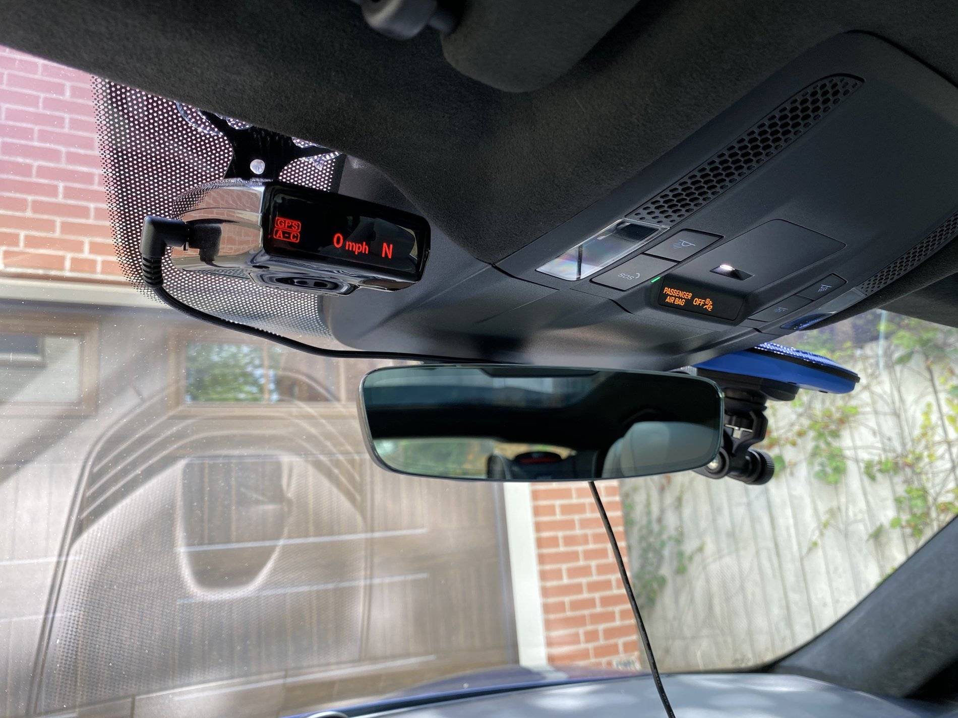

Today I played around with performance testing which means I needed to mount my VBox in the windshield. Prime time to play around a bit as it's got a very sensitive GPS antenna. It was like turning a light switch on and off... moving the VBox outside the window vs. in the windshield space next to the door. The shaded areas next to the mirror though worked perfectly. So I moved my windshield mounted radar detector to one side and the VBox to the other. For those needing a picture, here's where it works. And my radar detector is much more chatty now. I do not really have the gear to figure out how much is still getting blocked but I was picking up police cars at a pretty good distance so it's better than it was.
Porsche Taycan Radar / Laser Detectors with Sound Thermally Insulated Glass IMG_4428

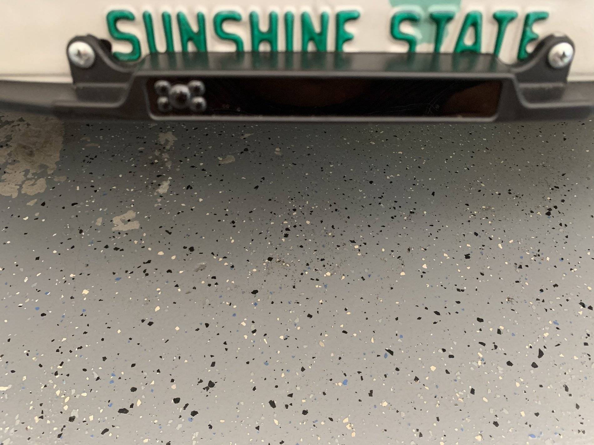

Here you go, whilst there’s lots of debate on capability, the latest model seems fairly effective from recent experience!! Obviously it’s hard Installed.
Sorry, I am having a difficult time seeing how/where your license plate is located (this is the front, correct)? Is there any way you can take a photo further back from the car?
Miwa
Oct 3, 2019
825
856
Bay Area, CA, USA
I'd guess that's the rear plate, the front sensors can be seen in the bottom corners of the first pic

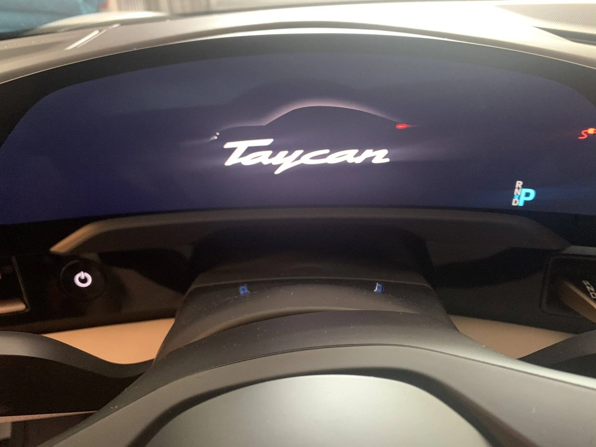

Has anyone done a Rodenso/AL Priority custom install? I'm trying to figure out where to place the "remote" display unit and button controls without it
Its hidden behind the dash, two blue LED lights installed in top of steering column indicate direction, all alerts are voice and tone, with a remote for mute, config etc...I did not want anything to be in sight.
Keith, can you please post a picture of where you had the LED lights installed?

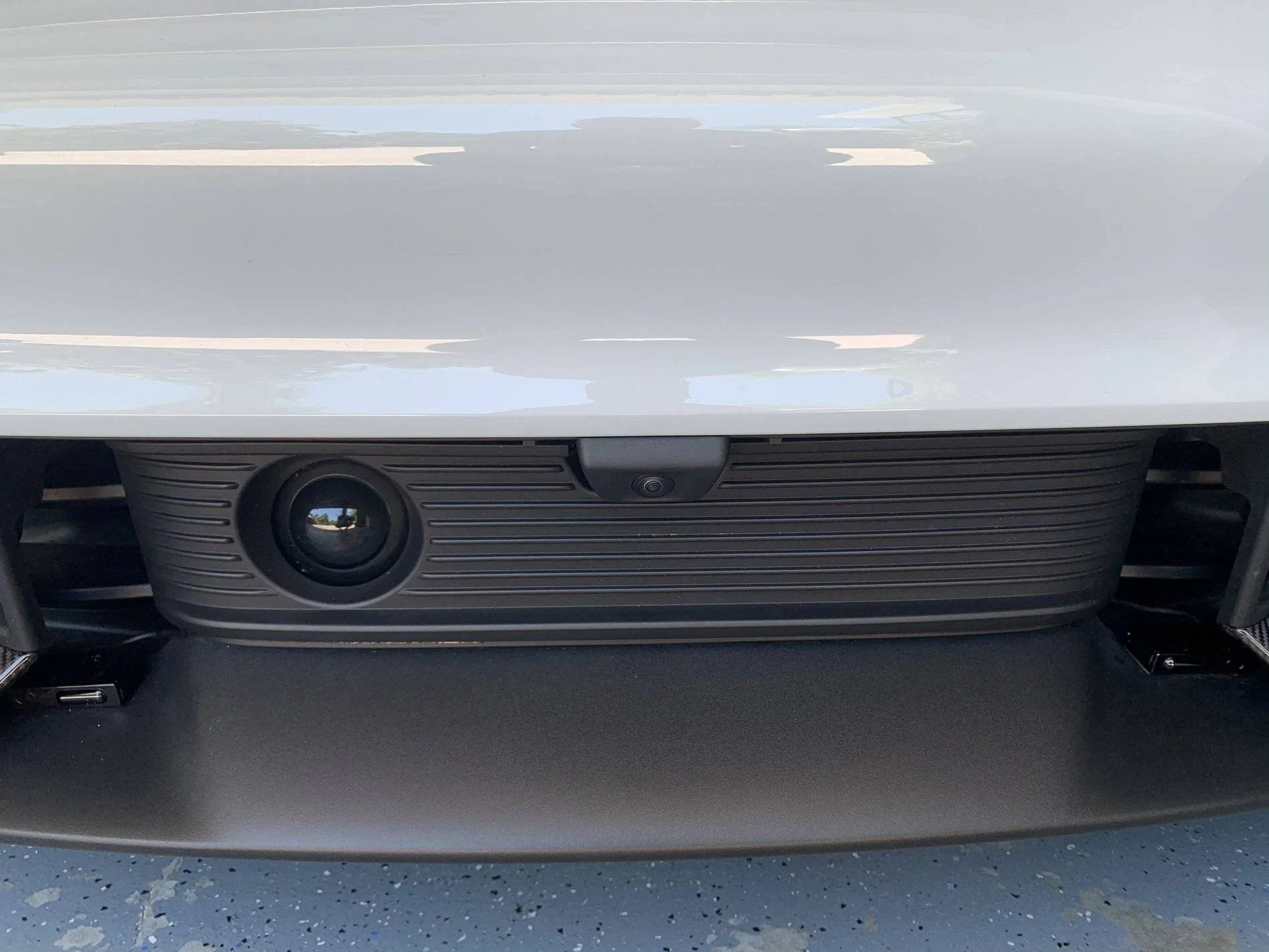

This is my planned configuration too. I need to get out there and measure some things to see how this would work. The TX heads have a minimum height from the ground that could be problematic.
Yes, the TX sensor has to be 21" above ground - so can't do the TX on the front - maybe the rear. David, where are you thinking of putting the interior display unit and controls?
Yes Standby..
Thats correct in FL no front plate :)
Porsche Taycan Radar / Laser Detectors with Sound Thermally Insulated Glass 459B9F2E-429D-4FFB-9509-886C35CDE372
