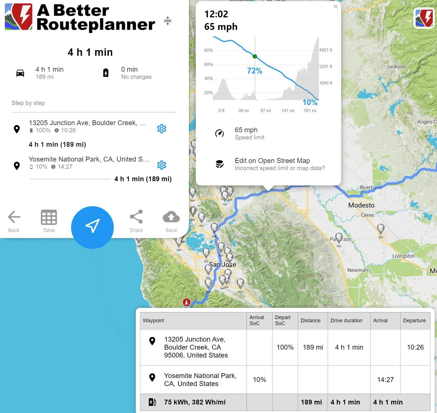

https://abetterrouteplanner.com/
here you can play a bit with you uphill route and check the range. it's topology aware. Also check with your Model S range if that fit's with their calculations.

A Better Route Planner turns the 3 hour MS drive into a 5 -1/2 hour drive with a detour for a 40 minute charge and limits my speed to 55 for the last 3 hr 20 minutes. But it also adds an hour to the MS trip, takes the same detour and a charge stop. So BRP generates pure rubbish.
