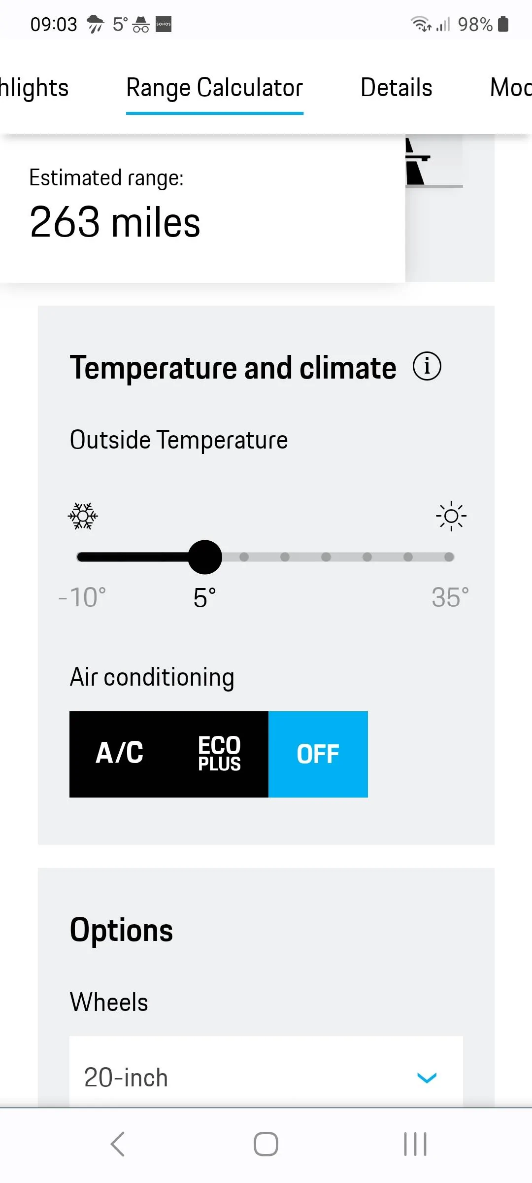

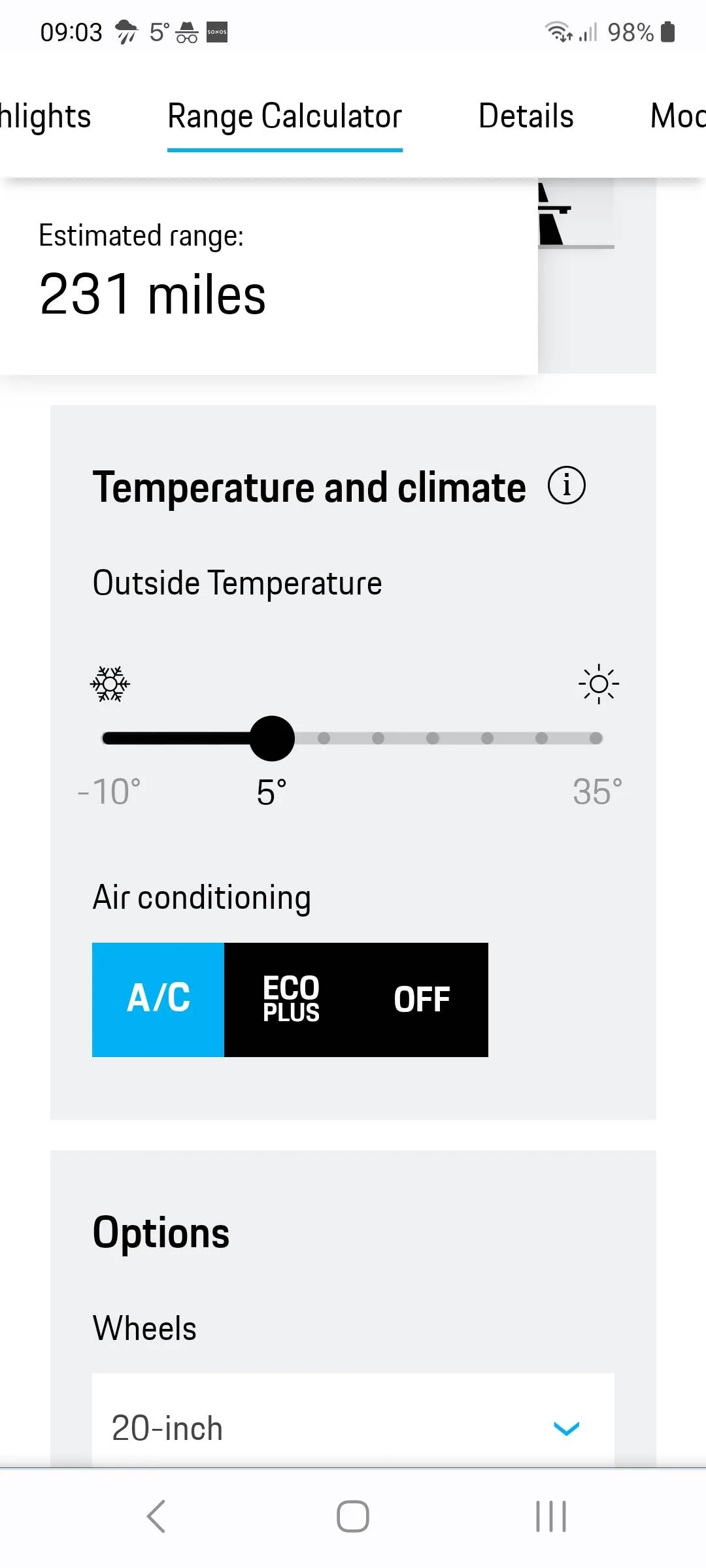

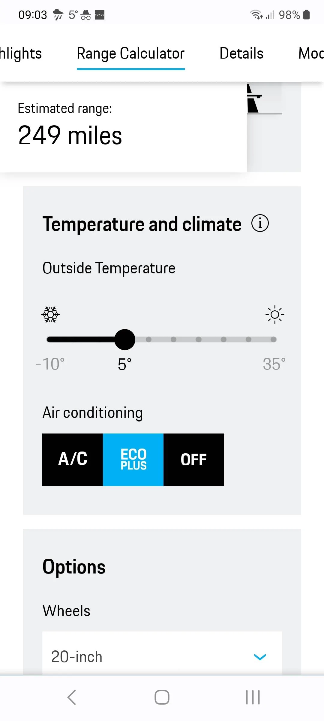

I have just done the 3 different a/c settings for my RWD PB+ with my typical driving / 20 wheels / 5c
Porsche Taycan Range Estimate + Route in Nav = Total Inaccuracy Screenshot_20230115_090318_Chrome
Porsche Taycan Range Estimate + Route in Nav = Total Inaccuracy Screenshot_20230115_090312_Chrome
Porsche Taycan Range Estimate + Route in Nav = Total Inaccuracy Screenshot_20230115_090306_Chrome

I think the range estimator on the site is comparing between normal AC and eco plus. Eco plus can only be activated in range mode and does make a big difference in range but also in cooling and heating. With eco setting the range difference IRL is much less.
3,679
6,269
I don’t remember and can’t be bothered to look for it again on the site - if it still exists.
I haven’t done a rigorous scientific test but the miles per kWh in the My Porsche report are consistently better since I went to A/C Eco.
I have left it there.
