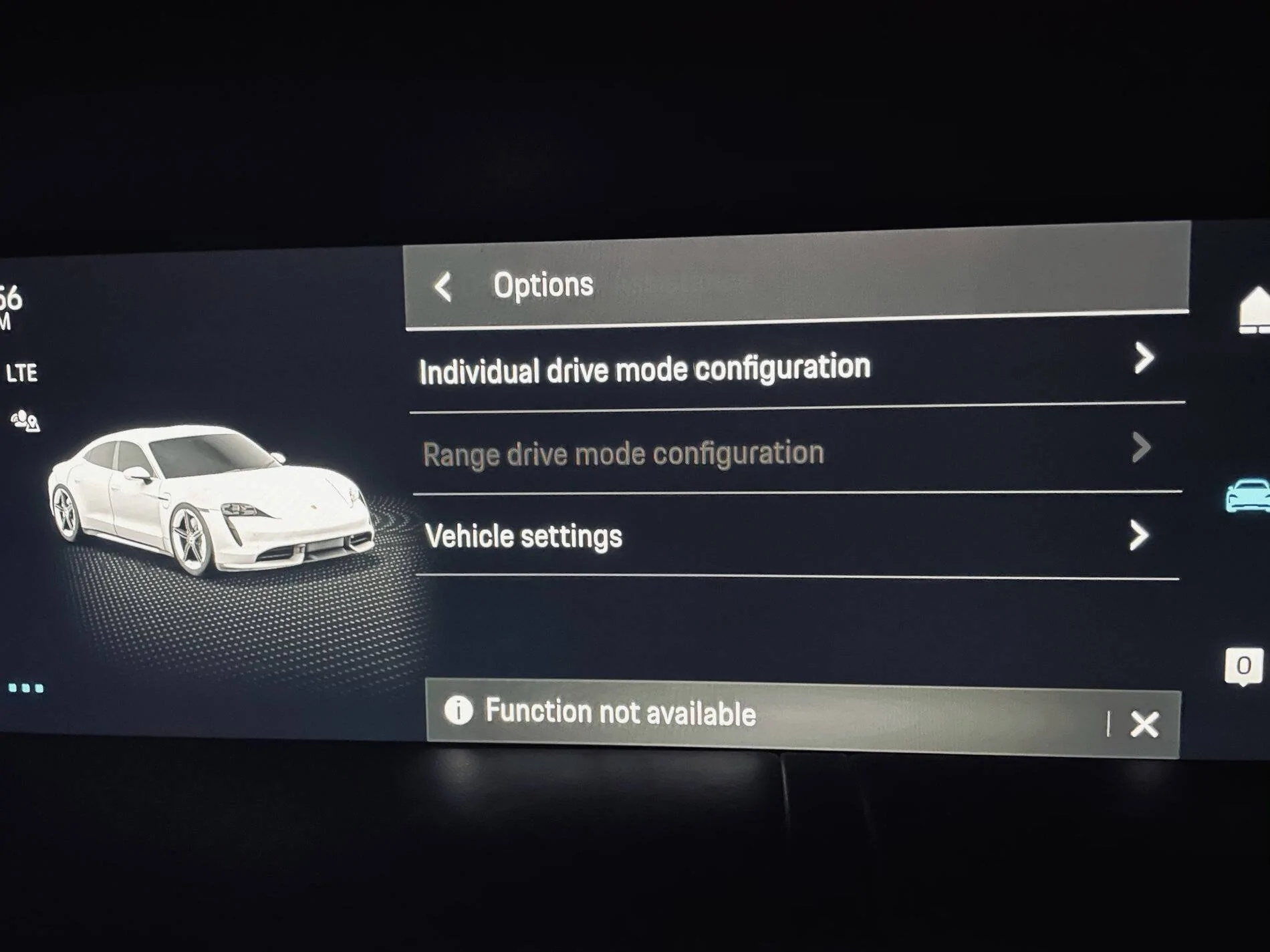

It's been reported on here before but I thought due to last nights reoccurrence on my car, it warranted a new post.
Going back 2 1/2 months ago or so, I used range mode quite a bit and I had set the max speed to 75mph. All was good until one day I switched over to range mode (travelling around 70) and all of a sudden the car started slowing down (kind of like braking). Thankfully there was no one behind me and I quickly realised range mode was reporting a max speed of 55mph! As soon as I switched back to Normal mode, the car started behaving normally again. Back then, this issue randomly occurred around 6ish times during a 2 week window. My dealer did look at my car, but sadly to no avail.
All has been fine for the last 10 weeks or so, until last night on my way home I discovered the range mode issue had reappeared. This morning on the way to work, range mode was fine again!
This is what I've found.
  • The issue is random, it doesn't happen for every journey.
  • This issue only limits the car to 55. All other aspects of the car are fine i.e. accelerating, braking, PCM etc.
  • I suspect this issue is due to range mode not properly loading upon start-up. Reason for this is because when the issue occurs, I'm unable to access the settings for Range mode. The settings are greyed out and when I press on them, it comes back with Function not available (see pic). In addition, I believe 55mph is the default speed range mode is configured for.
  • I have not experienced range mode operating fine on a journey and then suddenly defaulting to 55.
  • The issue doesn't go away until the car has been turned off for sometime.
  • The issue only affects range mode, switching back to any other mode removes the speed limit.
  • While in range mode, I discovered you can press heavily down on the throttle peddle (which still overrides the speed limit). As soon as you completely release the throttle, the car will drop back to 55.
As mentioned, my dealer wasn't able to give any insight. My car is going in soon for some new door cards (rattle issue) and I'll mention it to them again.

How many profiles/Porsche Accounts have you added? Do you use the same key every time? The key is connected to an account and the corresponding profile is loaded "from the cloud", but perhaps there is some fallback to the key if a profile can't be loaded via LTE. If so, perhaps each key has a slightly different fallback?
I've just got one user profile and I always use the same key. The other key is spare and never used.

So this happened to me today. My range mode is limited to 55 mph max and the "Range Drive Mode Configuration" doesn't even appear in the menu, even when I switch to range mode.
On the bright side, I've yet to see any data that range mode actually gives significant efficiency gains. I'm pretty sure you can drive in Sport w/ suspension Low and AC on Eco with about the same efficiency. Maybe a slight loss, .5 to 1 kWh/100 mi, in my experience.
I had this happen once before, at the same time (coincidentally, or as a result of) the consumption info in the trip computer was zeroed out for some reason. Changing the consumption from mi/kWh to kWh/100 mi may or may not have made the problem go away.
