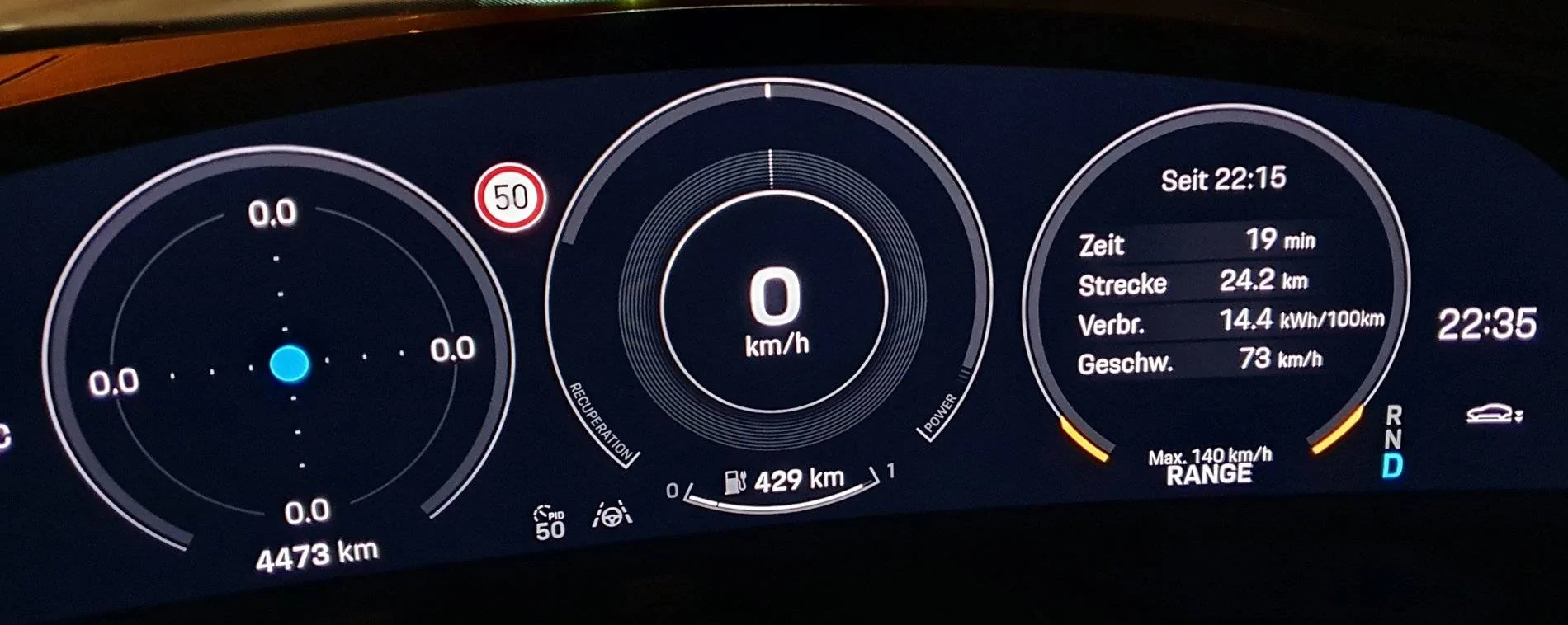

Hello,
here is what you can get at when hypermiling in range mode. This is boring kind of driving on my "Local Loop" in Munich, i.e. starting and finishing at 0km/h at the same spot, almost no traffic lights (1?), going almost exclusively over motorways and roads-leading-to-motorways, up and down a mini bridge a little bit, some turns, sometimes going a bit faster (85 km/h) to maintain an average of 75km/h. In the end, the average dropped to 73, but only due to the final kilometer's speedlimit.
Result: 14.4 kWh/100 km equivalent to 23.2 kWh/100 miles.
OAT 19° C, night time (= lights on), very little wind, air conditioner off.
Cheers,
Henrik
PS: Does anybody have a guess how much energy the lights consume? I.e. if I'd do the same Local Loop at daytime, how big would the effect be?
Porsche Taycan Range Mode? T4S_RangeMode_14.4kWh_20200704

Henrik @HK111 That's crazy good efficiency 4.3mi/kw at 46mph for such a heavy car with 20" wheels. That's like 388miles/625km on a charge. This reminds me of the old Tesla Bjorn (Nyland) videos where he drove like 27mph which is standard EV optimal efficiency all night :oops: .
I used to watch those when I was first getting the EV bug.
I meant to add that the headlights on my bolt are about 200 Watts and they are LED but not nearly as sophisticated as the portion ones
Looking at your distance and efficiency that would be 3.48kWh used and the lights for 19min would be 0.06kWh so less than 2%.

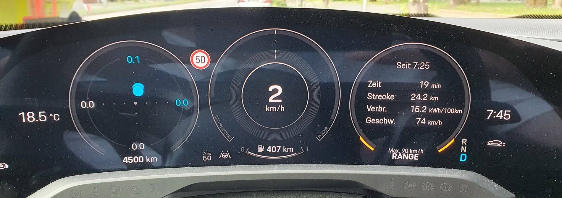

Hello there,
thanks Ron for the consumption numbers on the lights! The range numbers you gave are for nominal capacity of the battery, not the net capacity, right?
To verify the numbers from yesterday night, I drove the local loop again today. We had probably 17° C OAT, little wind, dry conditions, daylight, range mode, A/C off. Again, the goal was to get 75km/h on average, which required some stretches of doing 85km/h. I was lucky with the one traffic light - it turned green while I was rolling towards it.
Result: 15.2 kWh/100km equivalent to 24.5 kWh/100 miles or 4.1 miles per kWh.
For fun, I also drove the loop again in sport-mode and going as fast as legally possible (with a margin of +15 km/h).
Result: 31.5 kWh. If there were more stretches without speed limits, the consumption would have been more, of course.
Cheers,
Henrik
Porsche Taycan Range Mode? T4S_LocalLoop_15.2kWh_20200705

Hello there,
You are very welcome Henrik, I must live vicariously through your travels. :cool:
The total range was based on my estimate of 90kWh usable in the Taycan battery. This is based in recent videos I have seen in the last 3 or 4 months showing Porsche seems to have unlocked more battery than was the case in the September/October 2019 press runs.
