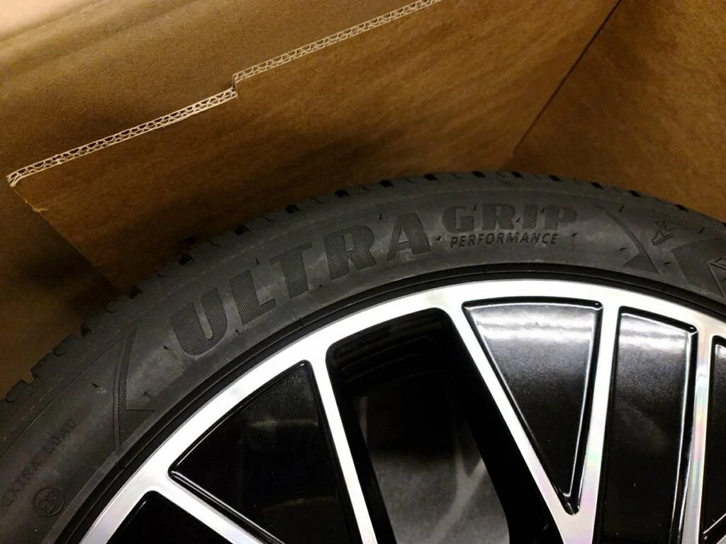

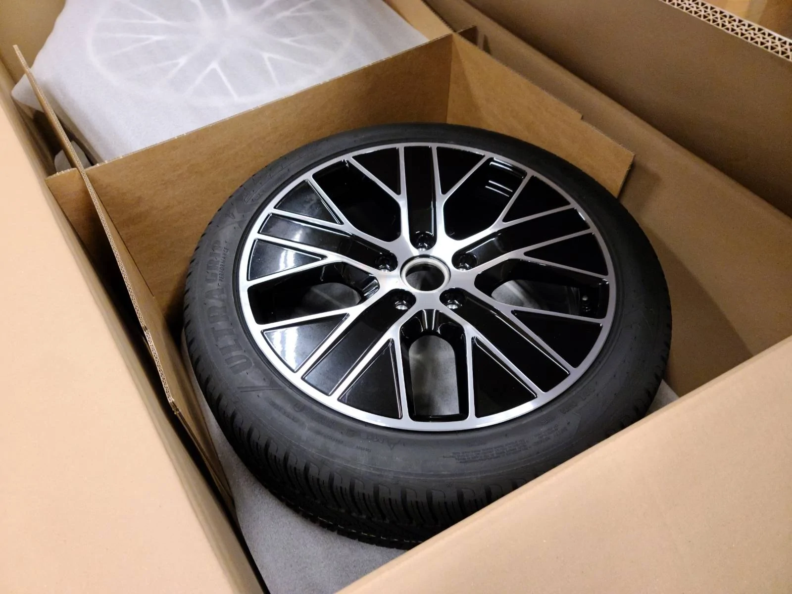

Ordered these from the dealer V.S. SunCoastParts as I like these (Turbo Aero) wheels. SunCoast does not list these on their website. Tires are new (I was told) Good Year Porsche spec tires.
