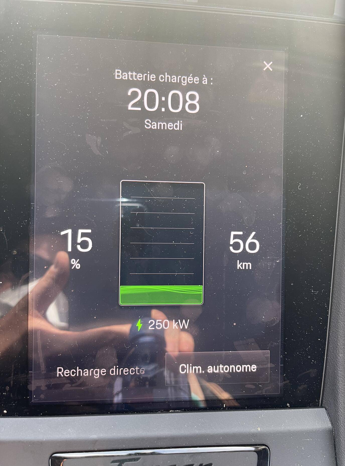

Porsche weren't kidding when they said Taycan can charge fast.... I got to 80% ish in 20 mins before I could even find a restaurant we liked.
I noticed:
  • the charging lightning icon turned green above a certain kW threshold.
  • starting battery temp was controlled by the navigation system at ~35C while cruising for couple hours.
  • ambient is ~25C.
  • battery temp got up pretty high (42C ish) fairly quickly but stayed controlled thanks to cooling system on right passenger corner radiators.
Porsche Taycan real world 250kW charging from past weekend road trip to LA IMG_1073

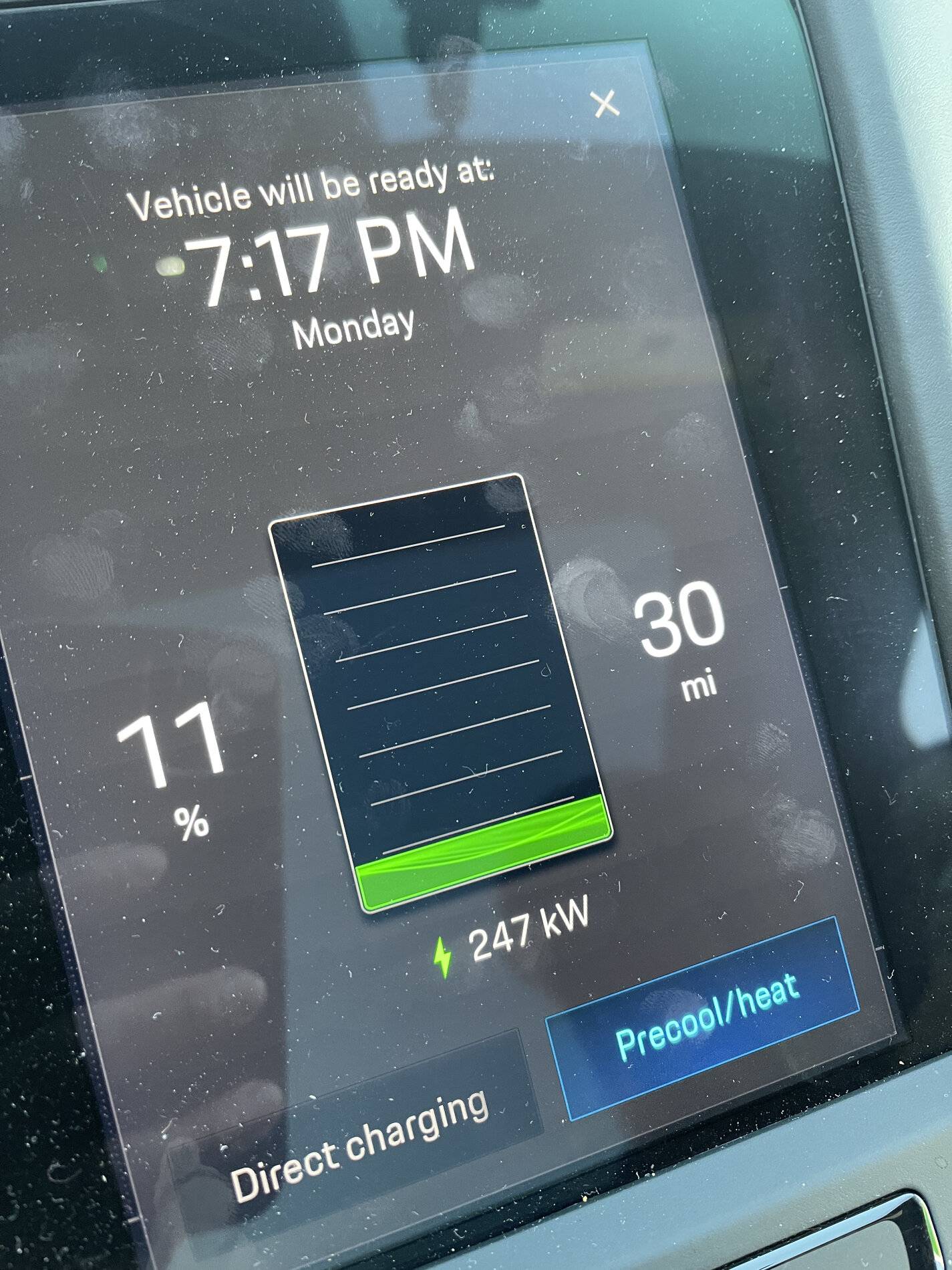

I drove to LA over the long Weeknd and agree on the fast charging.
Although the EA chargers (not Porsche fault) are still un-reliable as on my way back, the chargers (all of them) in Firebaugh area were non-functional and had to drive to Gilroy for the charge with mere 5% remaining. Not fun driving in a 100+ degree heat wave throttling the a/c to conserve power.
On my way to LA, the Bakersfield chargers (350KWh) was only outputting 78KW max rate. I had enough charge and was too lazy to call them as I had to call EA 3 times for charging related issues.
PS: EA customer service people are very polite/well trained even when dealing another angry customers due to the infrastructure issues.

Which charger was this that was outputting 250kW?
@BayAreaJay
yes I agree and also confirm several of the EA chargers don't charge as fast as advertised in my experience. Sometimes it's because our batteries isn't in optimal temperature (30-35C) or SOC (<20%). I also stopped by the Panoche EA station -- the 350kW station only provided 30kW. I didn't bother with EA customer service and just repositioned to the next spot (within Panoche station) and got much higher rates.
The 250kW station I got was in Paso Robles.

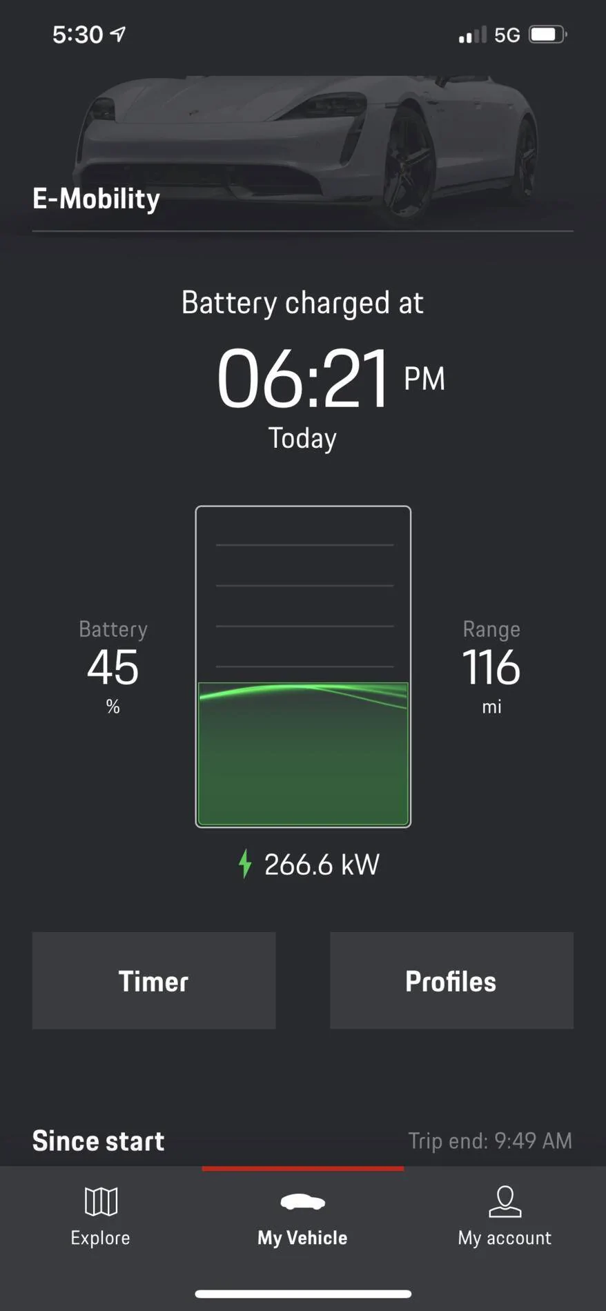

250KW ! it's too fast for me. I'm only 40Miles (70Km) away from home... I don't have enough time to get a picture ! I only use it for 5 minutes
coffee machine is way too slow ! and coffee is too hot
Porsche Taycan real world 250kW charging from past weekend road trip to LA Screenshot 2021-06-01 at 21.07.08
Deleted member 1697
Guest
the point is to know your consumption and the trip to stop to charge when you're 10% soc. and not to fill up
I'm trying to not fill up arriving at home / office and to let it under 30% as I don't expect to go on the highway
I still can't resist
