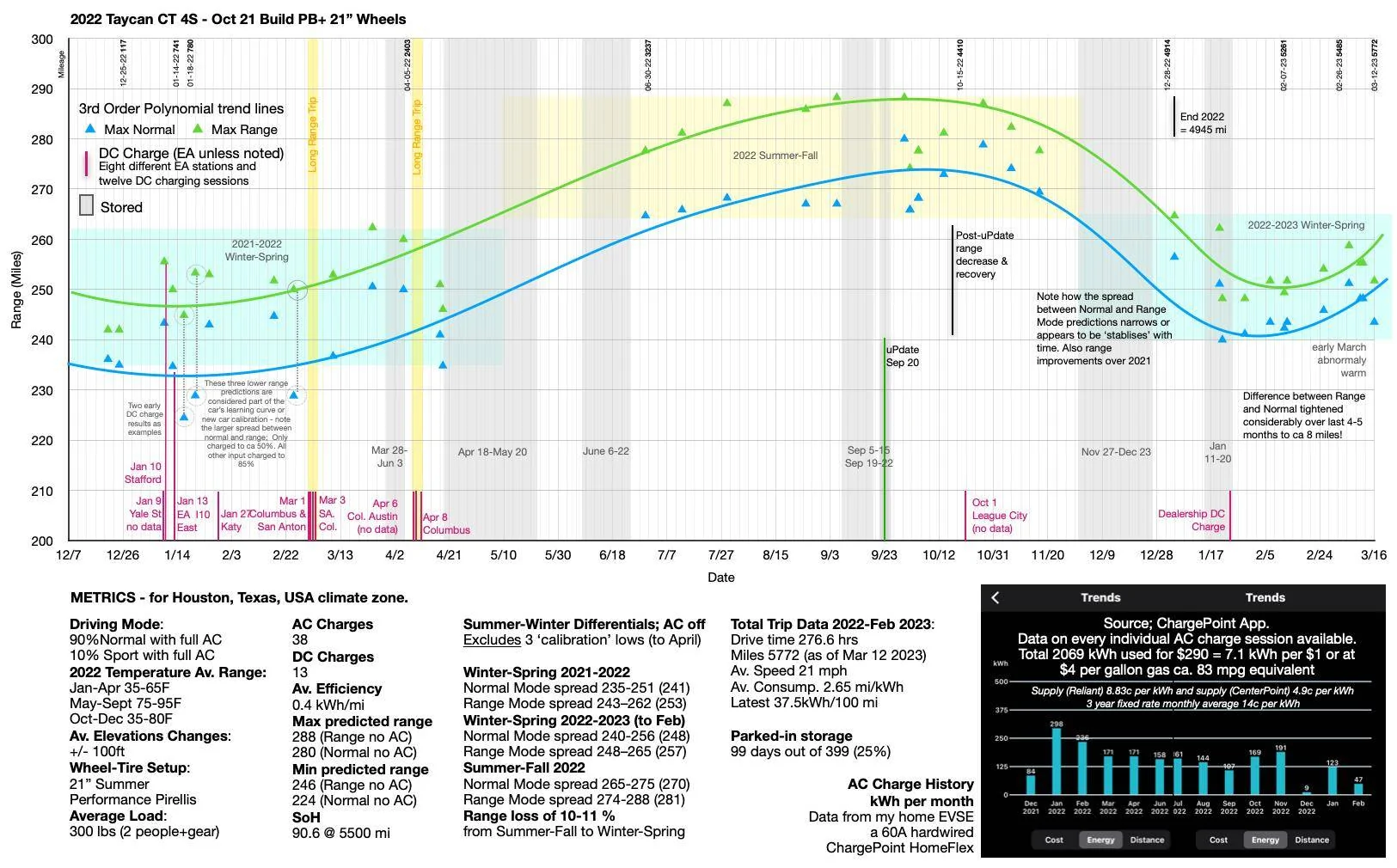

Posted this in a few threads (apologies for those seeing it yet again :)) but at least some actual data from my car over it's first year - have a lot more on real consumptive performance in the other dedicated threads on the forum (will add link when I get more time).
And for ref I drive constantly with AC, near 80-90% of the year, PB+ on 21" wheels and summer perf tires and do not baby the thing at all i.e. my driving style has not changed one bit from ICE to EV. Make the point as whilst of course these numbers are the car's 'predictive' ranges (with AC off), not true consumptive, they are being calculated from a driving style/record that is anything but conservative - thus if you drive more so presumably you'd get even better results.
Other proviso of course climate based etc.
