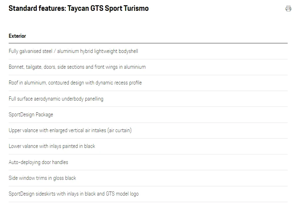

Oddly the GTS ST has the Sport Design pack as standard plus the side skirts and the configurator permits the addition of the rear cycle prep and rear cycle carrier. If you do the same on a non-GTS ST then its either the Sport Design pack OR rear cycle kit - BIZZARE!
Porsche Taycan Rear bicycle carrier apparently not available for ST 1651854054796
Still think the configurator / logic is flaky.

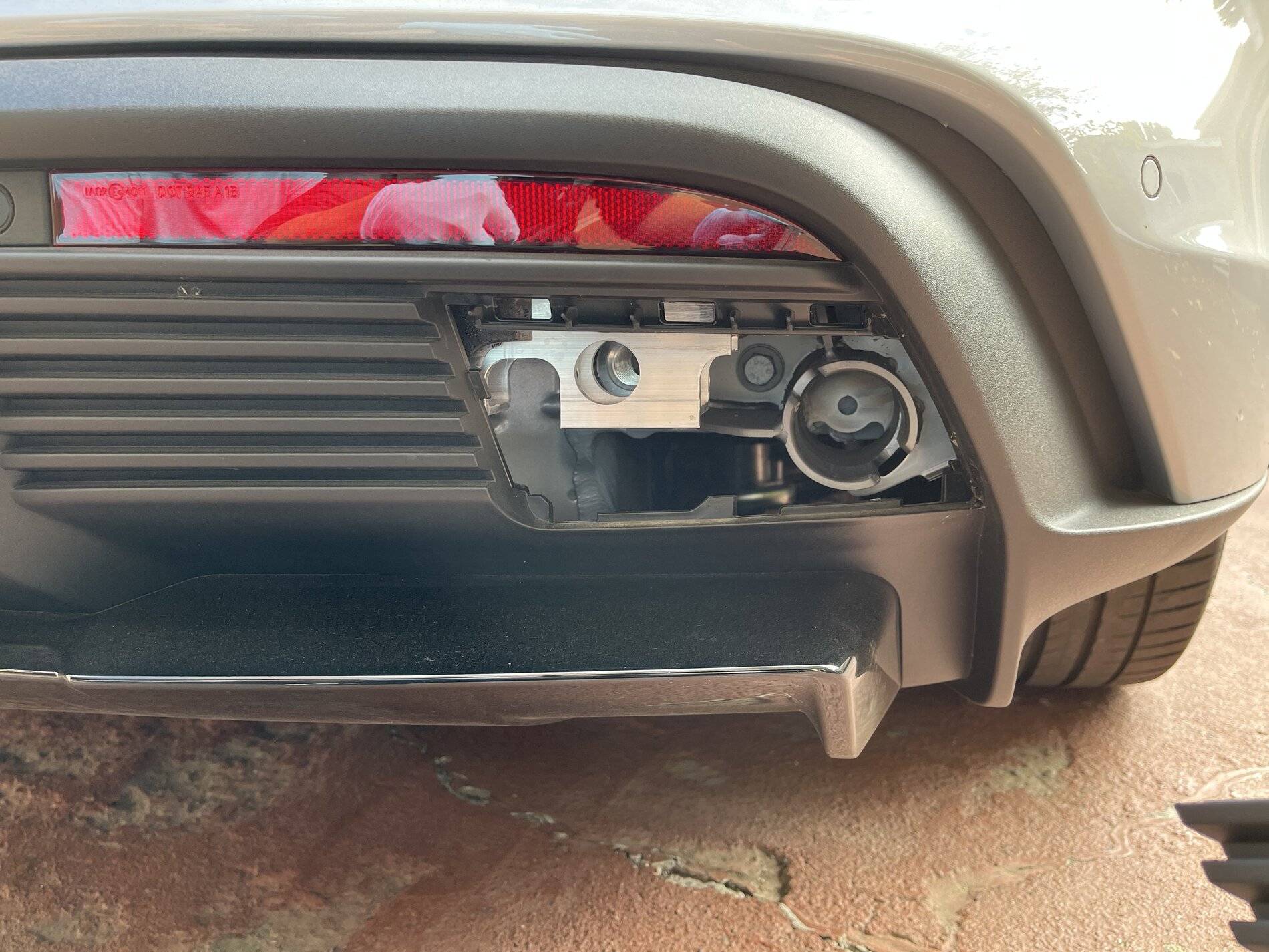

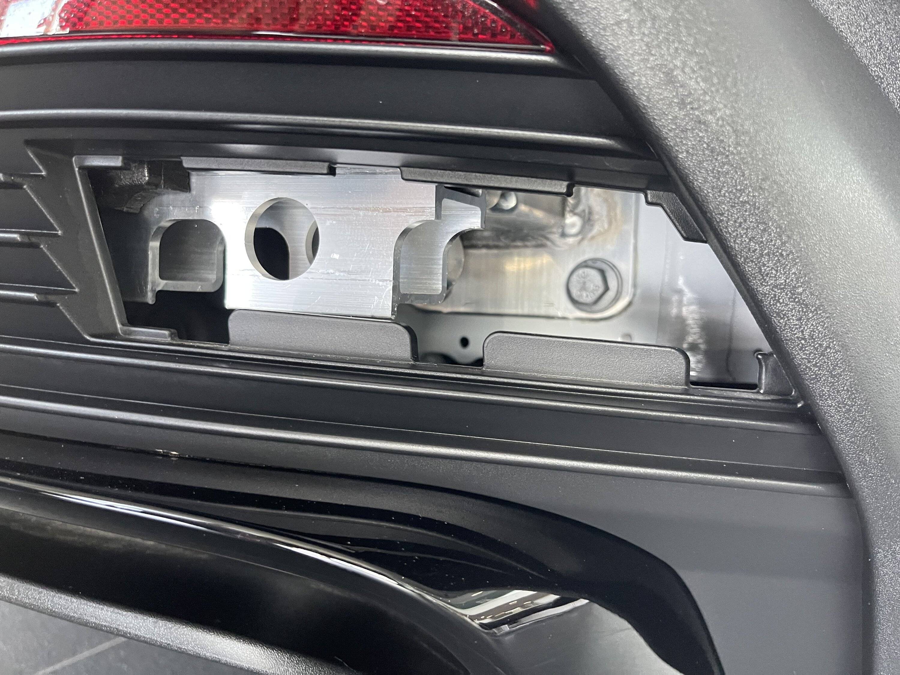

hi all - i visited my local dealer a few months back when they had a unicorn, i mean GTS ST on the floor. it only had the tow hook hatch on the rear right side, and the CT they had on the floor had hatches and pin/sleeve adapters for the bike rack. my SA did some research and concluded that the NG1 prep required is not offered on the north america builds of ST, at least for now. the tequipment compatibility page also reflects that.
i'm really hoping it changes in the future, my order was pushed to 2023 at best, but i dont love the roof rails look and i have a few ebikes which are quite heavy.
given the diffuser details, it seems like the split lines/patterns dont line up. i.e. the bike rack needs a bigger cutout. the standard sedan/ST is 3 out of 5 ribs tall, whereas the CT is 6 ribs, albeit a different design and thinner.
ST bumper hatch:
Porsche Taycan Rear bicycle carrier apparently not available for ST IMG_1570
CT showing both tow hook and bike rack mount
Porsche Taycan Rear bicycle carrier apparently not available for ST 29c646e0-df51-441f-ad73-edc7e6e3ef90-
if any any european ST owners could snap some pics it would be greatly appreciated!

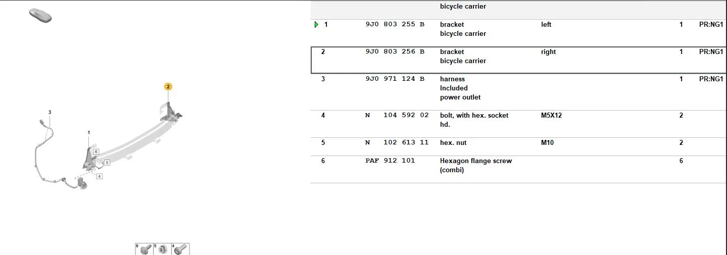

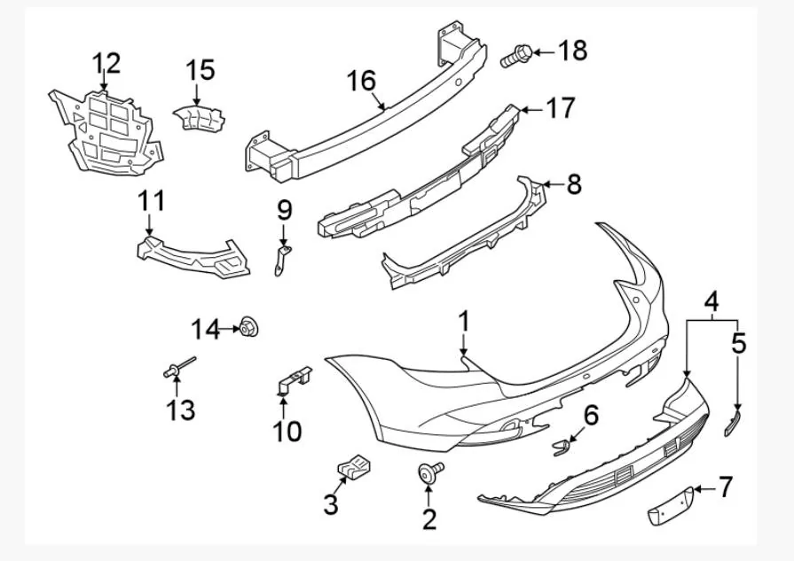

I looked in to this a while back. Should be a straightforward swap on to sedan and ST that doesn’t have the covers and receiver brackets.
Only the lower black plastic needs to be replaced and it’s a fairly cheap part #4 below.
Porsche Taycan Rear bicycle carrier apparently not available for ST D3CB072F-1FDC-4ED9-94D3-C3964D787A4D
https://www.porscheatlantaperimeter...-DESIGN-Bumper-Cover/16126032/9J1807875L.html
Was not able to confirm the brackets online but probably a dealer could look them up. They would replace #9 in the drawing above, I think.
