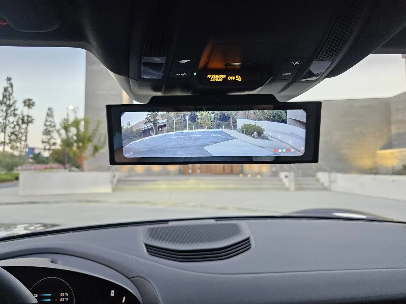

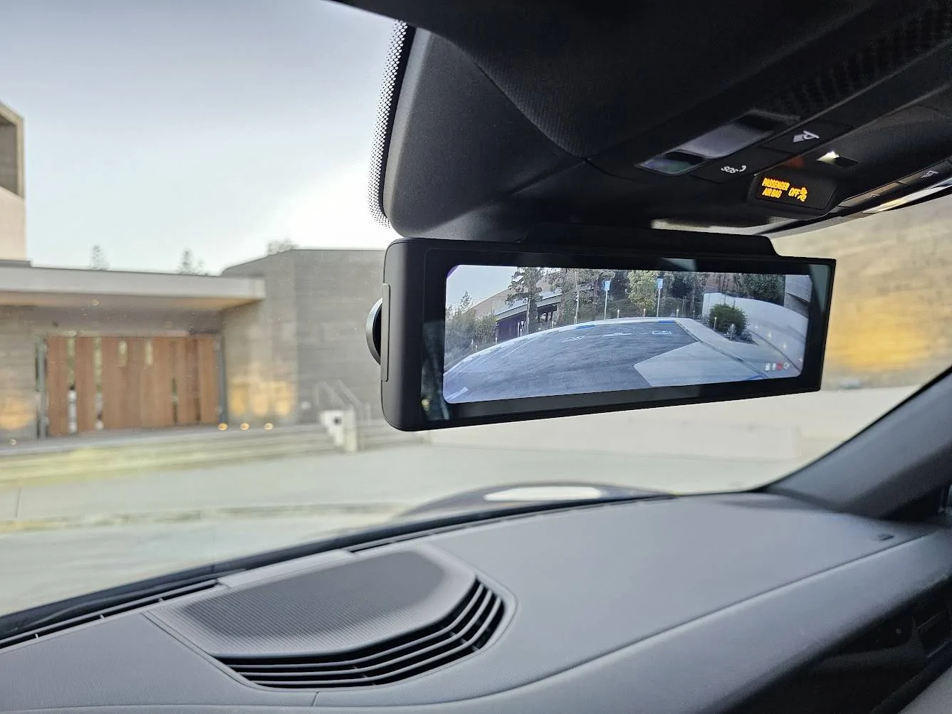

Got my car this weekend. Feel very uneasy driving without a dash cam so it's always the first thing I put in all my cars. Been using this rear view mirror type for my last 3 cars as they all have poor rear visibility. This gives clear an unobstructed view behind the car and can auto lower the view to see bottom portion when backing up if you wire its reverse signal wire to the reverse light. Quality is much better than stock backup camera. I can't believe Porsche put such a horrible quality backup camera on this car.
Front records in 4K and rear in 1080P. Bitrate is 25Mbps for front and 10Mbps for rear. File size is roughly 270MB per minute. It will turn on with the car and turns off with the car. I used the 12v cigarette socket in the center arm rest. That port stays on 15-20min after the car turns off so it will keep recording for that long. Not ideal but I don't want to use fuse tap for this as I want a quick process to remove it for when bring the car in for service. Is it needed? Any advice on this?

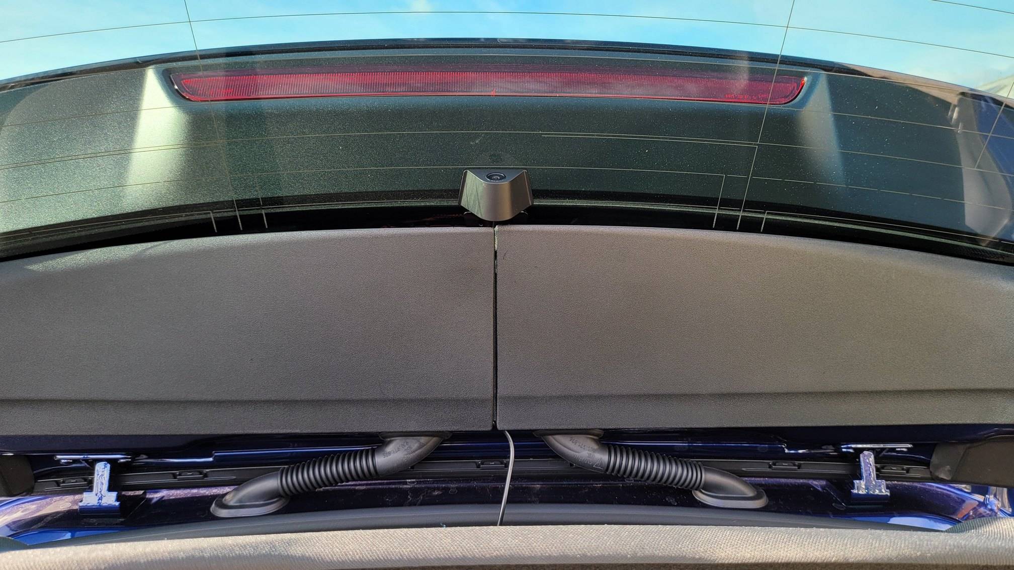

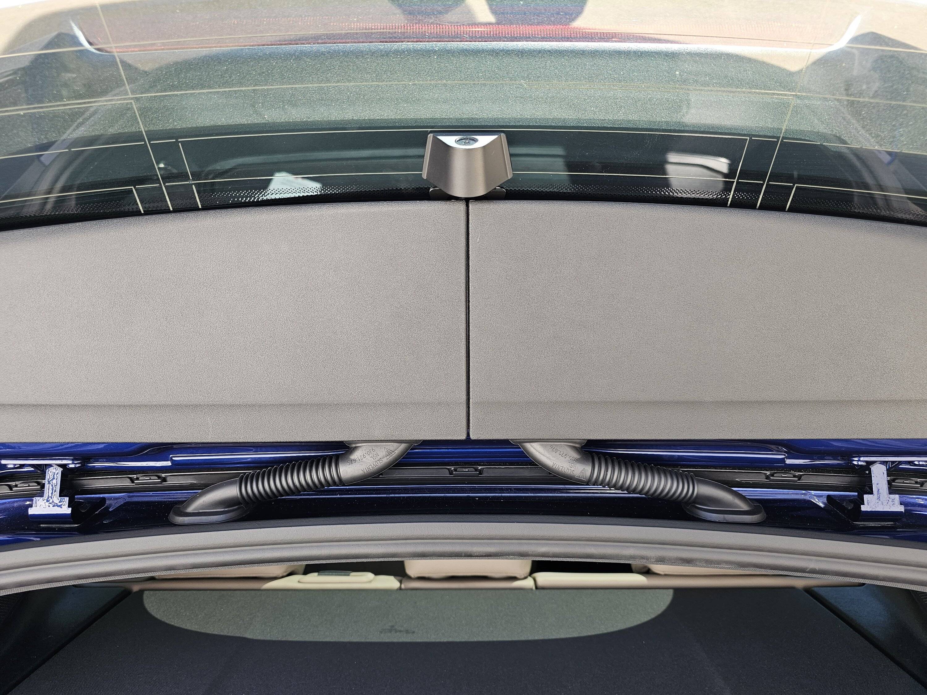

I ran the wire through the rubber seal around the A pillar then along the edge of the headliner all the way to the back. Hardest part is feeding it through the rubber conduit on the hatch and the headliner. You don't have to use the rubber conduit if you don't mind seeing the cable going across from the headliner to the camera. Here's before and after feeding it through the rubber conduit.
I have a CT so the rubber conduit might be at a different location on a sedan.

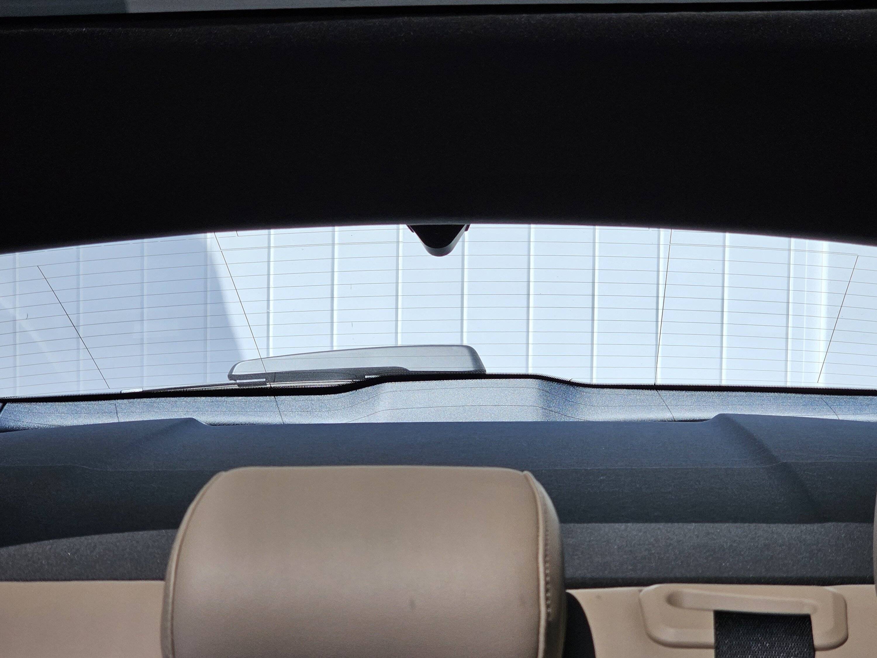

I know it lacks depth perception viewing a screen but even with a mirror, it doesn't help much viewing through the car's tiny rear window. With the screen, at least the view is not obstructed and is very wide. I can see cars across 3 lanes behind me and they can be as close as 1ft and I can still see them. Very helpful with the massive blind spot on the rear pillars.
