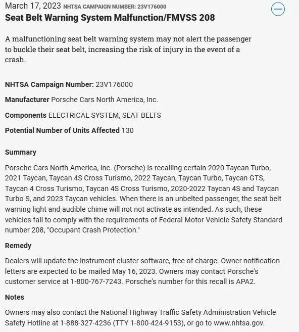

I remember there being a recall on my 2021, something to do with rear seat seatbelt harness issues.

Anyone know why only certain models from particular years are included, rather than all?
MY2020 - only Taycan Turbo
MY2021 - base Taycan and 4S CT
MY2022 - base Taycan, Turbo, GTS, 4 CT, 4S CT
MY2023 - only base Taycan
It seems like a random selection of trims. Is this a manufacturing deficiency, i.e. certain batches were using defective pars or procedures, but if so, is the remedy - new IC software - just a workaround? Or did they load different IC software for different trims, and for example 2020 Turbo had the bug, 2021 Turbo did not, 2022 got the same bug again (software regression?) , 2023 did not. Or does the recall apply only to trims from which there were complaints? I'm curious how something like this happens.
