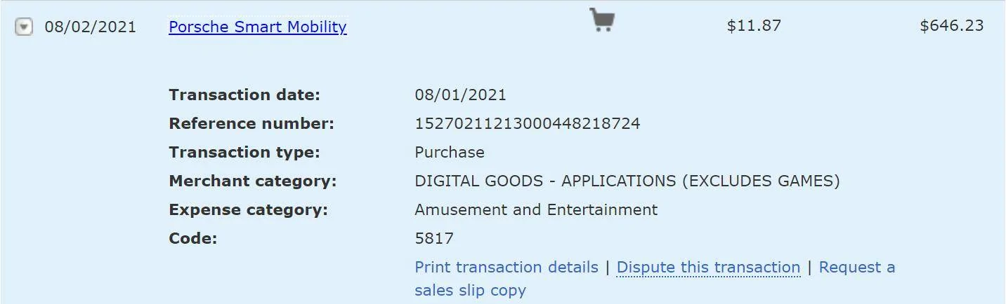

I got hit with an $11.87 charge on my business credit card from Porsche Smart Mobility:
Porsche Taycan Received a credit card charge for Porsche Smart Mobility. What is that? Screen Shot 2021-08-07 at 2.44.02 PM
Any idea what this is? It's not Porsche Connect. I opted out of that and never used it.
Coincidentally, I did receive an invoice for Porsche Connect by email for $0.00. Since the total was zero, I just ignored it. Could this be related?
I've never knowingly downloaded anything OTA. It's definitely not a charge from my dealer. I haven't been in to see them for a while. It's not a bill for charging the battery (e.g. EVGo); Those go to a different card.
Interestingly, as you can see, it's categorized as "digital goods" and "amusement and entertainment."
I'm probably going to click the "dispute this transaction" link on this one but figured I'd check to see if it's something legitimate.

I got one too for $0.15 and was initially concerned, but it's just the EA overcharges and/or Porsche Connect charges.
You're absolutely right! Thanks for suggesting this. I checked my Charging app and sure enough, some of my sessions generated an expense.
Porsche had better stop categorizing these expenses as "Amusement and Entertainment" or "Digital Apps" or people are going to start disputing the credit card charges. I almost did. Even my Porsche rep recommended that I dispute the charge after showing him the screenshot above.
For some reason, I thought all of these EA charges were free unless you're still hooked up to the charger while it's not charging (i.e. "idle fees"). Turns out they've got this odd system where they charge by the minute, rather than by the kwh, and only the first thirty minutes are free.
So if I understand correctly, in order to fully charge the battery, you have to charge for thirty minutes, manually kill the session, then start a second session until you hit 100%? Odd system, but whatever...
