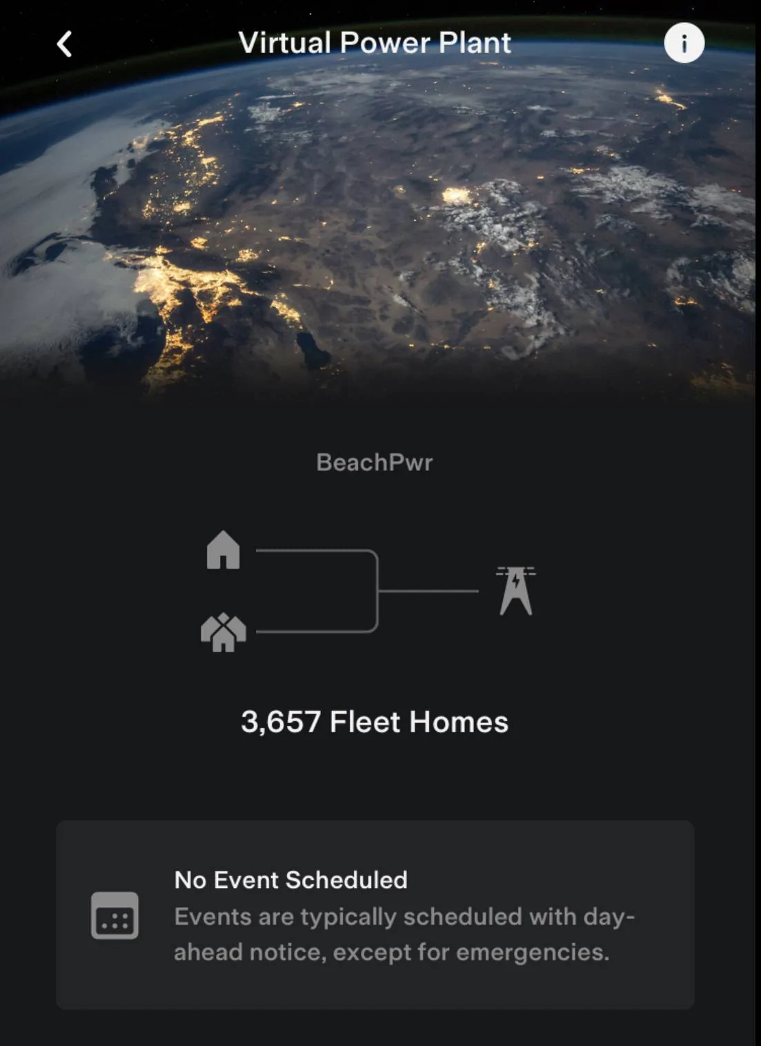

my home powerwall system was "allowed" to provide power to the grid for 3-4 hours every day for the past 8+ days - I've been delivering 18-24 kWh from my powerwalls each day during peak loads - Tesla claims I'm getting $2/kwh for the peak-grid events - I'll believe it when I see it...but between solar and my local batteries my home was net-positive impact to the grid - since the batteries both covered my usage and provided an additional 6 kW to the grid for the 3-4 hours of "peak demand".
normally I'm only allowed to send actual honest to good solar power to the grid - so I can send the grid any 'excess' solar at the moment - but can't send "stored" power to the grid - I can only use my batteries to power my home usage - the don't want me charging my batteries from the grid during low cost TOU and then selling their power back to them later at higher TOU prices
but during "grid emergencies" I'm allowed to send "stored power" to the grid but no more than my solar system would normally produce - my solar system max output is 6 kW - so I'm allowed to send 6 kW of battery power to the grid during grid-emergencies...
or 6 kWh per hour of stored capacity.
tesla calls this a vritual powerplant - and they used it 8+ times these past few days - during peak load the virtual powerplant was collectively producing 3-6 megawatts - it was interesting to watch and the Tesla app showed in real time the "output" of the virtual power plant "fleet" - ~3500 other Tesla victims were participating in providing power from their batteries to the grid.
