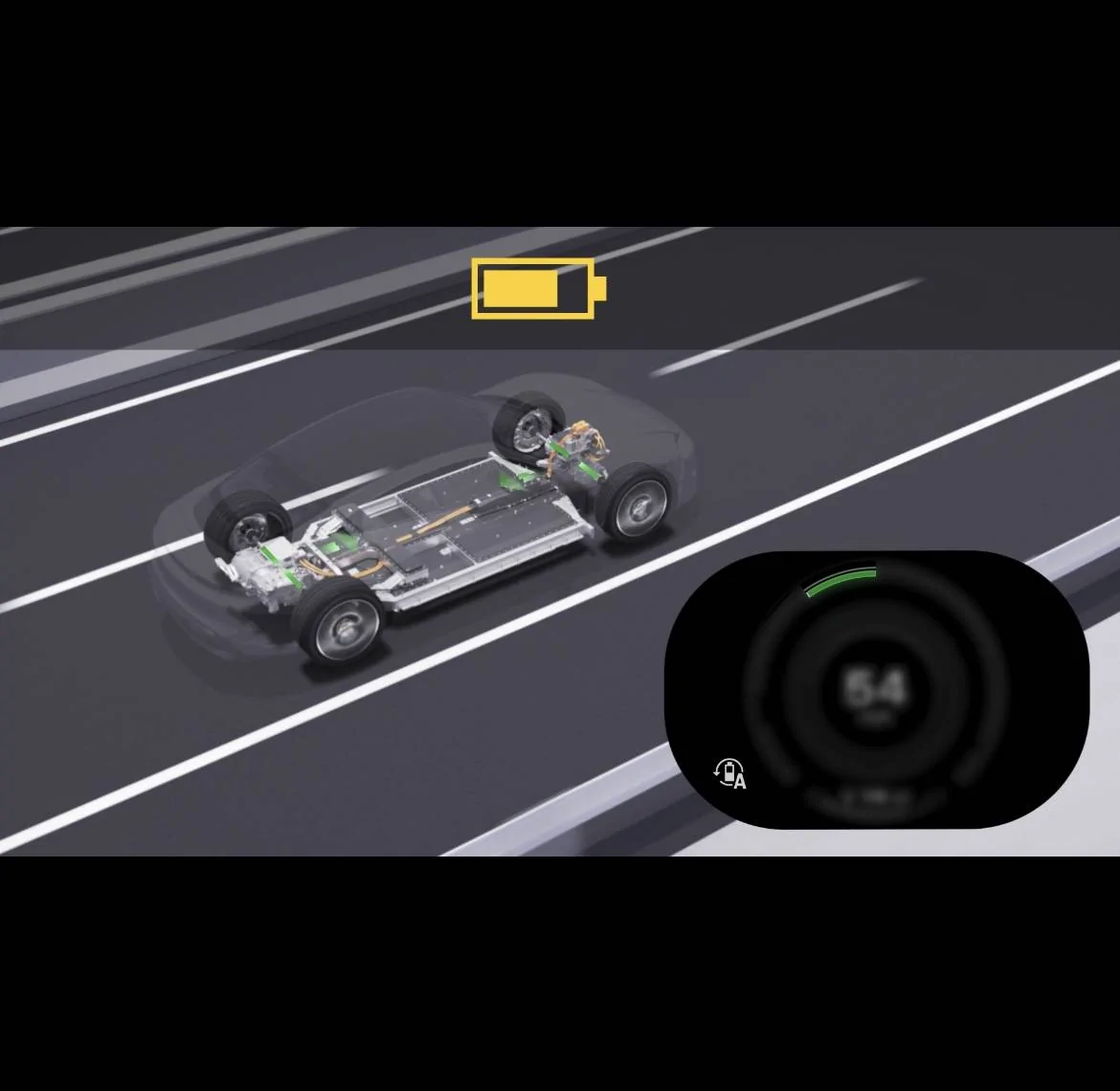

Didn’t know what meter you were referring to since I keep my dash middle screen as map but I found this in the manual that shows the green recup graphic.
Porsche Taycan Recuperation 870B6933-E435-4FE2-9E52-074ACF255A96
Jhenson29
Jeremy
Feb 9, 2021
2,805
4,191
St. Louis, MO
Yes, that one. I alway have the power and recup meter up.
