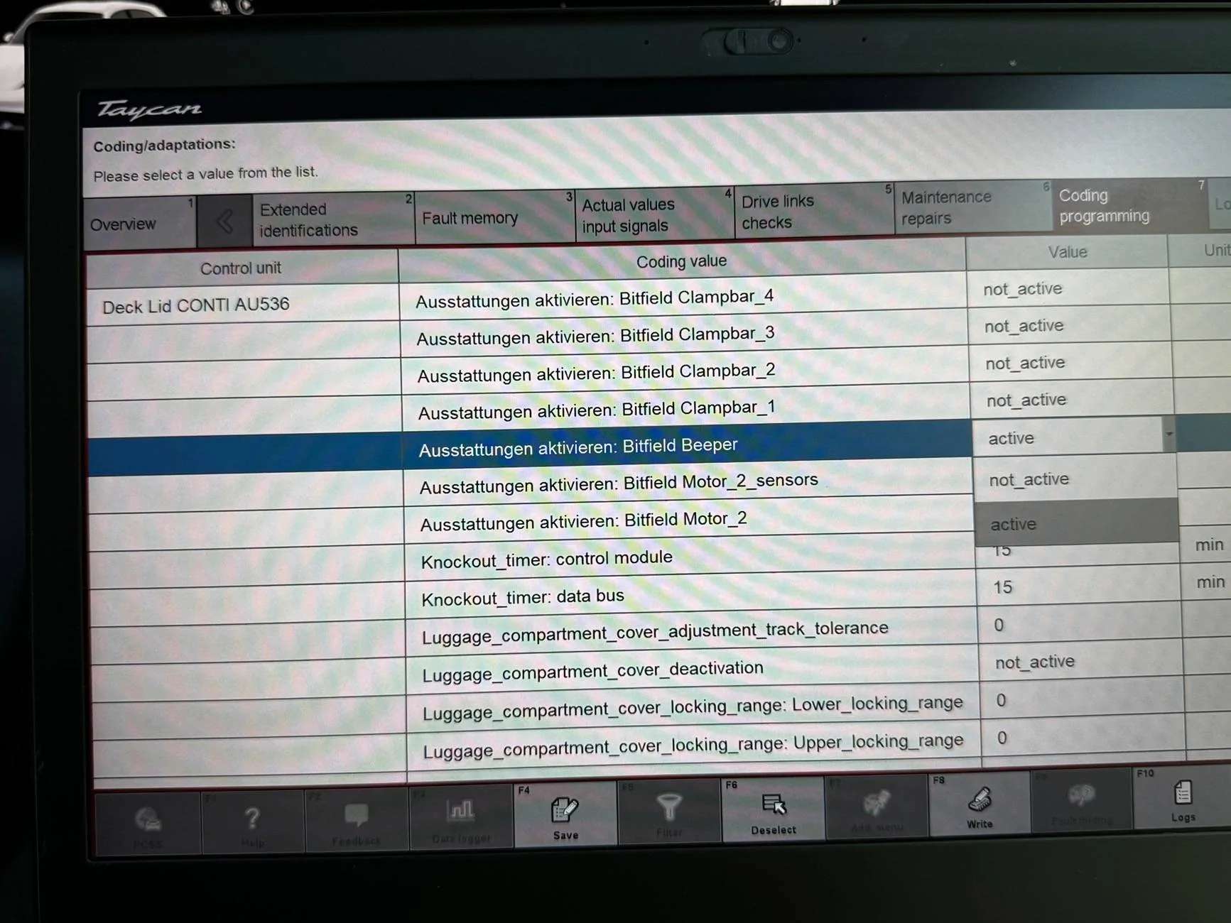

Were you in the (German-language only) developer mode? BTW that's where my German-fluent mechanic found the setting to disable the trunk close beeper.
any chance you can find out from him what the coding for that is called? i've dug around but its miserable to do with a translator
