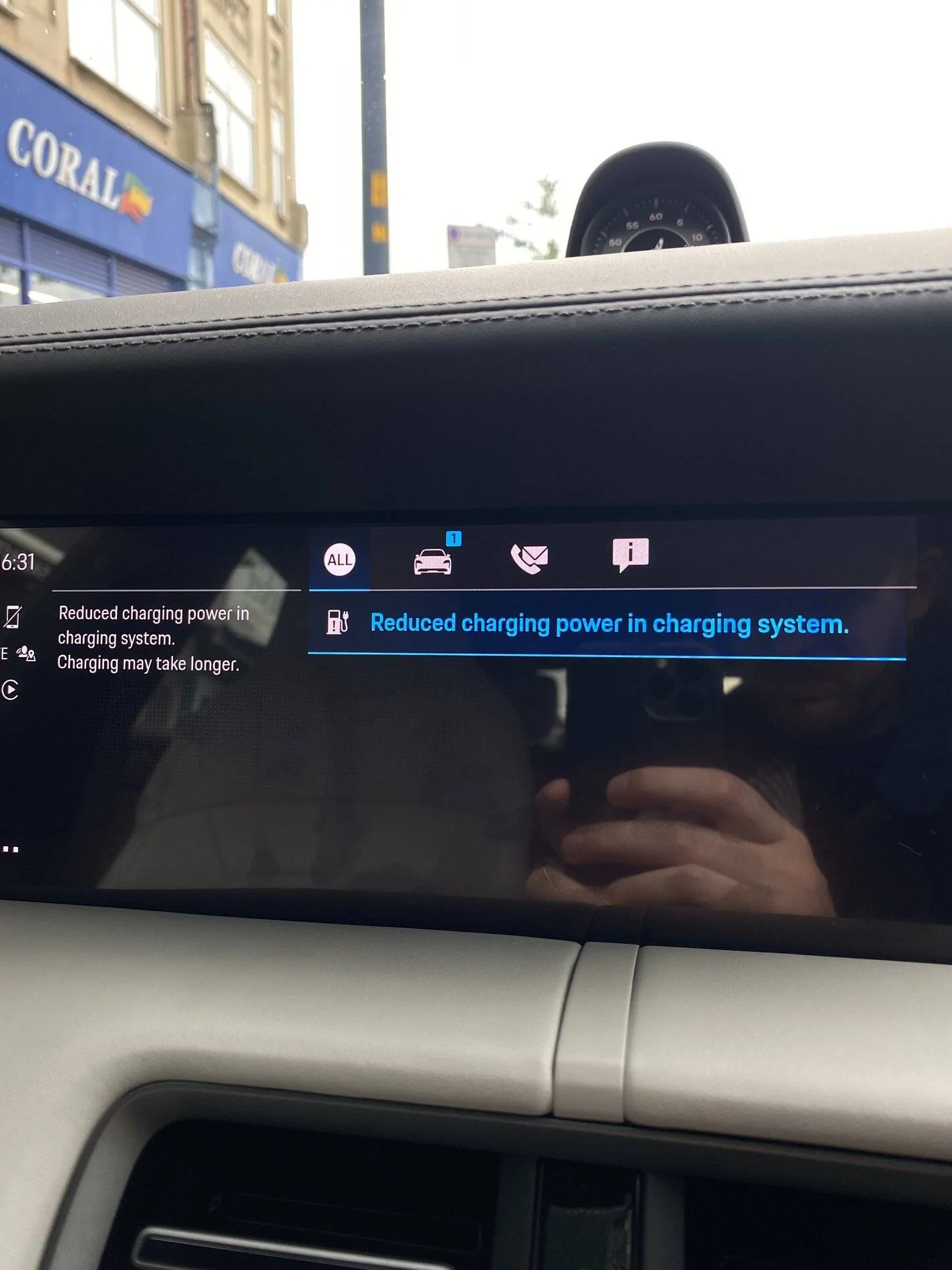

Has anyone seen this alert before / know what it means?
I keep getting it and very slow charge (around 50% of charging station capacity) at various charging stations.
Battery is always warmed (between 26-31 degrees Celsius)
I have not gotten that warning. But on my home charging system I have lost charging power after about five minutes. Car is now at the dealership service department to figure out what is going on
